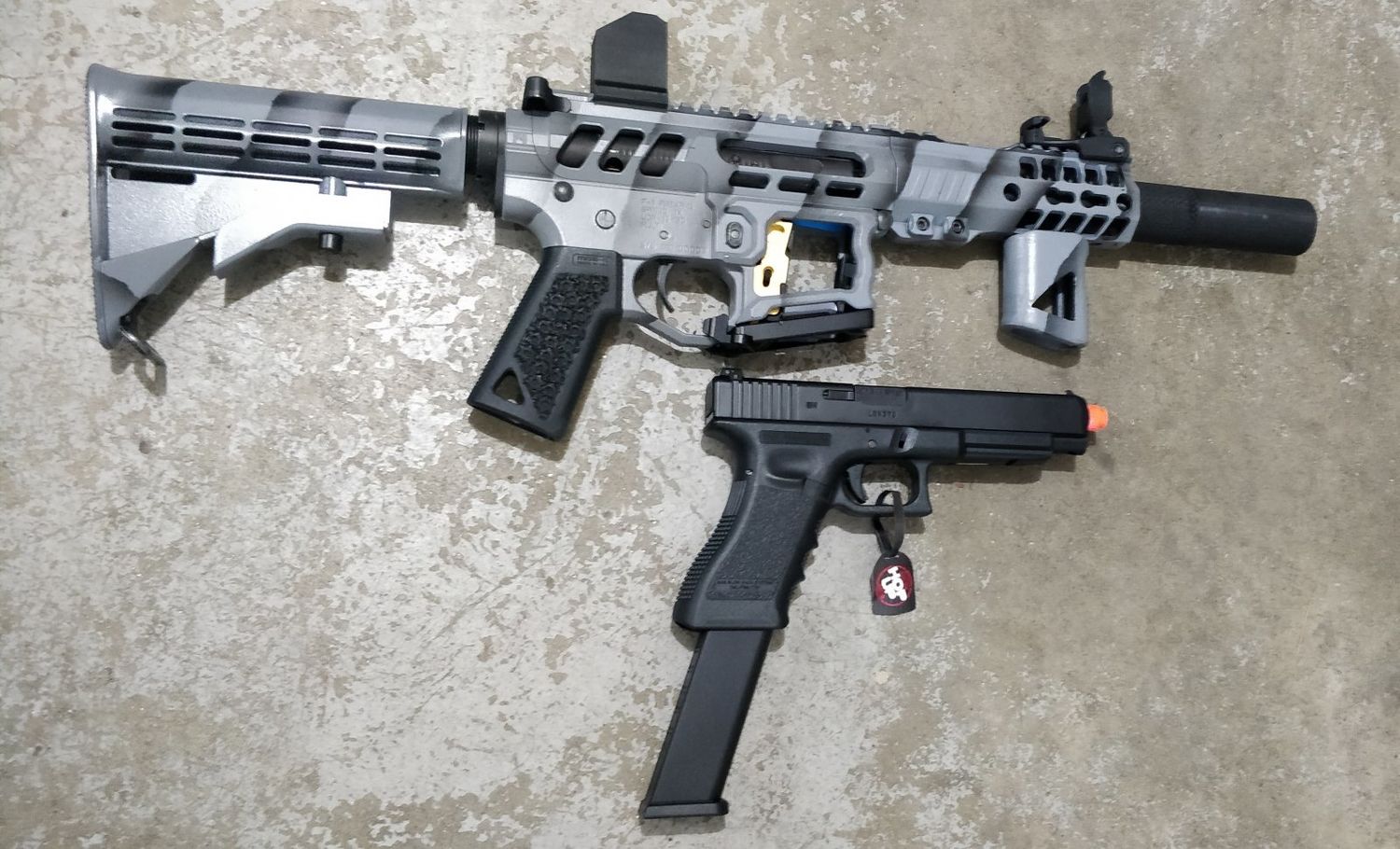

adas1223 Posted May 16, 2020 Share Posted May 16, 2020 quaratine purchases came in. nice. Hypnosis and GeorgePlaysAirsoft 2 Link to comment Share on other sites More sharing options...
Davegolf Posted May 16, 2020 Share Posted May 16, 2020 That MWS is a long way from home! Hows it perform? Mag capacity vs gas capacity? Genuinely though someone had posted in the wrong thread at first! 😂 Link to comment Share on other sites More sharing options...

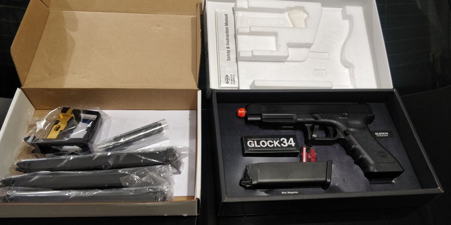

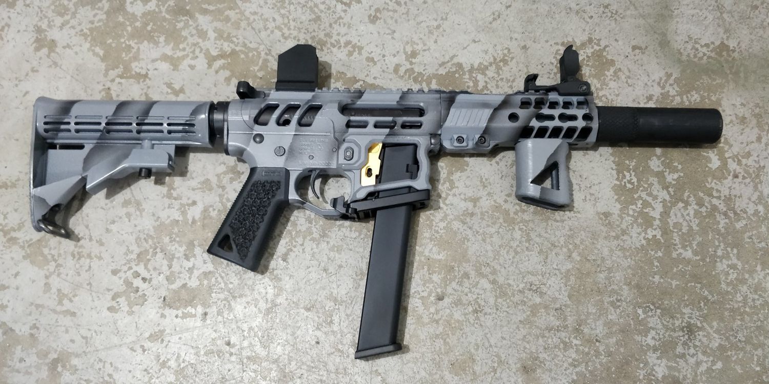

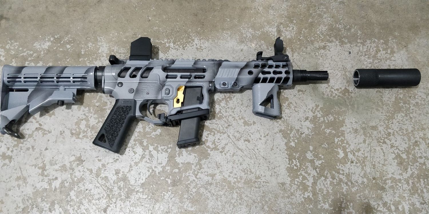

adas1223 Posted May 17, 2020 Share Posted May 17, 2020 7 hours ago, Davegolf said: That MWS is a long way from home! Hows it perform? Mag capacity vs gas capacity? Genuinely though someone had posted in the wrong thread at first! 😂 Its actually my beater mws lol. I have a fully stock one which is my baby. those are also just mock up photos. the kit does involve some modifications sadly... oh well. just finished transplanting the glock nozzle in the BCG. im missing the bolt catch right now and i dont want to fire too much without it. I test fired some shots making sure the follower doesnt pop up the catch lever. threw the bbs just as hard as an MWS mag. interestingly too, the adapter+magazine weigh less than a MWS magazine. Also, Im running a stock BCG so shot count should be up there. Link to comment Share on other sites More sharing options...
