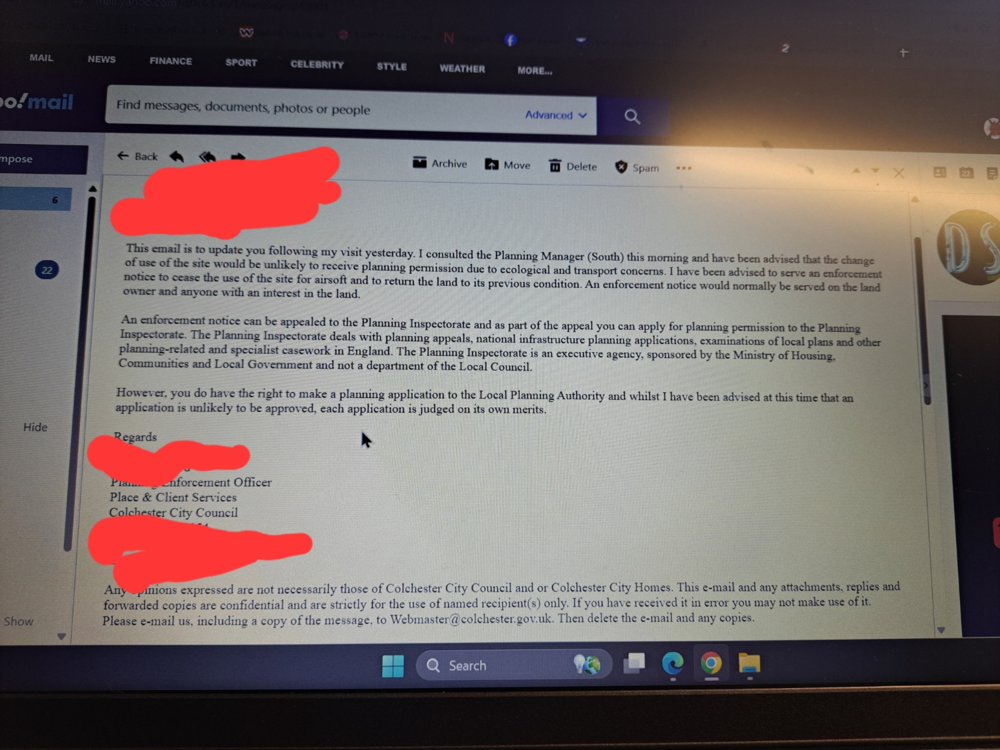

mrfoxhound Posted March 28 Posted March 28 1 minute ago, Lozart said: Source? thats a direct email they received from the council

The_Lord_Poncho Posted March 28 Posted March 28 Looks like a simple case of falling foul of needing planning permission because the site structures fall outside of Permitted Development constraints. Seeking (retrospective) planning permission would then mean that the full use of the site is subject to consent, including traffic/transport considerations, and environmental aspects as well. To be honest, with good consultants I’m sure these concerns can be adequately rebutted, but that all costs money. I have to say, petitions in situations like this are somewhat pointless. Well thought out and logical letters written to local councillors (especially those on the planning committee) would likely be more beneficial. Pseudotectonic, Cannonfodder and mrfoxhound 3

mrfoxhound Posted March 28 Posted March 28 (edited) 1 hour ago, Cannonfodder said: In in two minds about this. On one hand a site closing is always bad, but if they've either ignored or didn't think planning laws applied then that's on them. How long has the site been open? one game, there trying to use the 28 day rule to not get planning permission and calming skirmish team game is not a ''war game'' ,which you cant use the 28 day rule if you are doing ''war games'' Edited March 28 by mrfoxhound Pseudotectonic, Rogerborg and Cannonfodder 3

Colin Allen Posted March 29 Posted March 29 17 minutes ago, Austeyr said: Has been for years tbh. They get outdoor sites up and running, trash the land or have the farm life harmed (One of their sites was a working farm and a player thought it would be hilarious to shoot a pig?) then get kicked out. They went into “liquidation” a while back and then was miraculously bought out the next day but kept the same trading name ? The same area they were using allegedly had an application for axe throwing denied a few months prior. Seems to be a case of trying to avoid the legalities, getting caught out and their players kicking up a huff. I doubt a petition will sway the local council A petition will have no impact whatever. Once an enforcement notice has been issued, the only route for an appeal is via the Planning Inspectorate, which is a national level body. A company that I used to be involved with went through that route a few years ago. Rogerborg and Austeyr 2

mrfoxhound Posted March 29 Posted March 29 some screens the local mp they went to on facebook they ask for help from replyed with this
Pseudotectonic Posted March 31 Posted March 31 https://www.legislation.gov.uk/uksi/2015/596/schedule/2/part/4 "Any war game" is specifically not permitted in an SSSI. "War game" is defined as: Quote “war game” means an enacted, mock or imaginary battle conducted with weapons which are designed not to injure (including smoke bombs, or guns or grenades which fire or spray paint or are otherwise used to mark other participants), but excludes military activities or training exercises organised by or with the authority of the Secretary of State for Defence. Which to be fair, airsoft falls well within this definition. Airsoft is imaginary battle Airsoft weapons are designed not to injure Therefore, law is the law: no airsoft in an SSSI. The law says so. PS in the context of Class B – temporary use of land Had it not been an SSSI, it would be a different story. But the site is an SSSI. Rogerborg 1
