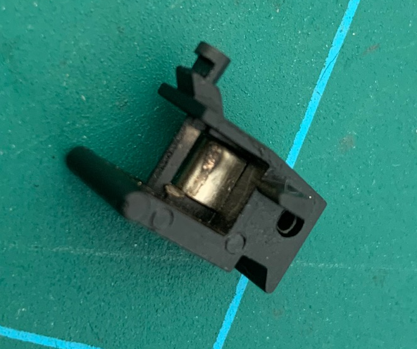

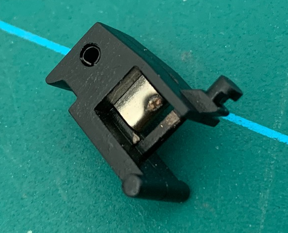

Except when the trigger switch assembly is proprietary and nowhere in the UK stocks them.....I've just found that one out the hard way....?
Sooo...a cheap (non-AB) mosfet will be going into my particular gun, just so I don't have to order replacement trigger contacts from the US or HK later on.
Oh - this is after 30mins of gameplay on an 11.1v LiPo with said gun:
image.png.371a2ae5836cdacb53760a8fdc603b92.pngimage.png.80fea32b16260f578e51a75beab1a95d.png

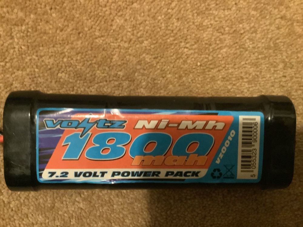

10 minutes ago, bitofanidiot42 said:
So 7.2 Nimh would give lower fps than a 7.2 lipo?
Nope,  think what the motor is doing.  Its pulling back a piston against a spring until it releases at a certain point.
If it does it quickly or slowly doesn't matter much as it will release at the same point so the BB will be pushed with the same amount of air.
The only thing that will change is the time to next shot as the system cycles faster with more juice.
The 7.2v NiMh may struggle to actually pull the piston back against the spring so much more likely to get a locked gearbox where its partially pulled back but doesn't have enough juice to finish the cycle. Major pain...
Li-Po's have more current so even though its 7.4v it still has more power.  Think of it like a garden hose.  The voltage is the diameter of the pipe and the current is the water pressure.
