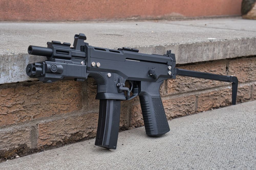

Why hello there. Some of you may have known that I’ve been developing this thing for the past year. It has gone through one test phase, and now it is time for the second: the beta test of the MOSQUITO kit.
So, what is this thing you may be wondering? Well, (doing a ctrl+c and ctrl+v of myself….):

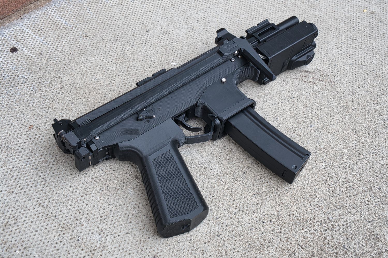

“Inspired by the PP-91 KEDR, the MOSQUITO is an ultra compact, lightweight, and modular kit for an AK AEG. A fully assembled kit weighs only around 1.4kg, and has a max length of 577mm with stock unfolded (341mm folded). Disassembly is made easy via stainless steel pins, and hop up can be adjusted on the fly. Want to experience a true small form factor with a big punch? This could be the thing for you.”
Essentially, it is a 3D printed kit that takes parts from a traditional AK AEG and turns into a super lightweight, compact, and easy to use weapon. Actually, to be more accurate, it only takes the gearbox, hop unit, and barrel. You don’t even need any of the fiddly external parts on the gearbox because I have completely redesigned them. It also takes regular mp5 magazines which are plentiful.
So, what I need now are testers who will provide good feedback on the kit as it is right now. I have plans to improve it even further before putting it up commercially, but I will need user feedback first to determine viability.

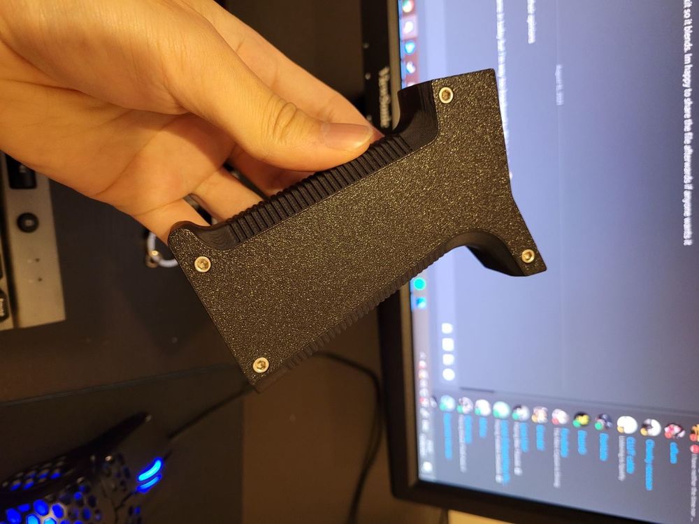

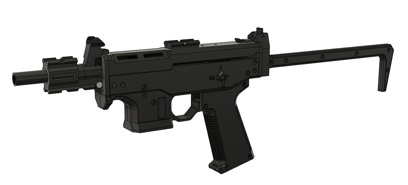

During the time of the test, I have further iterated a superior version of it with textured sides:
Which looks like this:
