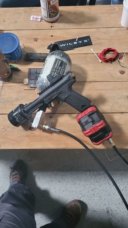

I have a daft question to ask here.... how do you know what PSI you're getting? Unless you're HPA'ing (is that even a word?) the pistol I hazard to guess?
Primary Glock>M4 HPA adapter arrived earlier today. 80psi is about that of the weaker duster gas, 110psi is touted as green gas but as our climate is fairly cold we rarely see above 90psi from our green.

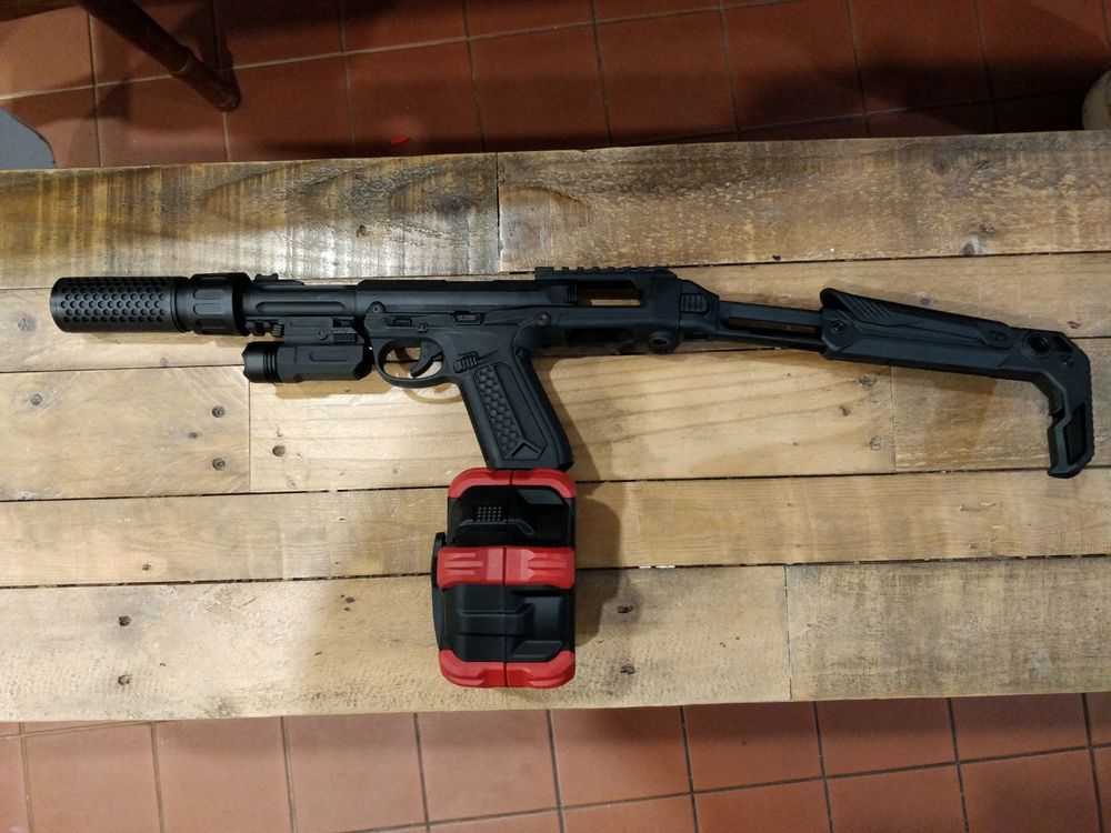

Well look what I collected today!
Just had a quick test fire. 1 full gas fill on nuprol green that's been kept near the tumble dryer has chucked 1.5 drums worth of BB's so far I reckon. A mixture of semi and full auto firing.
It's a weighty beast but with the stock on and holding my left hand around the torch it feels well supported and near enough centred.
I'll hopefully have a play in the day time and record some footage after I've taken the kids to school this week!
Now this is looking pucker! The post-mid-life-crisis part of me is liking this!! I wonder if they make that stock extension in FDE otherwise it will be Krylon.. (meh).

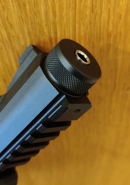

PDI barrel arrived this morning. What a beauty she is as well! Even has the oring at the end to ensire it's centered correctly and ideal length of 129mm. Strange how the ZCI was only 1mm longer but seemed to sit so much further forward. Anyway, installed it this evening and couldn't help but do a quick test fire. Again at 80psi I was getting roughly 300fps with a 0.25 which is about perfect for what I want.

I assume the barrel doesn’t stick out of the front end right? I mean protruding more than the outer barrel. Oh you all know what I mean lol
Correct. Stock barrel is 129mm from what I can find and PDI have copied this, you can get away with a 130mm but I wouldn't want anything more without a suppressor or tracer.
I'd be interested to hear how much difference in accuracy of groupings the PDI barrel makes over the stock barrel... I appreciate it's a pistol and not an AEG length barrel and in addition I guess you need to have an appropriate distance to test over say 30m-40m? I mean what's the general expectation of this pistol? It's not gonna be MK23 type level but would still be interesting to know what to expect....
Have a look at my earlier pictures. This has the PDI MK23 barrel which is 133mm long. Without the compensator on the Mamba upper or the thread protector on the standard receiver you can just see the end. With the mamba compensator it is fine. With the thread protector only it protrudes about 1mm.
