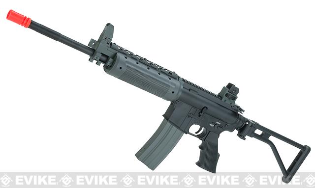

Iceni Posted May 18, 2018 Posted May 18, 2018 15 minutes ago, AK47frizzle said: I'd imagine m4s would have handguard or stock space My M4 is a prime example of a massive front handguard. You can fit an absolute whale of a battery in there. The 9.6 nunchucks go in with room to spare. Added to that I got rid of the wire stock and run it with an AR style solid stock (one of the old style ones that have full capacity) I have been tempted many times to get a 4500+Mah battery for it. Probably one of these if I do it.https://www.componentshop.co.uk/11-1v-4500mah-65c-continuous-discharge-hardcase-lipo-battery.html One day I'll actually finish rebuilding it!
Supporters Sitting Duck Posted May 18, 2018 Supporters Posted May 18, 2018 36 minutes ago, Iceni said: My M4 is a prime example of a massive front handguard. You can fit an absolute whale of a battery in there. The 9.6 nunchucks go in with room to spare...... Yeah - hold my beer/charger.......
