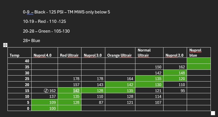

OREVREV Posted February 20 Posted February 20 @zizivertHere is a crude chart I made to work out what gas I want to use on a game day if useful, I'll always use ultair over nuprol due to the silcon but tbh I've not had issues with either and not noticed any effects. I always try to be around 125 but I've run anywhere from 100-140 ish no issues. lokkers, SSPKali, Mr Dellski and 1 other 4
