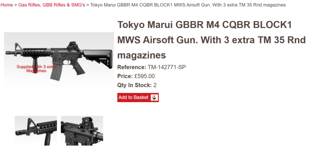

iNoobster Posted April 21, 2024 Share Posted April 21, 2024 Huge list, i tried reading through. I am planning on getting this with 3 extra mags. Can someone point me to a better deal? I really wanted the MK18 but thats super expensive. Also worried that it says you will get type89 mags or MWS mags? Also if you want to point me in the right direction in what to buy to get the MK18 look and some good to have upgrades, please pop some links below ❤️ Thanks. Link to comment Share on other sites More sharing options...
zizivert Posted April 21, 2024 Share Posted April 21, 2024 During my research I found this in french thread: Petit retour après avoir testé des chargeurs type 89 dans ma MWS: parfaitement compatibles. Ils sont quasi identiques en dehors des marquages de munitions et d’une couleur plus sombre que le gris d’origine. Le poids et les performances sont les mêmes également. Et ils ont l’avantage d’être en stock chez AE! In english and in short, TM mag type89 are compatible with our Mws. Link to comment Share on other sites More sharing options...

Madhouse Posted April 26, 2024 Share Posted April 26, 2024 On 21/04/2024 at 21:03, iNoobster said: I really wanted the MK18 but thats super expensive. Also worried that it says you will get type89 mags or MWS mags? Also if you want to point me in the right direction in what to buy to get the MK18 look and some good to have upgrades, please pop some links below ❤️ Thanks. I got my MK18 from Fire Support. I seem to remember Surplus Store being reasonable but the deal with three extra mags is a good one. I contacted FS about mags at the time and they confirmed the only difference between M4 and Type 89 MWS mags is the look. I got extra mags on eBay of all places, mainly because I prefer the look of the M4 mag. If you're looking to turn your M4A1 into a MK18 then there are some posts in this thread that would be worth you finding, although if you're planning to buy the stuff straight away you may find it more cost effective to just get a MK18 .... which is out of stock by the look of it. Fire Support's stock alerts are pretty timely though, that's how I landed mine. Link to comment Share on other sites More sharing options...
