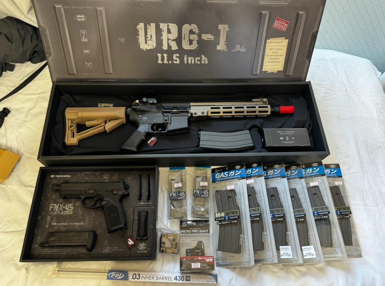

Popular Post Lyxis Posted November 26, 2023 Popular Post Posted November 26, 2023 (edited) Holy sh- hey everyone I’ve been reading this thread for way too long time, and now it’s my time to join the MWS family Finally got my hands on one I’m more than ready to run this boi on the field I got the URGI version of the MWS, I don’t remember when it came out, but in France seems like it’s almost impossible to get hands on it Im looking for some advices on what simple things to add on it i already got some parts up for it Got 5 spare mags (the sixth one is for a friend) (also don’t mind the inner barrel, it’s for my SRS) if you have any idea on what I should add, feel free to express yourself, I’ll take any suggestions thank you ! Edited November 26, 2023 by Lyxis Jacob Wright, GothicGhost, C-Diddy and 2 others 3 2
C-Diddy Posted November 26, 2023 Posted November 26, 2023 Internally, just a new hop-up nub to lift heavier ammo. SixG brass nub, BavTac MHN and Jaeger Titan nub are all decent in my experience. Externally, just go with what you like. Loads of people (myself included) went for the URG-I look, but you've completed it, so accessorise as you see fit. Guns Modify P-mags are also decent if you want that look.

Lyxis Posted November 26, 2023 Posted November 26, 2023 (edited) 4 hours ago, Wavey_Gravey said: Add on externally or internally? Mostly externally I already got a Layla’s hop up arm, a Modify beige bucking (X-range 55 degree are out of stock everywhere for me) and a PDI barrel 3 hours ago, C-Diddy said: Internally, just a new hop-up nub to lift heavier ammo. SixG brass nub, BavTac MHN and Jaeger Titan nub are all decent in my experience. Externally, just go with what you like. Loads of people (myself included) went for the URG-I look, but you've completed it, so accessorise as you see fit. Guns Modify P-mags are also decent if you want that look. I went looking in every Japan store, impossible to find any P-mag sadly ?? I also bought a Surefire style suppressor from Airsoft Artisan got some ambi selector and mag release Didn’t installed all those for the moment, the rifle is in the case waiting to come back to France maybe if anyone knows a good sling mount for the handguard, and a ref for a decent (but not 200€) ngal replica maybe I also happen to have an Odin Speedloader I cant seem to find any adapter online available for MWS, but I’m sure I’ve seen some does one know if it’s something I can buy ? Edited November 26, 2023 by Lyxis
Wavey_Gravey Posted November 26, 2023 Posted November 26, 2023 Totally depends on what kind of look your going for, I’d change the pistol grip for sure then just accessorise it how you see fit. If your going for a unit impression then you can just ‘clone’ the items used, if not then the world of accessories is your oyster!
C-Diddy Posted November 26, 2023 Posted November 26, 2023 1 hour ago, Lyxis said: I went looking in every Japan store, impossible to find any P-mag sadly ?? maybe if anyone knows a good sling mount for the handguard, and a ref for a decent (but not 200€) ngal replica maybe I also happen to have an Odin Speedloader I cant seem to find any adapter online available for MWS, but I’m sure I’ve seen some does one know if it’s something I can buy ? For P-mags, try WGC Shop or JK Army. If the TM handguard has a QD point, just get a decent QD attachment (Magpul, BFG etc), if not, a Magpul M-LOK mount will sort you out. I have a WADSN Ngal clone that's decent enough Nick G 1
