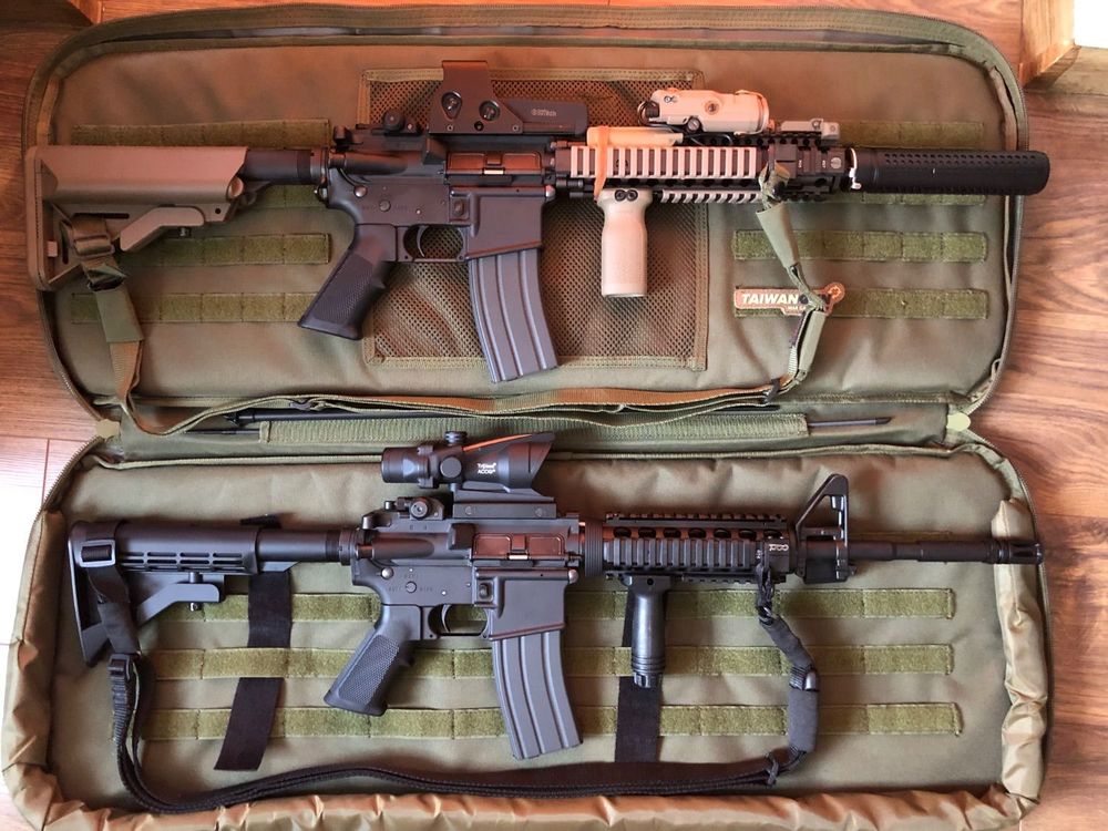

NoRo Posted June 17, 2022 Posted June 17, 2022 Hello, I have recently joined the MWS club and bought the M4A1 and the MK18. The M4 have just few mags shot and I have a serious issue with the MK18, just after 8 mags. After finishing the 8th mag on full auto, the bolt failed to return fully, looks like the nozzle tip hit the hop chamber and get deformed slightly. Ever since then, the gun gets jammed after few shots. I am using green gas and 0,25 guarder BBs. After that I tried also the high polished bio BBs, same story. I am very surprised, been using GBB from Marui for ages and never had any issues….. I am looking for a replacement nozzle but mainly the dynamic precission ones are available. Are they any good ? Below a pic of my badboys:
Davegolf Posted June 17, 2022 Posted June 17, 2022 Hi! Yes the DP and Modify nozzles work OK. Is the piston lid seal sufficiently greased?
NoRo Posted June 17, 2022 Posted June 17, 2022 You mean the lid with two screws and the tip to catch the charging handle ? Did anybody had such issue on a literally new gun ?
Davegolf Posted June 17, 2022 Posted June 17, 2022 No, if you take the nozzle out of the bolt youll see a 17mm ish diameter cup seal, if that runs dry youll get issues. Or easy diagnostic, swap the bolt between your guns and see if the problem moves to the other gun
Guest Mr. No_Face Posted June 17, 2022 Posted June 17, 2022 37 minutes ago, NoRo said: Hello, I have recently joined the MWS club and bought the M4A1 and the MK18. The M4 have just few mags shot and I have a serious issue with the MK18, just after 8 mags. After finishing the 8th mag on full auto, the bolt failed to return fully, looks like the nozzle tip hit the hop chamber and get deformed slightly. Ever since then, the gun gets jammed after few shots. I am using green gas and 0,25 guarder BBs. After that I tried also the high polished bio BBs, same story. I am very surprised, been using GBB from Marui for ages and never had any issues….. I am looking for a replacement nozzle but mainly the dynamic precission ones are available. Are they any good ? Below a pic of my badboys: loop If you're nozzle is deformed in anyway, you will not get reliable feeds (If any). I had a similar problem using mine on it's first game day. Bolt failed to return properly, followed by a series of jams. When I inspected the nozzle it was deformed and had to be replaced. I've went through 3 nozzles, under 1000 rounds and in under just 2 month's of having the rig. You're going to need to buy a few nozzles and keep them as backup because they're extremely fragile even the ones that claim to be reinforced like the DP line.

NoRo Posted June 18, 2022 Posted June 18, 2022 I have fixed the damaged nozzle tip with a sand paper to make it smooth and even and it works ok. 150 round through without a single jam. Green gas, 22*C. I am still however looking for a spare nozzle just in case. I cannot find the original Marui ones, DP are hit and miss from what I have read. What about the G&P reinforced ones ?
Davegolf Posted June 18, 2022 Posted June 18, 2022 The G&P/Modify/DP... TBH they prob all come out the same factory lets be honest SSPKali 1
