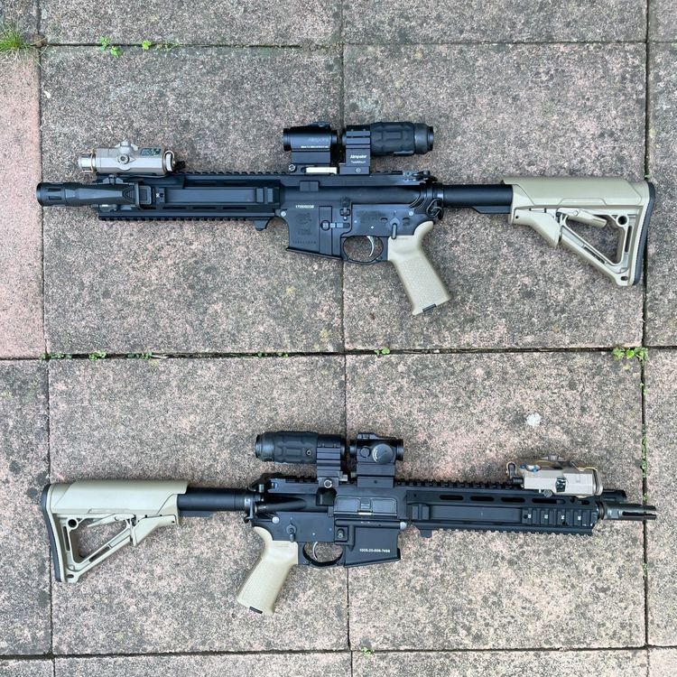

Guest Airsoft J2 Posted August 4, 2021 Share Posted August 4, 2021 There were a few requests for pics of the Hao L119A2 MWS kit. I’m getting ahead of myself because my AFG still isn’t arrived but this is the gun as it stands. My garden is too short to do anything other than basic checks but everything seems to work. With the stock bolt it’s at 0.9J (310fps on 0.2s). The Laylax strike arm seems as good as the nub was on my other MWS but hard to tell at this stage. External Parts Hao L119A2 kit for MWS Tokyo Marui M4A1 donor gun Magpul MOE Grip Magpul CTR stock Magpul ¼’” Riser Magpul AFG 2 (not pictured) Magpul MOE trigger guard Magpul ASAP plate Magpul RSA (not pictured) Aimpoint T2* Aimpoint Micro 39mm riser Aimpoint Micro LRP mount Aimpoint 3x Magnifier* Aimpoint Magnifier Twist Mount and spacer PEQ-15* WMLx Internals: Angry Gun NPAS bolt Angry Gun High Speed Buffer Angry Gun High Speed Bolt Carrier Laylax Strike Hop Arm Laylax 6.03mm inner barrel Link to comment Share on other sites More sharing options...
AlphaBear Posted August 4, 2021 Share Posted August 4, 2021 4 minutes ago, Airsoft J2 said: There were a few requests for pics of the Hao L119A2 MWS kit. I’m getting ahead of myself because my AFG still isn’t arrived but this is the gun as it stands. My garden is too short to do anything other than basic checks but everything seems to work. With the stock bolt it’s at 0.9J (310fps on 0.2s). The Laylax strike arm seems as good as the nub was on my other MWS but hard to tell at this stage. External Parts Hao L119A2 kit for MWS Tokyo Marui M4A1 donor gun Magpul MOE Grip Magpul CTR stock Magpul ¼’” Riser Magpul AFG 2 (not pictured) Magpul MOE trigger guard Magpul ASAP plate Magpul RSA (not pictured) Aimpoint T2* Aimpoint Micro 39mm riser Aimpoint Micro LRP mount Aimpoint 3x Magnifier* Aimpoint Magnifier Twist Mount and spacer PEQ-15* WMLx Internals: Angry Gun NPAS bolt Angry Gun High Speed Buffer Angry Gun High Speed Bolt Carrier Laylax Strike Hop Arm Laylax 6.03mm inner barrel You gotta love RS steel optics.... the rest of the RIF ain't too bad either I'm rolling with a UNITY Fast most at the moment. I'm actually finding it better than the 1/3 co-witness. Target acquisition is so much faster too which is a bonus, although it takes a little time getting used to your new head position. Link to comment Share on other sites More sharing options...
Guest Airsoft J2 Posted August 4, 2021 Share Posted August 4, 2021 1 hour ago, AlphaBear said: You gotta love RS steel optics.... the rest of the RIF ain't too bad either I'm rolling with a UNITY Fast most at the moment. I'm actually finding it better than the 1/3 co-witness. Target acquisition is so much faster too which is a bonus, although it takes a little time getting used to your new head position. Thanks! The optics themselves are actually replicas- the mounts are real though! Link to comment Share on other sites More sharing options...
AlphaBear Posted August 4, 2021 Share Posted August 4, 2021 1 hour ago, Airsoft J2 said: Thanks! The optics themselves are actually replicas- the mounts are real though! It was the mounts I saw which made me assume the optics were real . It’s a lovely build! Period. Link to comment Share on other sites More sharing options...

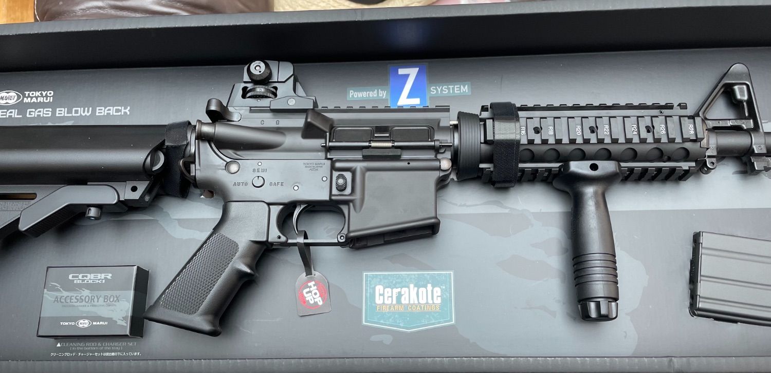

MalcyFett Posted August 8, 2021 Share Posted August 8, 2021 Got this today & 3 extra mags. Will spend time this week installing a bcm grip, brass nub and some other external parts. How many mags do folks generally run for a day? I’m thinking if I grab one more to take it to 5 in total, that should be enough. Tom_84 and SSPKali 2 Link to comment Share on other sites More sharing options...
Jacket Posted August 8, 2021 Share Posted August 8, 2021 I run 1 + 4 in rig and rarely run out. I keep loose BBS in my trouser pocket and top up mags as I go along, slotting them in 1 at a time with fingertips. MalcyFett 1 Link to comment Share on other sites More sharing options...

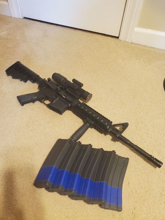

AlphaBear Posted August 8, 2021 Share Posted August 8, 2021 I have 8 Mags in total of which 2 are still in their packets. So by the power of mathematics I run 6. On reflection I should sell the other two lol MalcyFett 1 Link to comment Share on other sites More sharing options...
