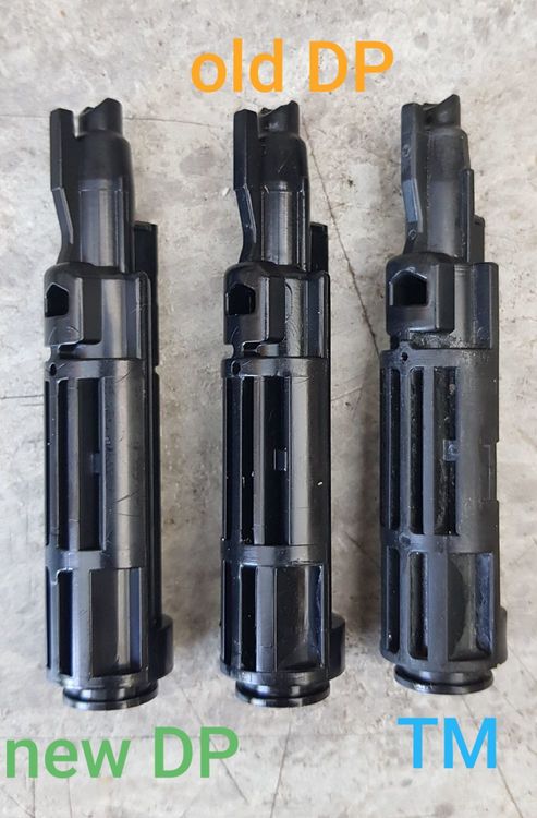

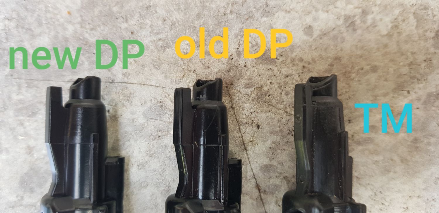

6 hours ago, GothicGhost said:
And is the Dynamic Precision Reinforced Nozzle For TM M4A1 MWS better then the stock one?Dynamic Precision Reinforced Nozzle For TM M4A1 MWS
I have been using the TM nozzle and had a DP one as a spare. I tested it the other day and found a slight FPS increase (I think it seats deeper in the bucking)....and then the back ripped off it!
Mine was probably purchased 18mths ago and the spare from JKArmy (here in 5 days!) looks like a less shiny (less brittle?!) plastic.
I need to give it a proper test but initial thoughts are the TM valve doesn't fit as it is a hair too large a diameter. The alloy DP one is fine.
My TM nozzle has been giving inconsistent FPS (265, 266, 264, 150, 265...wait what?) and I think that is to do with the wear around the part that seals on the bucking.
Edited by SSPKali
Clarity
1 minute ago, SSPKali said:
I have been using the TM nozzle and had a DP one as a spare. I tested it the other day and found a slight FPS increase (I think it seats deeper in the bucking)....and then the back ripped off it! Mine was probably purchased 18mths ago and the spare from JKArmy (here in 5 days!) looks like a less shiny (brittle?!) plastic.
I need to give it a proper test but initial thoughts are the TM valve doesn't fit as it is a hair too large a diameter. The alloy DP one is fine. My TM nozzle has been giving inconsistent FPS (265, 266, 264, 150, 265...wait what?) and I think that is to do with the wear on it.
Stand them up vertically and see if the new DP nozzle protrudes a tad more. To me it seems the head of the nozzle seems a tad longer than the Marui one. But it may well be the way the pic is taken.
I would but they are all assembled as I have been testing them! One day when I am bored I will
EDIT I have measured the very old and worn TM one and the "old" but less used DP one - the DP is 0.41mm longer over all. New pic is the TM (left) and Old DP (right) side by side.
It seems that the lightweight bolt has worse issues with low fps randomness. I think that certain combinations of bolt and nozzle mean the the BB can be seated too deep in the bucking meaning less fps and hop. New TM bucking with 4 clicks on the adjuster...may need one or two more but I only have a 10m range!
DP nozzle with DP valve and G&P stop (low) in a DP lightweight bolt is giving 260fps (0.30g, ASG gas, 14degC)
Same set up with G&P stop in the mid position = 315fps.
No weird drops in power, all nice and consistent :)
TM bolt with AG Mk2 complete nozzle is giving 270fps +/-5fps. Plenty of adjustment either way to compensate for the weather and ammo weight.
I have the TM and AG Mk1 nozzles as spare spares should I trash the other two!
