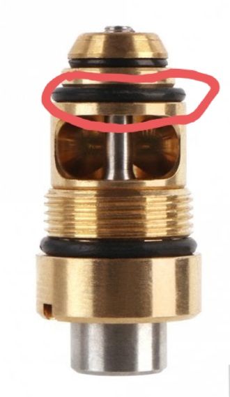

PewPewLoki Posted April 14, 2021 Posted April 14, 2021 (edited) 6 hours ago, Hypokondrikern said: @PewPewLoki Interesting find. I believed that the leak was from the middle of the mag where the two halves meet. That was at least how I got one leak free - simply by merging them with steel epoxy. Anyway, good to know that the valve is 1911 spec for Easy replacement. The question is however, did they become leak free after you changed out the valve? Also, could you clarify what o-ring it is that have created the maracas, and where it sits on the valve? I didn’t quite get that ( p.s haven’t seen this o-ring floating around in mind ) Yeah, just replaced all 5 o-rings and a perfect gas seal now. Used Lees Precision rings from their MWS kit and made sure to keep everything nicely oiled and not overtightened. I've circled the specific one that was missing on all my valves below, (though this is a photo of a different valve brand and not the exact same ones SAA use). If it's missing from your valve, but you can't see/hear it, it may be stuck on the threads the valve uses to screw into place. You might be able to unseat it using a toothpick or a small screwdriver if so. Edited April 14, 2021 by PewPewLoki Hypokondrikern and camden 2

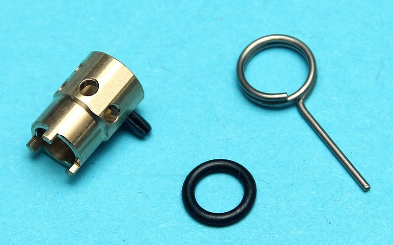

SSPKali Posted April 16, 2021 Posted April 16, 2021 (edited) Fire Support were as speedy as usual and the G&P adjustable valve stop was delivered today. TL;DR: 3 easy settings to tune to temps / gas - but may not play nice with stock TM parts, more testing needed. Overview: It comes with an o-ring to fit the "firing pin" end of the nozzle spring. Also included is a little grenade pin to help locate the valve stop and align the screw hole. There are 3 sets of holes for the screw to fit, each a slightly different distance from the front meaning you have a low, medium and high setting as this controls how far back (or forward) the rocket valve sits. Kind of like a 3 step NPAS, but not interfering with the valve function and no chance of unscrewing and firing a grub screw down the barrel! The brass body has some subtle flats machined into it meaning that it doesn't rotate as you push it down the nozzle to getting the correct hole lined up is easy. The pin makes it easier to locate as it is a snug (but not tight) fit in some nozzles and has to be perfectly straight to seat properly. Testing: First I tested my stock TM bolt set up (TM bolt, nozzle, valve, valve spring, Dynamic Precision upgraded nozzle spring set & green piston cup) to get a baseline with 0.30g on ASG gas at 14degC gave an average of 273fps (6fps spread) I then used that exact set up with the G&P valve stop and it gave the following average FPS: Low - 61, Medium - 152, High - 230. Yes, those are FEET per second, not meters! Great if you want to run black gas in the middle of a heatwave I guess??? Seems that it didn't play nice with the TM nozzle/valve for what ever reason. One day, when I have time, I will revisit this and try to pin down the issue, I am guessing the internal bore of the TM nozzle is the issue but I can't say for sure at this stage. I then tested a set up I knew would increase the FPS - Premium Aftermarket Setup (Same TM bolt; Dynamic Precision nozzle, alloy valve, valve spring, upgraded nozzle spring & green piston cup) Low - 145fps, Medium - 240fps, High - 277fps. That is more like it! The consistency was also really good, I think from previous testing that this is down to the allow DP valve (3fps spread!). The medium setting will be great for running it in the summer (c. 20degC) or in cooler temps on Red gas. I am guessing the low will be around the 200-210fps mark so probably not that useful unless you have loads of Nuprol Black gas kicking about. Summary: A nicely made bit of kit that does exactly what it should and gives enough adjustment for UK weather and gas options. I just need to work out why it hated the TM nozzle, valve and valve spring so much! YMMV. Pictures: Blue background - G&P nozzle stop kit, Red background - Dynamic Precision valve Edited April 17, 2021 by SSPKali edited for clarity and LOW power setting data Wild Weasel, RMDavis and TadsJ2 3

SSPKali Posted April 17, 2021 Posted April 17, 2021 (edited) I have updated my long post above with the LOW power setting as I had some time today. Unfortunately after setting it back to HIGH and checking it on the chrono the back of the DP nozzle sheared off ? So I popped the set up in the TM nozzle and tested it - with all TM parts it was putting out 220fps on HIGH. (0.30g BBs, Nuprol Green) I put in the DP valve and spring and it went up to 261fps. Then, because my day couldn't really get worse*, I sanded 0.1mm off the "pegs" on the front of the G&P valve stop. High jumped from 261 to 296fps (+35fps) and Medium went up to 263fps (+22fps) This means that Medium is a useful power on green gas on 14degC days, and High can be used in winter conditions. I think that Low might still be a bit under powered but never mind! Now lets hope that my TM nozzle survives tomorrows game! JKArmy and Eagle6 are sorting me out with a nozzle, G&P roller bolt, little bolt roller and pin so I have a complete drop in spare ready to go ? *EOTech clone that arrived didn't work and when I tried to unscrew the cap to try another battery it wouldn't budge (not x-threaded) and then sheared the compartment off in the body. Edited April 17, 2021 by SSPKali
