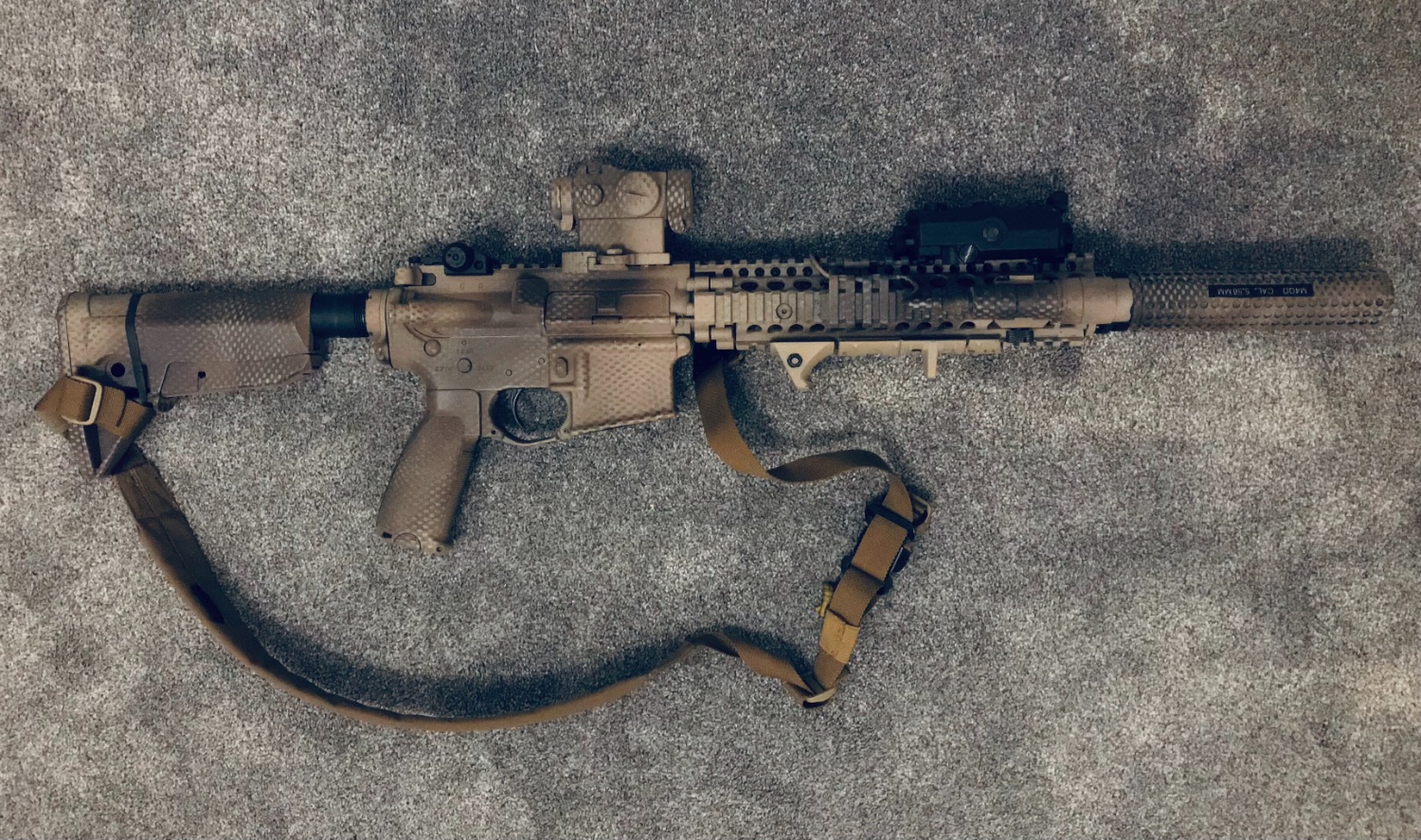

40 minutes ago, JSwan said:
I painted my MWS a couple of months ago. I separated the upper and lower and then taped off the gaps on the inside, closed the dust cover, taped off the trigger and the end of the charging handle to prevent any paint/spray getting in the inside of the gun, then put the two pieces back together. I too kept the inner barrel in and just taped off the muzzle device which worked. Just tape off anywhere you think it’ll get into the inner workings of the gun. Hope that helps!
Yeah this is the method I was going to use, saw it on T.Rex arms. Love the pattern effect on yours.
Thank you. Yeah I used the t-Rex arms video as a guide and also Garrand Thumbs design for the paint job. Really easy to do, spray it in alternating stripes of tan and brown, then lay some mesh over the top and spray the tan part with brown and the brown part with tan and voila! Snake skin type pattern

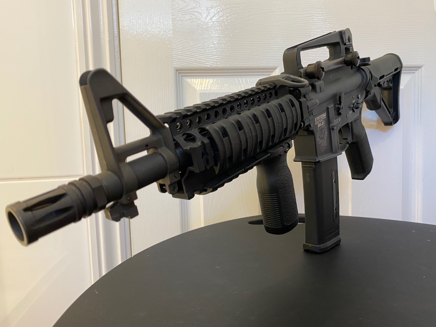

On 10/02/2021 at 18:29, AlphaBear said:
Something like this then? This is my CQB Systema ;)
Yes! ? That's exactly what I have in mind, as I can replace the muzzle brake with a silencer/tracer unit if needed ?
Problem is I don't know a lot about changing barrels in airsoft, so I'm not sure what length I should go for and if I need to replace the inner barrel as well or something ?

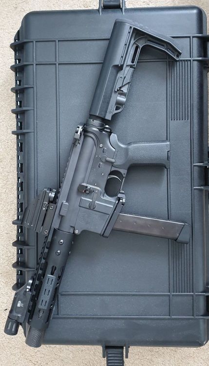

Well my little CQB build is running a 180mm Maple Leaf inner barrel and one of these Laylax outers - https://eagle6.co.uk/shop/catalog/product/view/id/5998/s/laylax-f-factory-m4-mws-outer-barrel-base-for-m4-gas-machine-gun-series/
That is just messing with my OCD and I don’t even suffer from it ?
How well do the bbs feed with that setup. Is that an MP type of mag and what adapter is that you’re using?
? I'm still tinkering with this and other bits but there's fu*k all else to do in lockdown.
Runs absolutely fine, it's the Prowin kit and it comes with 3 long mags. The standard TM Glock mags run it it also but don't lock back on empty (at the moment)

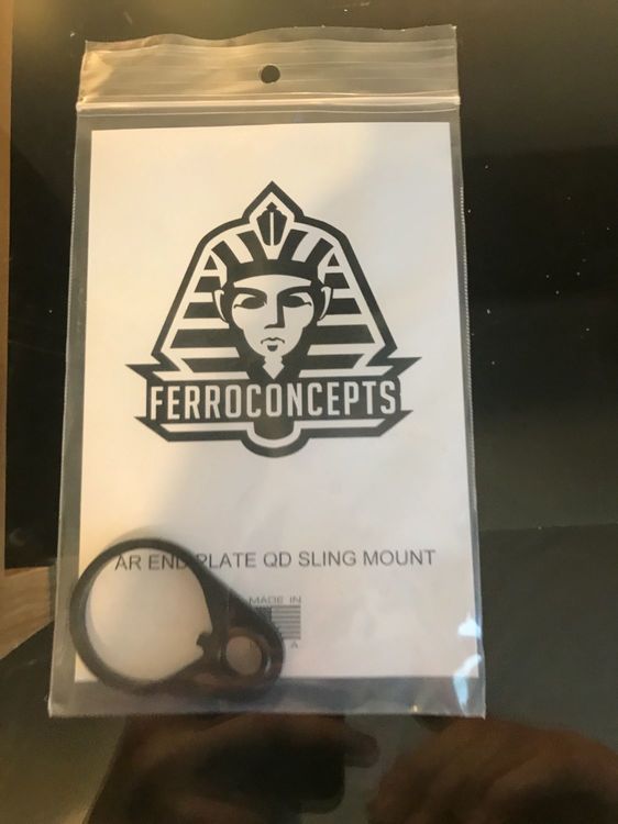

Anyone know I this guy fits? Says milsepc. I haven't replaced this part before, don't even have the armourers tool yet.

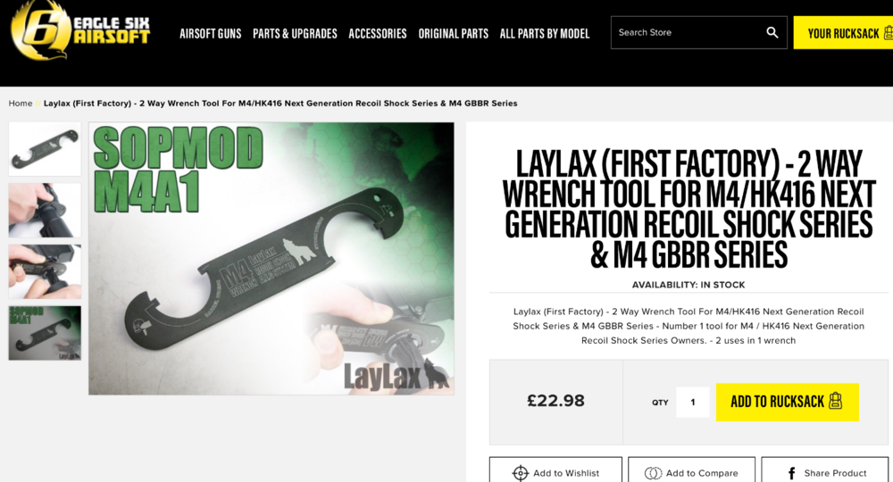

That's the wrench you need...

I've had my layalx wrench for 10 yrs (it's actually a good piece of steel to be fair)..... it works on all the Marui Next Gen and their GBBR guns too except for the 417 as that has a bigger buffer tube....but yours looks more versatile (good find)... :)

Yeah that was always the one I was going for. I meant will the QD sling mount fit properly? It's mil spec

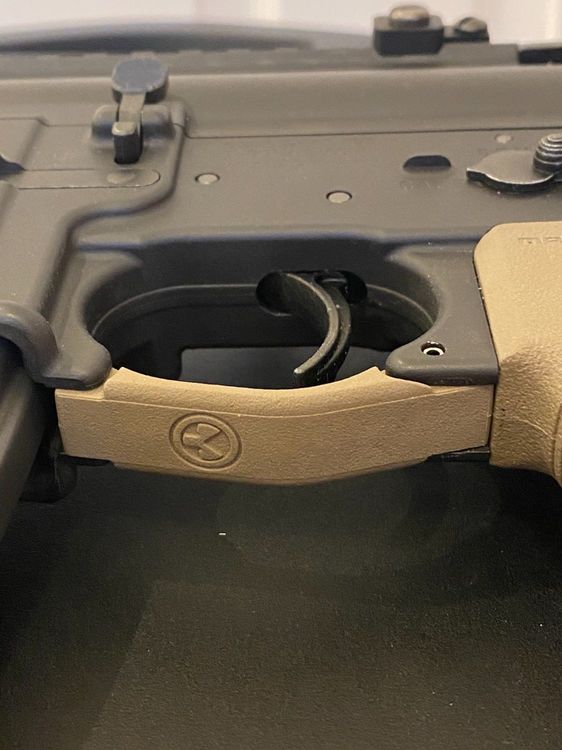

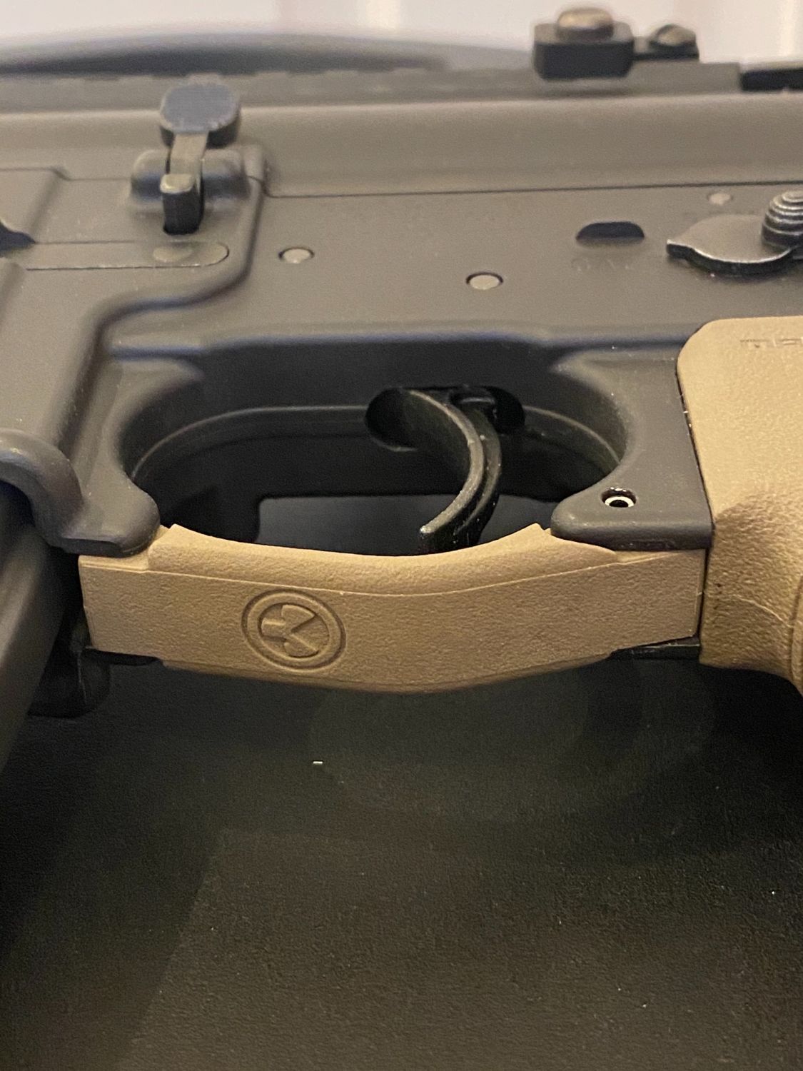

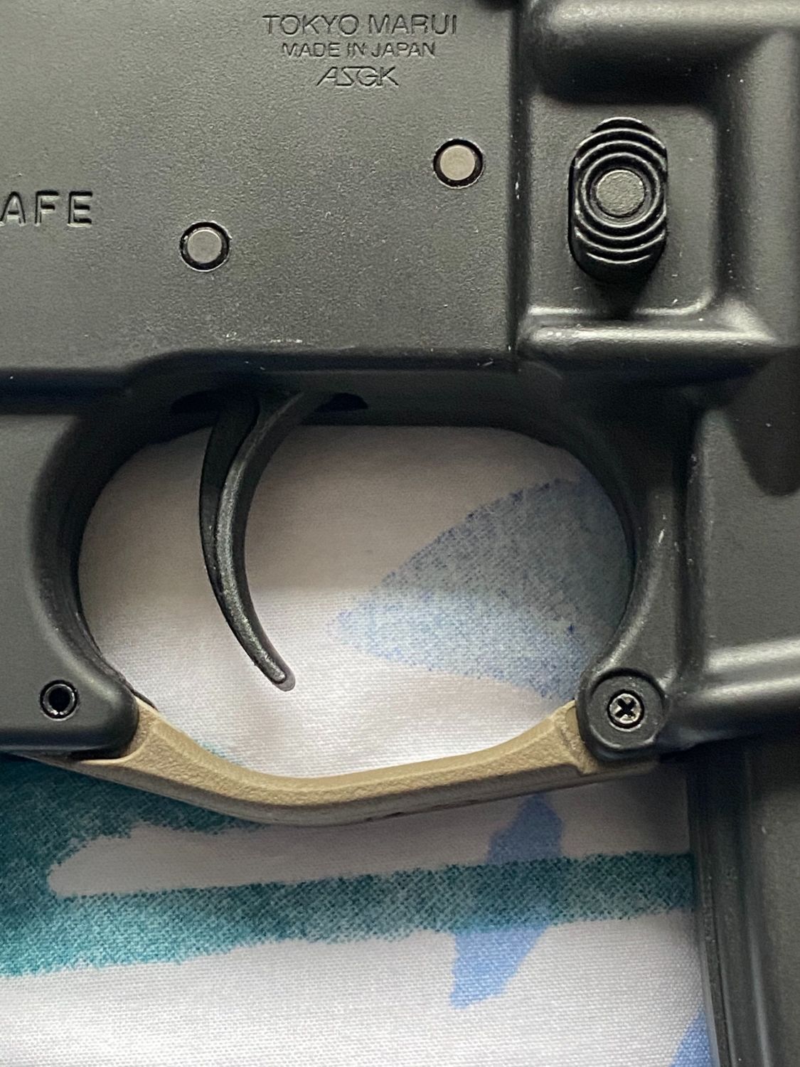

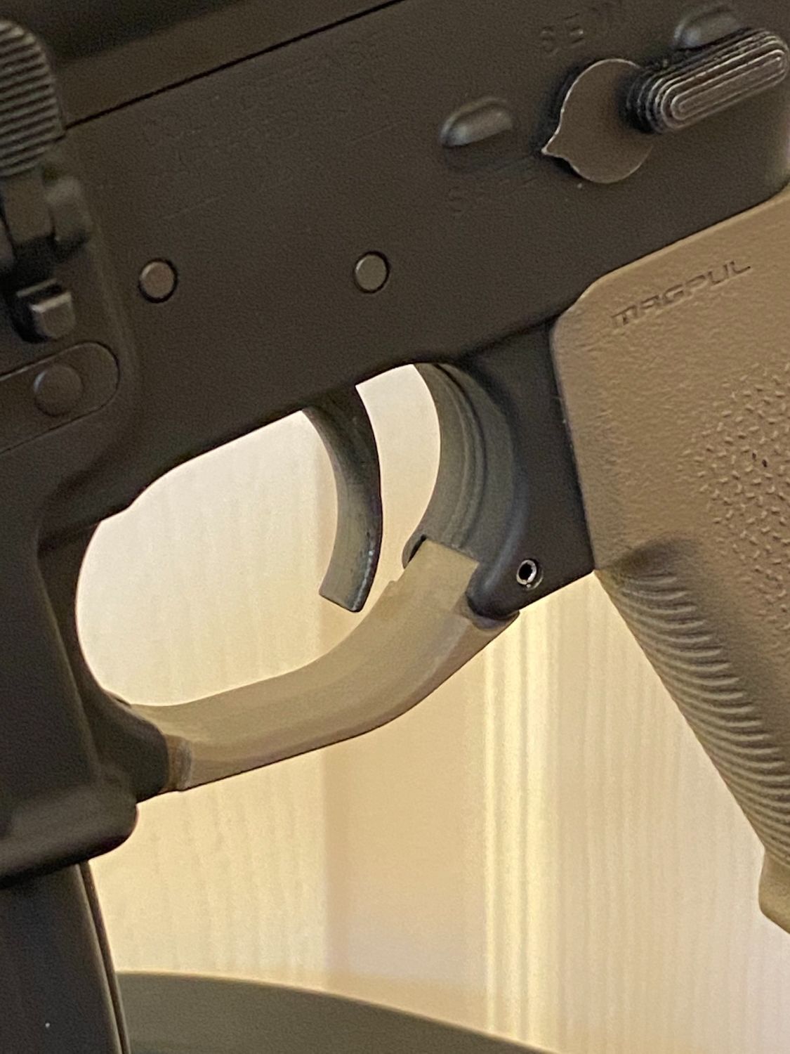

Fitted the Magpul trigger guard. Just a little bit of filing was needed. Word of advice use the original Marui trigger guard pin as the Magpul one looks a little thicker. Don’t risk cracking the trigger guard pin lugs ok.
Ok so scrapping the Ferro Concepts.
does anyone have any experience with the Angry gun QD sling mount?
I am gonna throw the sling swivel away and just mount an MS3 qd point straight to it.
Main concern, is it sturdy? Does it rotate at all?
Needs paint ;)
