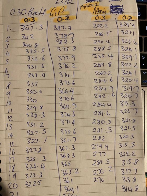

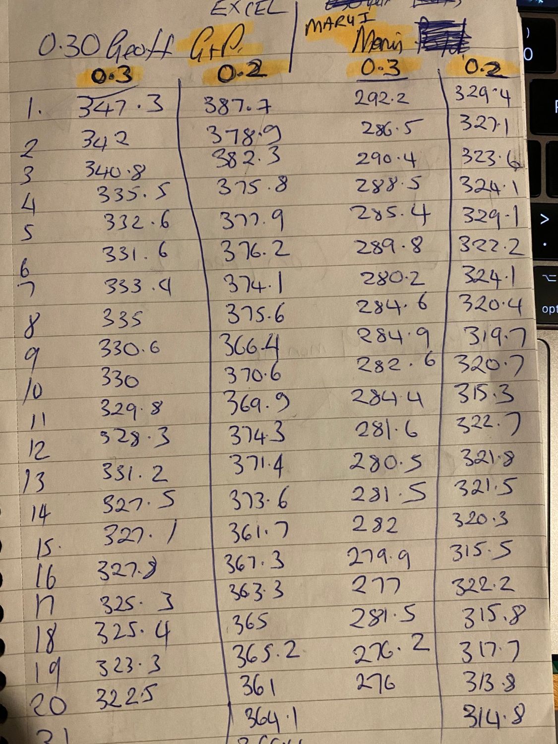

AlphaBear Posted January 23, 2021 Posted January 23, 2021 For those who want to know what power you get from using Abbey Ultra Predator gas (the one that comes in a red can) see the attached pic. I did some testing using 0.3 Geoffs and 0.2 Excels at a temperature of 20c (I do believe). The left side shows a virgin G&P bolt carrier group. On the right is the standard Marui bolt. The max figure for the G&P bolt was 387fps!! With the Marui bolt it was 329fps on 0.2s. Interesting results eh? The mag was filled up each time fresh of course which explains the initial high power. gunbod007, Crazy_Crystal and SSPKali 2 1
