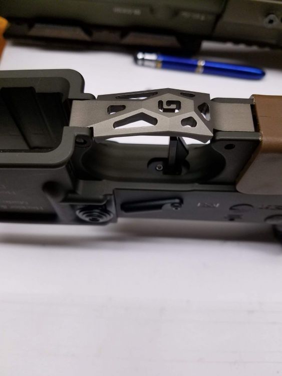

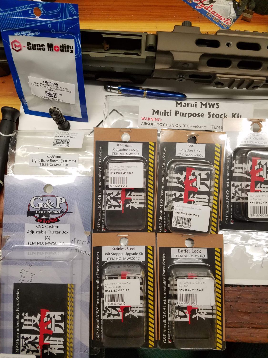

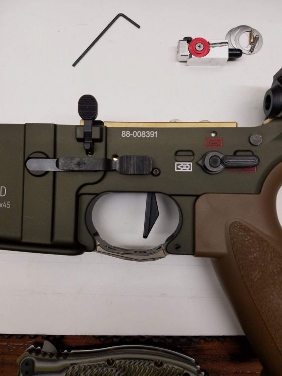

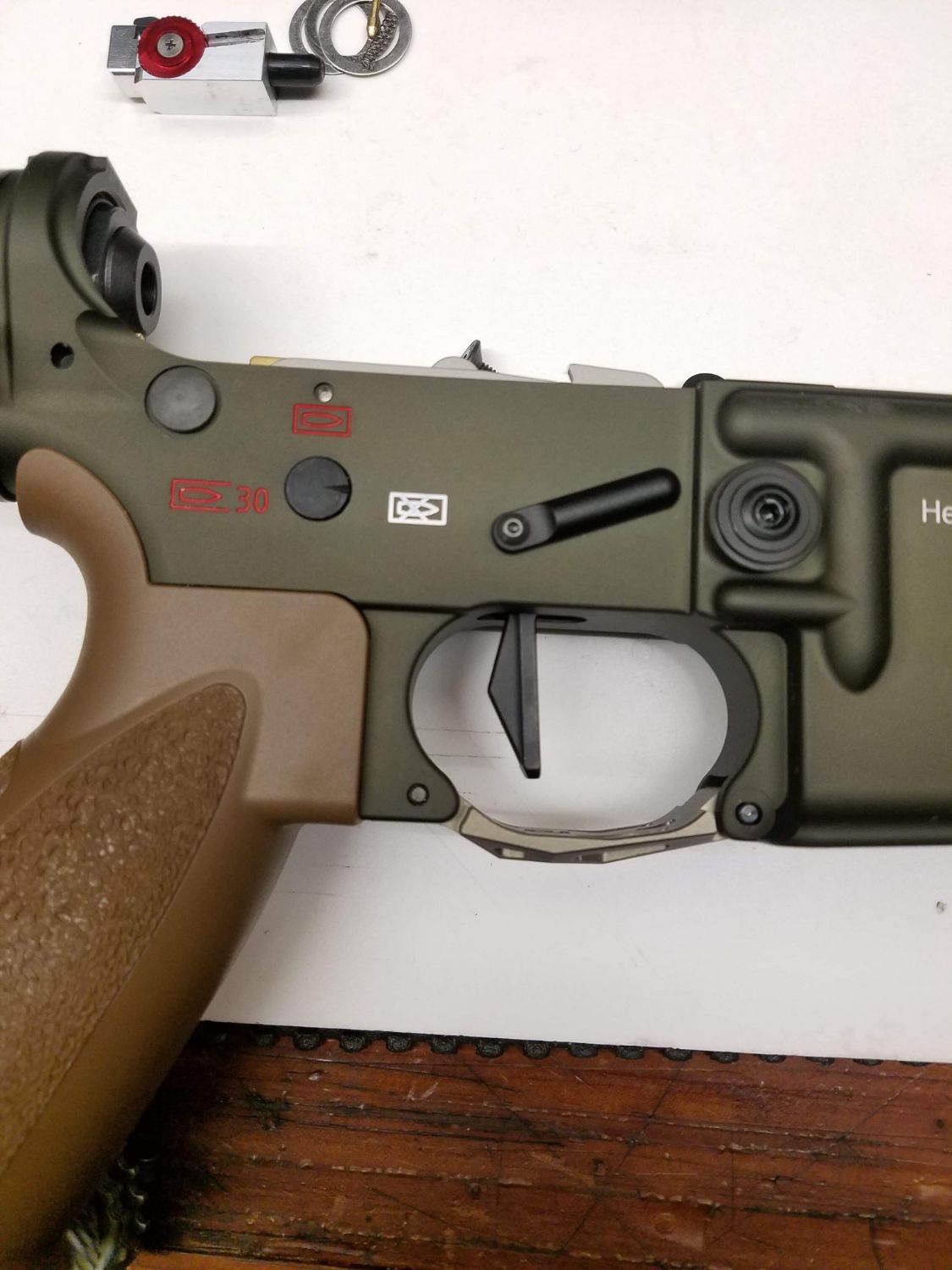

Marroksteel Posted October 28, 2020 Posted October 28, 2020 Well jkarmy has had one of my large orders for a month now (all parts were in stock) but sent me my 3rd order of parts so im stuck without a bcg 3 mags and a few odds and ends. But anyway the G&P/Guns Modify parts showed up and are in and awaiting the real steel furniture. Wild Weasel and Crazy_Crystal 2

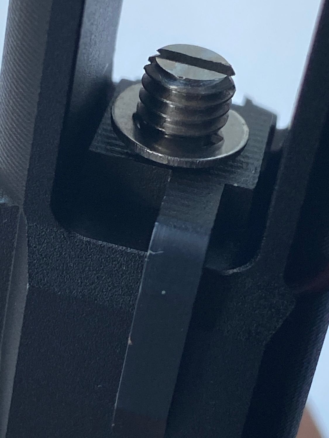

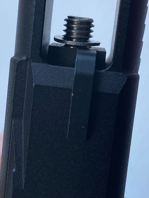

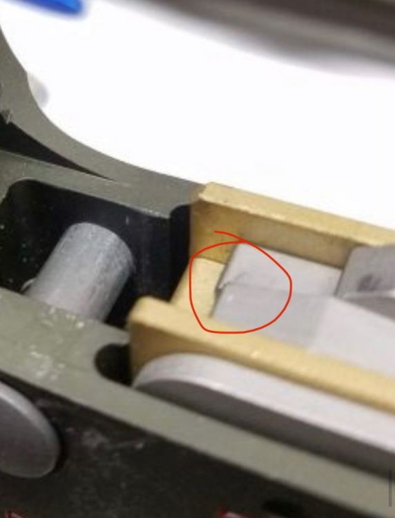

Marroksteel Posted October 28, 2020 Posted October 28, 2020 3 hours ago, jsmithski said: It doesn’t look good. Is this a crack? Just a piece of dust/fiber of some kind its all CNC'D then stone washed from the looks of it. 2 hours ago, PRIMEAirsoftTech said: Sorry to interrupt the current line of conversation guys, just thought I'd give you guys a heads up. Eagle6 have MWS mags in stock right now. I picked up four for my new MWS along with a nozzle spring set as a backup since I'm running green gas. There must be a bug on the site because UK domestic delivery was going to cost me £55, so I ticked the box to ask for a separate delivery quote and they charged me £11 instead. Very reasonable of them to do that! Lastly, this is my first GBBR and I love it, but has anybody got any tips for getting rid of the "mush" on the trigger before the break? Should I clean out my trigger unit? Its an expensive gun so I don't want to buy aftermarket parts for a long time. Thanks guys. "Mushy" trigger ? I don't know how AEG guys expect a mechanical trigger system to respond more crisp than contact switches and electricity personally the trigger responses is quiet good its not going to be anything like the G&P, Guns Modify, Wii Tech aftermarket parts. If you want to talk about mushy trigger the Military Issue M4A1 is another story so its not going to be like a Geissele unit. 4 minutes ago, AlphaBear said: That’s a good point about cutting the syphon tube cleanly and of course removing the valve to prevent any debris contamination. Regarding the bbs, I was under the impression that BLS, Geoff’s and Longbow share the same OEM. I’m not sure what the difference in Geoff’s precision vs super precision is though. I'd be willing to bet it's related to the polishing and shorting process.

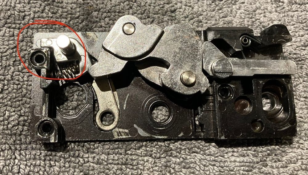

PRIMEAirsoftTech Posted October 28, 2020 Posted October 28, 2020 4 hours ago, Marroksteel said: "Mushy" trigger ? I don't know how AEG guys expect a mechanical trigger system to respond more crisp than contact switches and electricity personally the trigger responses is quiet good its not going to be anything like the G&P, Guns Modify, Wii Tech aftermarket parts. If you want to talk about mushy trigger the Military Issue M4A1 is another story so its not going to be like a Geissele unit. I'm perfectly happy with the trigger response, and I love the mechanical trigger having some mixed experience with real firearms. Its something I was really missing from AEGs. There's just a little bit of a "mush" before the wall that goes away if you pull the trigger to the wall and release it without firing, and I was just wondering if there was a well-known way to smooth this out as it is a common complaint that people have when comparing the MWS trigger to say a GHK or VFC trigger. That said, I'd take the MWS over the other options any day. My question is more from a point of curiosity because I'm interested in learning more about GBBRs in general. Don't think I'll buy an AEG ever again, I love my MWS too much. Apologies if my question seemed overly critical or unreasonable. jsmithsky, thanks for the photo! I'll look into it.
Marroksteel Posted October 29, 2020 Posted October 29, 2020 On 22/10/2020 at 08:49, AlphaBear said: I haven’t unscrewed anything to see what the insides are like. To be honest I got it on a whim whilst waiting for my replacement marui nozzle to arrive. Now I’m thinking, I may as well get the G&P npas valve and shove it into this bolt so that I can swap to using higher power when needed. I’m on a standard length (CQB) barrel so either i get the 3.5 version of the npas or I just get a 4.5 and adjust the power accordingly and hope that version works with the CQB. Dunno yet. Any thoughts? Now going back to the screw part it’s holding the hammer part of the bolt or whatever it’s called. Unlike the marui which has that bit forged as part of the bolt the G&P has it as a separate bit. See the pins below and you’ll see what I mean. G&P make two(2) different versions of this the long shown here is for barrels under 300mm the shorter for barrels longer than 300mm. And as you can see here adjustments are possible and is a user replaceable part.

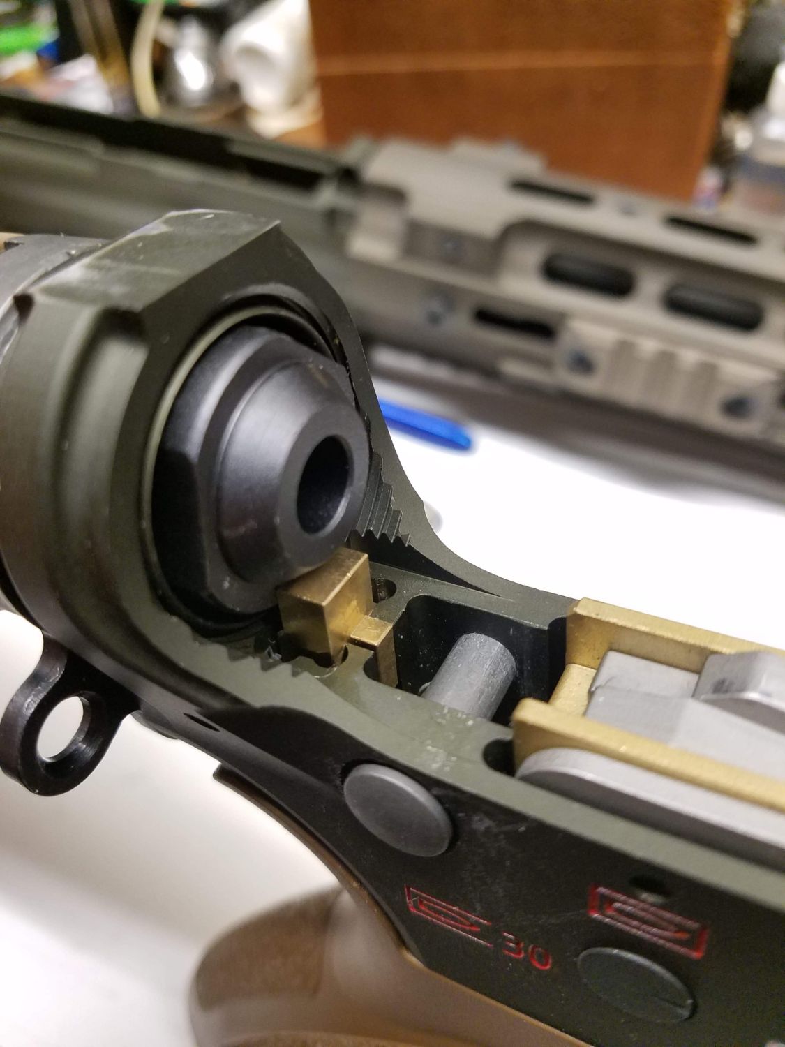

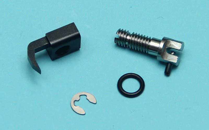

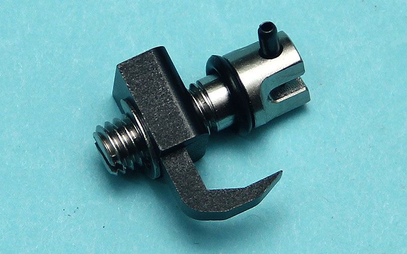

Wild Weasel Posted October 29, 2020 Posted October 29, 2020 28 minutes ago, Marroksteel said: G&P make two(2) different versions of this the long shown here is for barrels under 300mm the shorter for barrels longer than 300mm. And as you can see here adjustments are possible and is a user replaceable part. Won't the nozzle return spring twist up if you rotate the thread or does the circlip just retain the back of the return spring and allow the hammer ramp to just pull through? If so how does it work?
