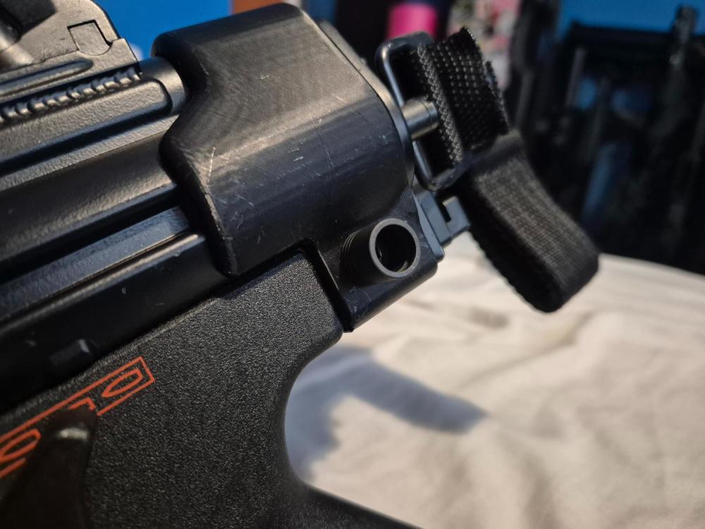

Guest Dumpholr Posted June 18 Posted June 18 Evening everybody, I've just had my first game with my new tm mp5 a5, amazing gun! Slings, I wanted a qd sling but rear mounting it is a problem. This is the solution https://hkparts.net/all-parts/hkp-quick-detach-sling-attachment-sling-pin-large/ but no UK shipping. How can I buy this from the UK without getting arrested? Thank you in advance.

The_Lord_Poncho Posted June 21 Posted June 21 I suspect for considerably less money, you could get someone to machine a version. I would presume the standardised spec for a qd socket is available online, that just needs to be backed with a correct length/diameter post that is female threaded at the end.

Anonymoose Posted June 21 Posted June 21 3 hours ago, The_Lord_Poncho said: I suspect for considerably less money, you could get someone to machine a version. I would presume the standardised spec for a qd socket is available online, that just needs to be backed with a correct length/diameter post that is female threaded at the end. It'd be an easy enough thing to make on a lathe. Only cutting the inner groove for the locking ball bearings would be tricky, but probably only need a tool ground to shape for it. (Or do that part on a mill.)

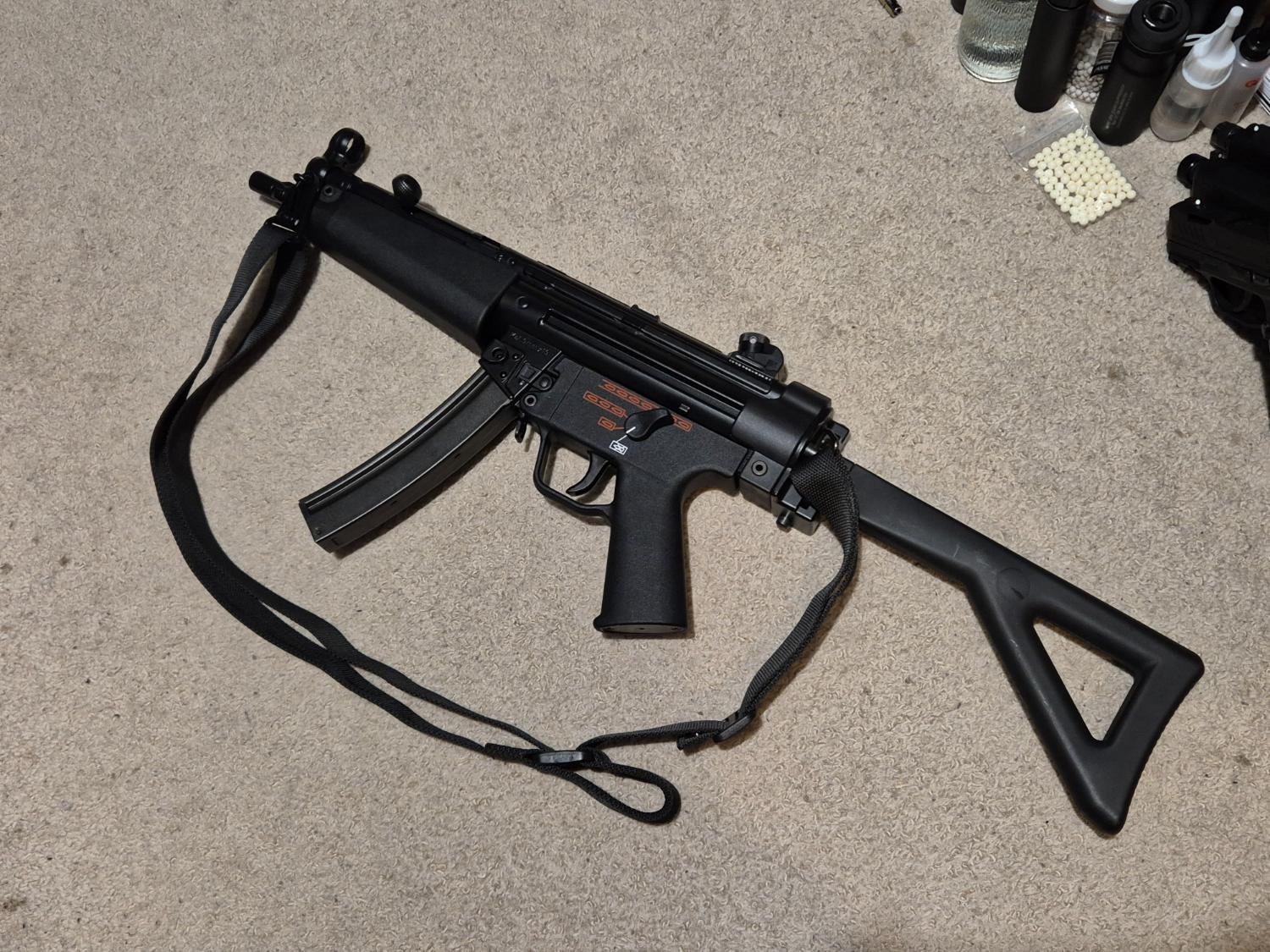

Hotweeweejef Posted June 21 Posted June 21 FMA clone of the Magpul MS3 sling works beautifully with my MP5. Fits the QD criteria, when set up as a single point and connects directly to the HK rear mount. £20 ?♂️
Popular Post Anonymoose Posted June 24 Popular Post Posted June 24 Two of those mounts off Amazon, some ally bar and a bit of lathe work later.. Rogerborg, ButcherBill, Lyndication and 4 others 1 6
