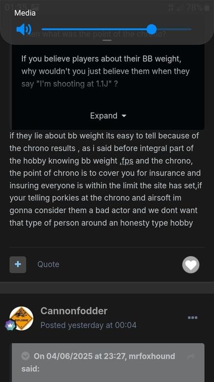

Cannonfodder Posted June 8 Posted June 8 14 hours ago, mrfoxhound said: its combination joules and weighing bbs But that's not what you originally posted. Rogerborg and Colin Allen 2
