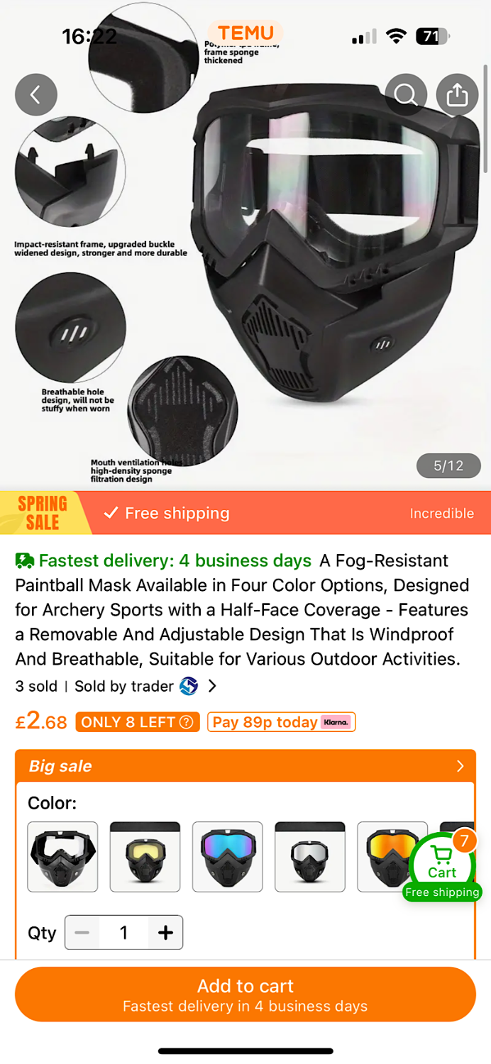

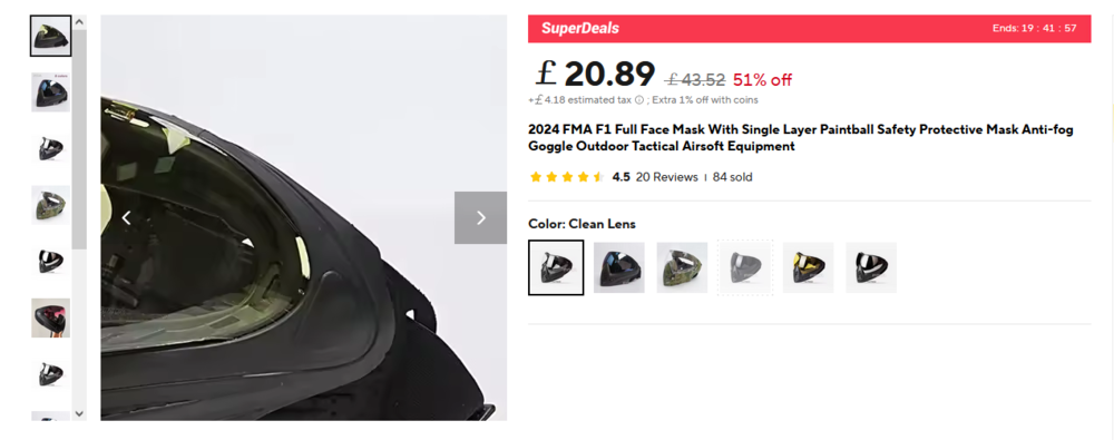

Popular Post Tommikka Posted March 11 Popular Post Share Posted March 11 Another set of non compliant goggles / eye protection identified by site staff I know that I’m preaching to the converted, but keep your eyes out for new players with their ‘nice cheap’ Temu/AliExpress/eBay goggles Observant site staff noted these ones https://www.facebook.com/share/12CBYwpEZa8/?mibextid=WC7FNe Galvatron, TheFull9, Cannonfodder and 5 others 7 1 Link to comment Share on other sites More sharing options...

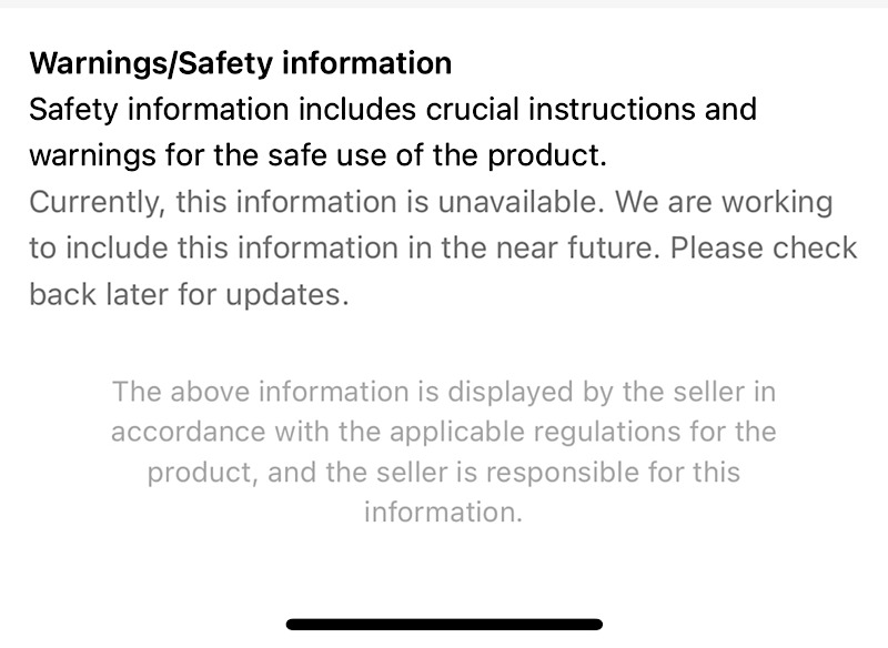

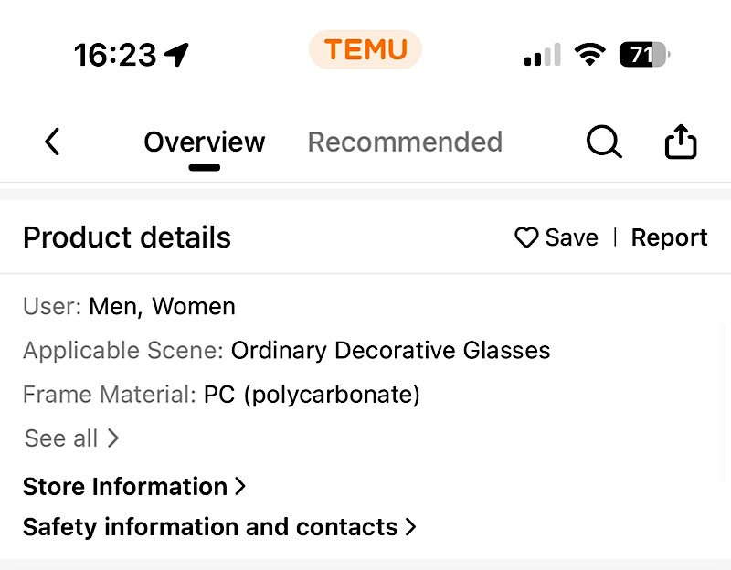

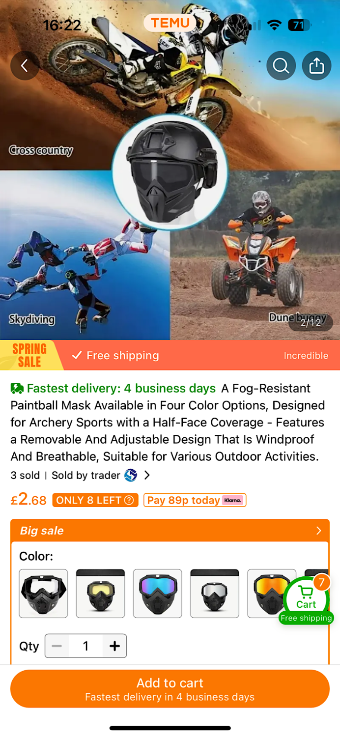

Tommikka Posted March 12 Author Share Posted March 12 4 hours ago, Chev Chelios said: What Tommikka posted is disgusting. Selling something marked as PPE when its in fact not is criminal. The thing is though - the post stated that they are not marked, and having found it on Temu, they are not sold as PPE Only the spammed listing title mentions paintball, the activities don’t have any impact related activities, the product details call them ‘decorative glasses’ and the safety statement has no safety claims They aren’t sold as PPE - buyer beware …… and the buyer should certainly have ‘bewared’ Link to comment Share on other sites More sharing options...
Chev Chelios Posted March 12 Share Posted March 12 4 minutes ago, Tommikka said: The thing is though - the post stated that they are not marked, and having found it on Temu, they are not sold as PPE Only the spammed listing title mentions paintball, the activities don’t have any impact related activities, the product details call them ‘decorative glasses’ and the safety statement has no safety claims They aren’t sold as PPE - buyer beware …… and the buyer should certainly have ‘bewared’ Is it not implied by calling it a "Paintball Mask" it is fit for purpose and use? For instance to sell something and call it "Bicycle Helmet" it needs to carry the CE mark and be fit for use. Rogerborg, Gryph and Cannonfodder 3 Link to comment Share on other sites More sharing options...

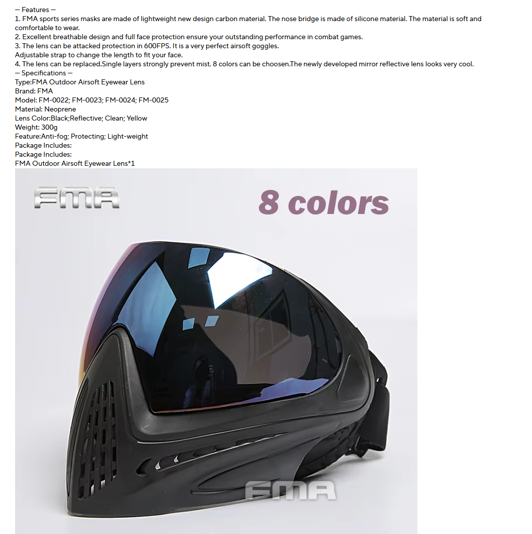

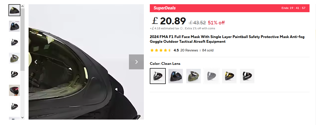

Galvatron Posted March 12 Share Posted March 12 I had a look for the FMA F1 mask on Ali Express and it lived up to expectations. It mentioned being suitable for airsoft and paintball but the specs were predictably vague. The Engrish specs state the impact protection is up to 600 ft/s without saying the mass of the projectile so that 600 ft/s rating means sweet Fanny Adams. Sometimes what's not mentioned is crucial and that lends well to "buyer beware". No mention of EN166B, ANSI Z87+ or any worthy rating standard should be a big red flag. Unfortunately, we have the luxury of knowing what to look out for but Amazon Marketplace, Temu and Ali Express prey on the ignorance of newbies, especially parents who don't know what to look out for. You've also got to be wary of clones that falsely declare being compliant, unlike the real ones. 1 hour ago, Gryph said: Thankfully my local is pretty harsh on that sort of thing. You get a warning followed by the boot if you start lifting your eyepro mid game. You have to be. I gave a mate of mine bit of a bollocking when he'd walked just 10m into the game area and took his eye pro off as it was fogging up despite having had two safety briefings. He knows now either to ask for help from another player or a marshal to get back to the safe zone if he fogs up and can't see. Tommikka 1 Link to comment Share on other sites More sharing options...
