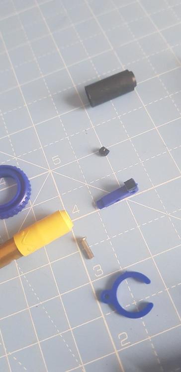

chrome_fbDeCj2gs7.png.70817c9b7463bb463e9ab3aebba90a3d.pngchrome_FljEfEXSPz.png.59865accd6e722465adc99c0bd84f56d.png
I noticed the original air nozzle is quite bad with no rubber rings inside so I bought a replacement. The issue looks to be the connection between the air nozzle, cylinder head and hop up rubber so I'll just replace this, grease up parts of hop rubber area and do some more testing.
Is there any areas in particular I should ensure I grease?
Expand
Just the o-ring inside the nozzle (or the tip of the cylinder head tube bit). If it's not mating properly with the lips on the hop rubber, your nozzle is the wrong length.
