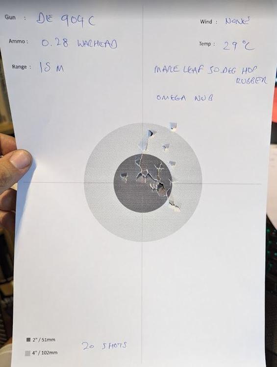

Now the 906C is not stock.   It has had the super-easy upgrade of the Maple Leaf 50deg Macaron bucking, paired with an Omega nub fitted.  When I tested this on installation, I didn't find much difference, but the guns shoots very accurately and consistently to decent distances.

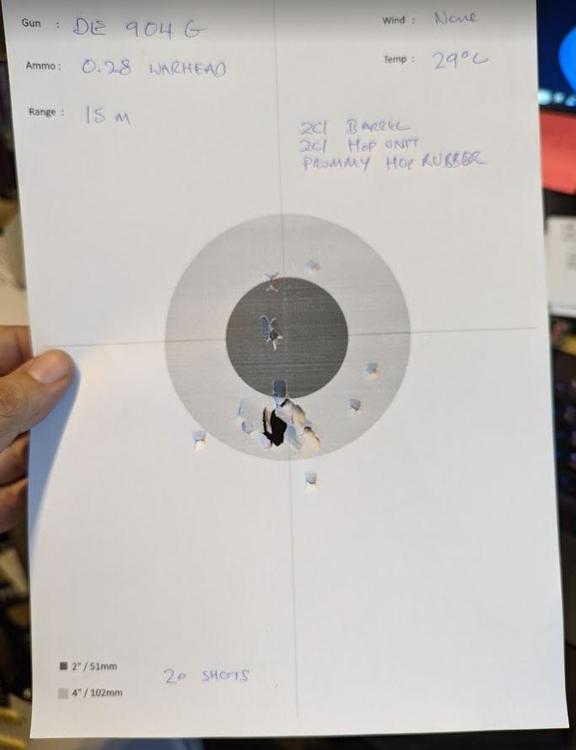

The 904G has had a ZCI tight-bore inner barrel and ZCI rotary hop fitted.   Both things are widely recommended on these forums.  A Prometheus hop rubber has also been fitted.
How can we tell which is better?
I set them both up with my Visionking 1.25-5x scope, set it at 5x, roughly zeroed and then grouped 20 shots.
969913852_DEM904Gtarget.thumb.jpg.386568ac6d7e6389fb5f12e4c619289a.jpg773826277_DEM906Ctarget.thumb.jpg.e3540db885a43a747d26667080196ac6.jpg
(Apologies for mislabelling the 906C target)
Pretty much sod-all difference!  If anything the 906C is better, as the 904G had a tendency to throw a couple of real flyers into the mix during zeroing.

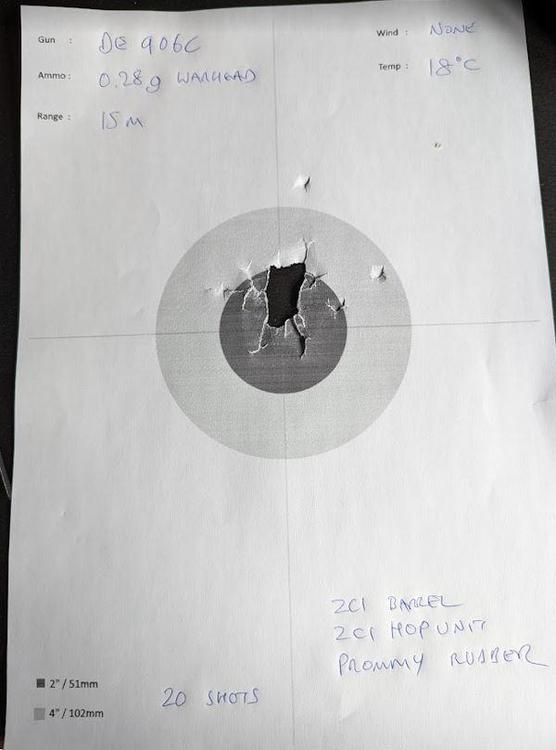

In the interests of completeness (i.e. stopping my slight OCD from kicking-in, for not posting this), here are my results with the M906C with the ZCI barrel + hop unit on board
Basically a 2" group with a couple of flyers.   Pretty good!
I'm not sure why it's looking better than the same barrel + hop + gearbox in the 904G...
Either
1) The outer barrel is a better fit for this barrel and hop (I certainly felt no need to wrap any tape around it, it's a decent fit with no real wriggle-room
or
2) Twenty shots isn't a good statistical base, and it was down to luck!
I might want to shim the back end of the barrel - that is also a good fit, but the locating rails/ridges on the outside of the hop allow a degree or two of rotation against the inside of the receiver.  If the gun's vibration rotate the barrel that would affect the direction of hop, and therefore the accuracy.  By how much in practice, I'm not sure... but it's something I could address anyway.
