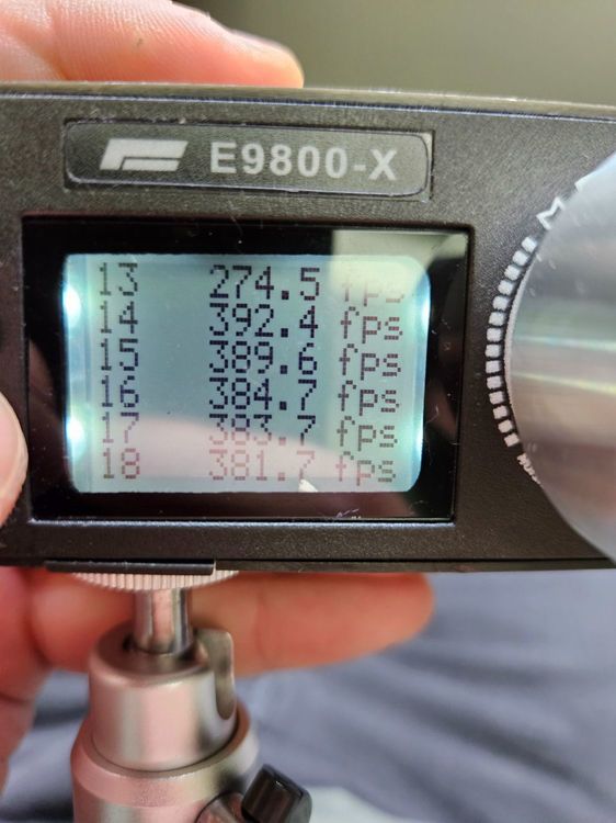

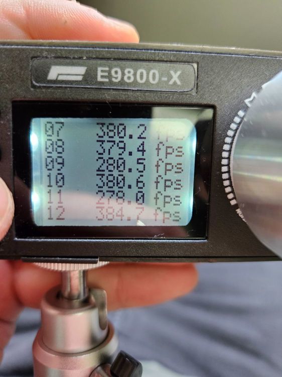

Hello! I have a AEG, that is constantly lowering more than 100 fps every couple shots. Any tips of which component is causing this? The gun is a m604e from de armory. It only had the air nozzle switched to this day because the stock one broke after around one year of use. I replaced with a 21.2mm, can you guys confirm if is this the right size as well?

To the OP. It sounds like you've got a problem with the nozzle getting a good air seal intermittently

As for the OP, if you run some of those readings through a calculator, a fair few of them run in to an issue with being over the legal 1.3 Joule maximum (aka firearms offence) assuming a standard 0.2g BB and not a 0.18g variety.
393 fps @ 0.2g = 1.43 Joule
384 fps @ 0.2g - 1.37 Joule
376 fps @ 0.2g = 1.31 Joule
So either the Chrono is faulty or someone has a naughty RIF.
