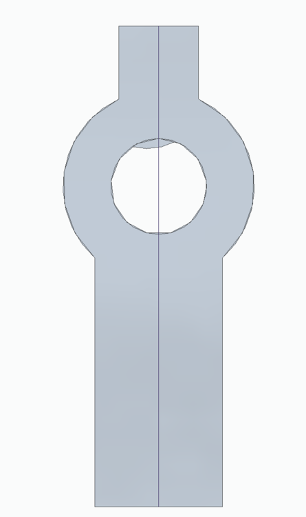

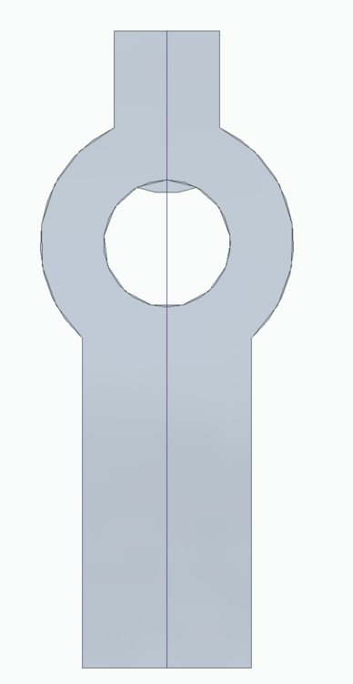

the alignment can be very subtle, if you're looking down the barrel through the back of the hop unit you'll get a picture like this:
image.thumb.png.1b70d5fa5af259bb6ffc538d2db7a656.pngimage.thumb.png.64b9dd39d5a494875513ef1a02b4c07e.png
left is misaligned and would curve shots off to the left, right is perfectly centered. of course you have to eyeball it based on the feed tube cos you can't cheat and add an imaginary line like i have on those images.
a deformation in the mound of the bucking would do that, some do have intentional shapes (eg the pdi w hold looks like a normal bucking with a v cut in the middle), but it's possible for wear/damage to do something similar which if off-centre can affect the spin and hence cause curving.
ill pop the hop rubber out after i see if its off centre, and ill get a picture of it
