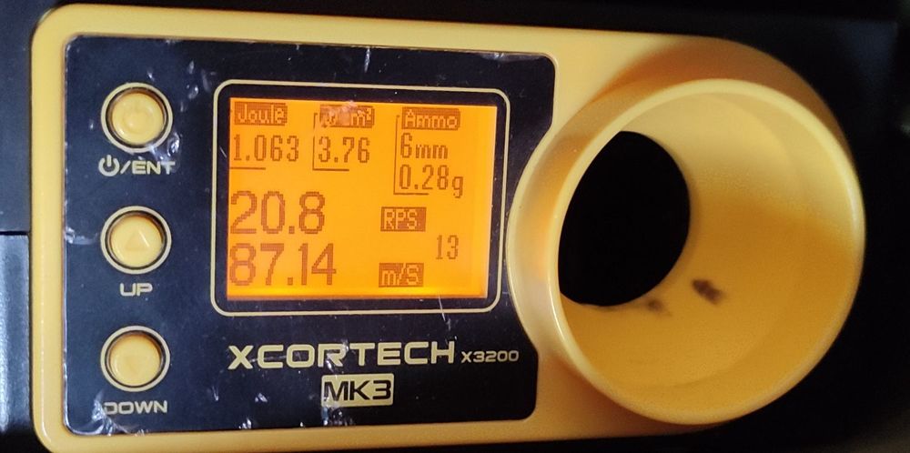

now people instead of helping are questioning that my guns can do 0.98J on a short stroked M90 setup.
Well now I'm questioning that. I know that not all springs are rated equal but that's quite the achievement.
Edited by Badgerlicious
SHS M90 is what's in there.
Probably not a true M90, but this is the chrono reading from 5 minutes ago, on a 7.4vIMG_20220407_130925.thumb.jpg.98e01a66fc30596c3b2b7662ad444810.jpg
Which btw is too hot and needs a second tooth knocked off the sector gear.
