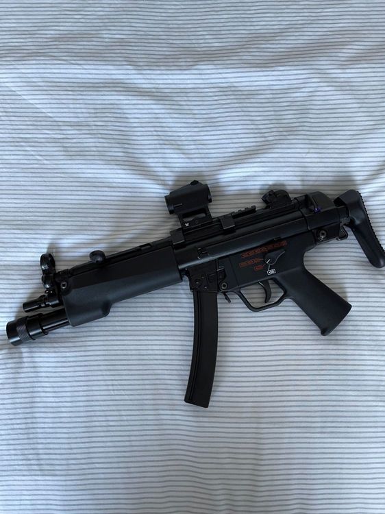

tworow2 Posted October 27, 2021 Posted October 27, 2021 On 20/10/2021 at 07:03, blobface said: On a less firer note: Surefire handguard, as we already know, is a drop fit, with some patience I was able to fit a 7.4v 1400mah nunchuck, I also had a shorter 7.4v 1300mah nunchuck which was even easier to fit into this handguard. Eotech 551 on a VFC generic low profile claw mount, and as I have a game soon before I could get hold of a Gemtech I came up with a little MP5 specific housing for the Acetech S unit's internal. That housing is very cool, is that custom made or pieced together from other things?

blobface Posted November 2, 2021 Posted November 2, 2021 On 27/10/2021 at 18:26, tworow2 said: That housing is very cool, is that custom made or pieced together from other things? Yeah custom made / 3D printed.

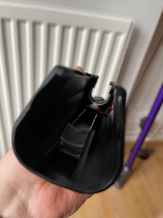

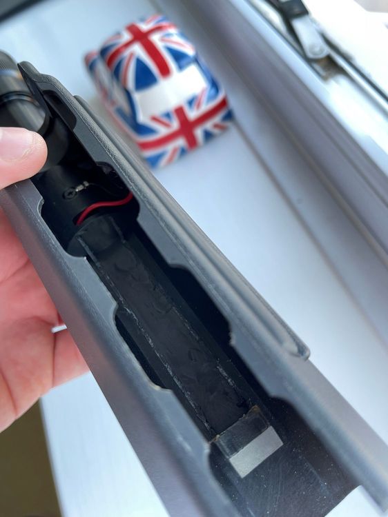

JamesWills Posted November 16, 2021 Author Posted November 16, 2021 My VFC Flashlight handguard finally showed up this morning after a month long wait from Bunny workshop Not quite as drop in fit as I heard it was but only a small issue which can be easily solved, the pin doesn't quite push through so I will take a Dremel and just enlarge that hole ever so slightly I am also going to try and take away the 2 lines of plastic inside the handguard to try and increase the battery space so I will let you know how that goes TheFull9 and Jacob Wright 1 1

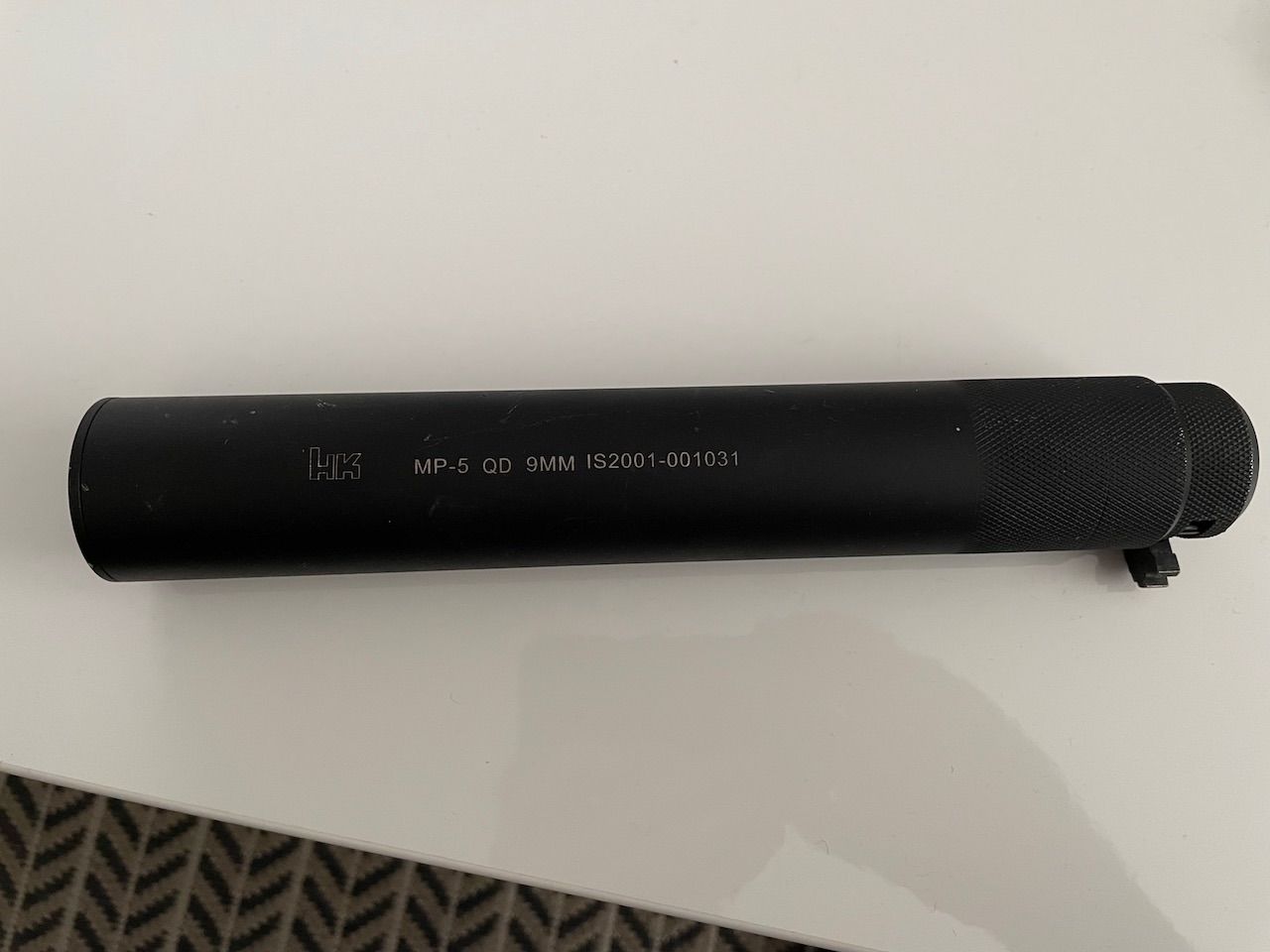

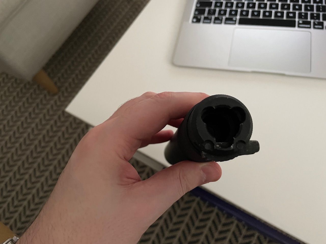

Farstarbuck Posted November 17, 2021 Posted November 17, 2021 (edited) Just a note about suppressors. I have had in a bag for ages a King Arms qd mp5 suppressor. https://airsoft.tiger111hk.com/p4716/King-Arms-MP5-Quick-Detachable-Silencer/product_info.html tri lug, go to put on, fits, doesn't lock? Says it fits the old Marui mP5, so is this new one different? Is the KA lug that different from this TM NGRS one? What am I doing wrong fellas? Thanks Edited November 17, 2021 by Farstarbuck
JamesWills Posted November 17, 2021 Author Posted November 17, 2021 (edited) Got my handguard fitted now and the space for the battery created max space for a battery is about 77mm long by 40mm wide looks like PEQ style batteries might be the way to go or one of these expensive titan batteries: https://www.landwarriorairsoft.com/batteries-bbs-gas-chronographs-c5/batteries-c62/titan-power-version-7-0-7-4v-3000mah-li-ion-brick-battery-deans-connection-p10821 Edited November 17, 2021 by JamesWills SgtTalbert and Nick G 2
Hatchet Posted November 17, 2021 Posted November 17, 2021 4 hours ago, Farstarbuck said: Just a note about suppressors. I have had in a bag for ages a King Arms qd mp5 suppressor. https://airsoft.tiger111hk.com/p4716/King-Arms-MP5-Quick-Detachable-Silencer/product_info.html tri lug, go to put on, fits, doesn't lock? Says it fits the old Marui mP5, so is this new one different? Is the KA lug that different from this TM NGRS one? What am I doing wrong fellas? Thanks I had the same with my Guarder one (which looks identical). As far as I can work out, the length the flashhider sticks out beyond the lugs is probably off a few mm. It might be possible to file down the front of the flashhider to get it to fit, but that's not something I fancy doing. From the disassembly video I watched, the flashhider and front sight are a one piece, so if you significantly arse it up, that's what needs replacing. Internally, my suppressor has a metal disc that prevents it being pushed too far on. I suspect this isn't very thick and nothing good will come of trying to thin this down.
Farstarbuck Posted November 17, 2021 Posted November 17, 2021 2 hours ago, Hatchet said: I had the same with my Guarder one (which looks identical). As far as I can work out, the length the flashhider sticks out beyond the lugs is probably off a few mm. It might be possible to file down the front of the flashhider to get it to fit, but that's not something I fancy doing. From the disassembly video I watched, the flashhider and front sight are a one piece, so if you significantly arse it up, that's what needs replacing. Internally, my suppressor has a metal disc that prevents it being pushed too far on. I suspect this isn't very thick and nothing good will come of trying to thin this down. Yeah thanks for responding. I see that there is a layer of metal which appears to stop the suppressor from coming further down the flash hider. As you say perhaps taking a dremel to it will work or arse it up. When I compared what it looks like inside to the adapter that comes with you can see a wider opening inside the adapter. Which makes me think that’s the issue. Anyway, stuff it bought a new suppressor to go with the adapter.
