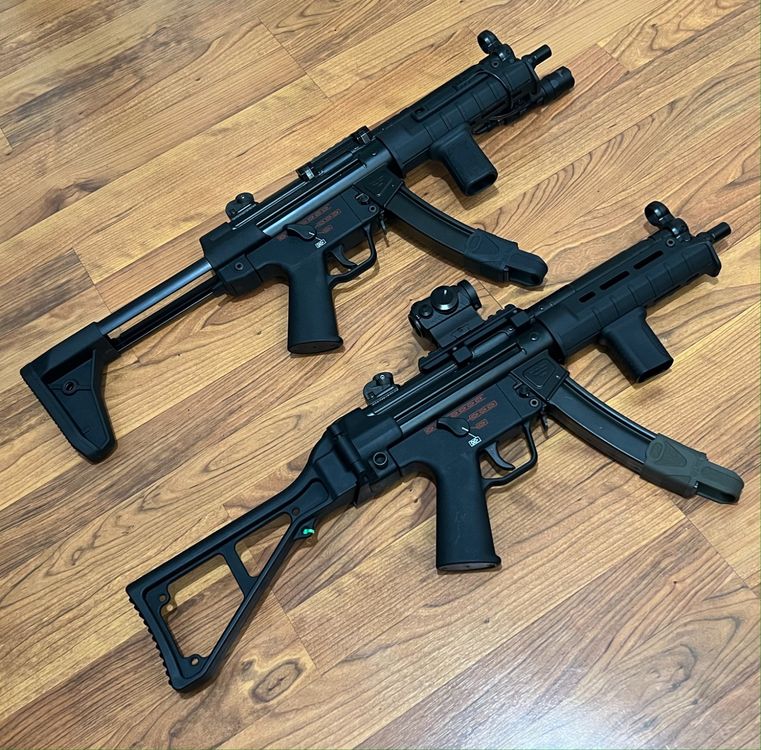

PigDoggy Posted December 20, 2022 Posted December 20, 2022 Magpulised. ? TheFull9 and JimFromHorsham 2
PigDoggy Posted December 20, 2022 Posted December 20, 2022 4 hours ago, Wavey_Gravey said: Was the new SL stock a drop in fit? It wasn’t. Had to remove material from the retractable stock which in turn would allow it to be pulled off from the base if the lever is held down manually. The hole for the pin lines up properly however though you’ll really want a locking pin for the rear. I used the one from the other MP5 with the UMP folding stock (has the QD sling mount). SL handguard was also not a drop in fit. You had to remove material around the back end of the handguard so it slots into place.
JimFromHorsham Posted December 21, 2022 Posted December 21, 2022 On 20/12/2022 at 09:56, PigDoggy said: Magpulised. ? I like them both a lot ! Nice builds ?
