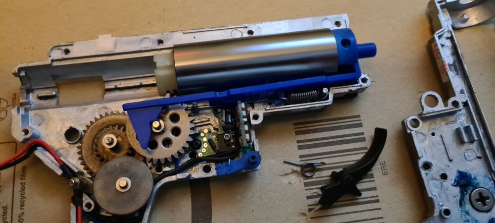

Misery Posted January 22, 2021 Author Posted January 22, 2021 well piston and oring has arrived so they are now fitted time to get the trigger bk in and casing on

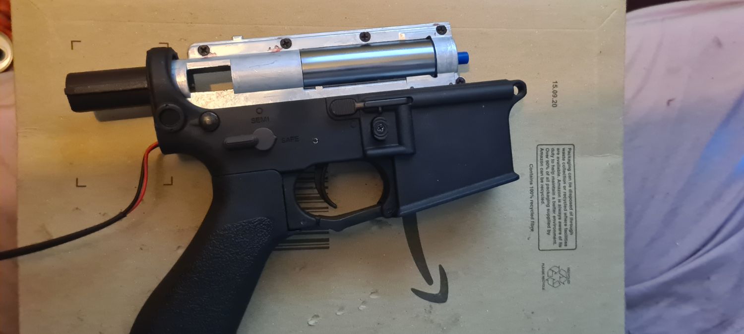

Misery Posted January 22, 2021 Author Posted January 22, 2021 well that was a shit show still double feeding so have stripped back down and found that the bushs have moved aswell so gonna order new bushings cause these literaly just fall out of the gearbox side,so more waiting around woooohooo lol
Supporters Sitting Duck Posted January 22, 2021 Supporters Posted January 22, 2021 WAIT WAIT WAIT a second... Double feeding so order new bushings ??? First things first - gearbox = pisspot zinc alloy bushings = steel (sorta) which material do you think has worn loose ??? (I suspect new bushings may still be a little loose plus different bushings/bearings will throw shimming out and all of this is likely to be unrelated to feed issues really) Poundland - £1 purchase of 2-part expoxy glue bushings in by a LIGHT smear around edges of box - refit & allow to set Double feed or misfeeding ??? without going into detail too much... assuming bb's slip through bucking/hop unit into barrel etc... (and tappet/nozzle is cycling correctly to feed/chamber bb etc...) is the mag a little loose in gun ??? can you put a bit of cloth (some use velcro - felt part of it, tape) place a bit of cloth/tape at BACK of magwell, effectively between gearbox & mag in well this will very slightly shift the hop forward as the mag is inserted (very very slightly shifting the mag/hop forward from box which will create a whisper more room in doing so there will be a slight increase in available room in front of nozzle that should assist in feeding there is a slight chance that fps "might" lessen slightly but test if it helps with feed issue first) Realistically - wind the hop off, see if gun feeds 101% if it feeds OK with hop off then things look OK what "might" be happening is bucking is greasey so not applying grippy pressure to backspin/lift bb so you wind on more pressure and create jams etc... (often diagnosed as misfeeds - nope it's a jam) is the hop working ??? you don't need to see nub forming a solar eclipse as you look down hop/barrel it just needs a very slight bump to create backspin the barrel is 6.03~6.05mm with a 5.95mm bb, you can't have it looking like a stopcock/valve half open tilt gun on its side 90 degrees & fire to see bb's curving right/left = hop sorta working but if you keep winding it on you'll get a jam in the end The v2 gearbox is cunt for nozzle/tappet tolerances the tappet fin could be worn - but I kinda doubt it (plus the cyma tappet is a bespoke bastid) is the box properly all bolted back into place, with box in position (be careful tightening the stock tube up really tight, especially in metal receivers - yeah its plastic) but if stuff is slightly out of whack, nozzle can rub on hop impeding its operating (feed/chamber issues) as said previously - try shit in other gun test other mags - use good bb's, swap out barrel/hop combo first basically try a process of elimination/trial n error before steaming in & buying new bushings (which still might be a bit loose if cheap box allows present bushings to fall out) the tape velcro thingy might assist if shifting the hop forward very slightly and allow a smidge more room/clearance for bb to slip past the nozzle at full retraction the cyma sector will not allow you to fit a normal delayer, so that suggestion is not really an option stuff like filing down the nozzle is NOT ADVISED as you will likely lose fps from shortening nozzle (the velcro/tape at back of magwell will slightly do the same effect but without fucking shit as you can always remove velcro/cloth tape - but can't put back material you filed off nozzle) it is too easy to steam in and think it must be this - often it isn't and doubt if bushings will resolve the issue - well not as I can see in your pic, the sector cam was just behind the tappet fin so it needs to be slightly in front of fin when reassembling or box won't close also - might worth rotating tappet spring 180 so the loop is closer to tappet underside/hook than at the bottom like in your pic - but depends on tappet spring as some have "loops" formed differently than others. Some say it don't matter which way it is fitted but on reg trolley switches the loop on the "hook" goes close to tappet underside to keep the tappet spring closer to tappet in operation etc... (probably won't make a difference but wondering if spring was fitted that way round) close of Cyma from TWG... looks like your tappet spring might have been fitted the other way around (might make next to no difference, but the loop is tighter to tappet underside (usually) than leaning towards bottom of hook) Most of this is my OCD kicking in - I'd try say the tape in magwell first before ripping box open, swapping tappet spring around and removing stuff to glue bushings etc... if box was assembled OK then it "should" just work looks std with no massive amount of wear anywhere so it "should" work, not as if fucked components or new nozzle too long fitted so again "should" just work as intended without going nutz some guns/mags like the tape in magwell to reduce wobble and help feeding it is another kinda bodge/workaround on M4 style guns/mags with sprung/floaty hop units but providing other hop/bucking/feed/jam issues aren't involved (hence swap/try the other hop/barrel combo in there from other gun too) don't go stripping down a hop/barrel combo that works OK - just the complete unit try out to diagnose what the main issue might be why the sod don't wanna feed too good ps - be carefull with the two black wires getting close to that little hole that is the where that little pin goes through and if wires are not routed carefully it is easy to nick/puncture them with the receiver pin - I've done it (so you learn by our mistakes certain things to take note of next time & stuff to watch out for) yup - people think v2's are pretty straight forward - well they are but there are a few things to note and stuff like routing of wires - well basically everything I guess needs a little attention to detail you probably was OK, but just looked a tiny bit close to the pin hole and like I said I've punctured them wire(s) in the past not checking/routing stuff carefully pps - shims on sector gear go in front of tappet not underneath but sure you refiited it all correctly - with shims on top of sector gear & tappet fin
Misery Posted January 23, 2021 Author Posted January 23, 2021 no wasnt meaning the bushings are causing the problem of the double feeding the bushings coming loose i oticed because of the fire selector switch didnt feel right was stiffer than it should of been thats when i noticed the bushings a couple of the bushings had moved out of there holes whrn took apart they werent as tight in,but if u recomend to 2part epoxy em in then thats fine i thought i would of had to replace them that spring i will refit the right way when i refit dont get me wrong she was firing bud no unusual sounds just the odd double feed which i put down to the hop rubber upgrade so reverted bk to stock at same time as checking why the switch was tight which i assume is cause the gear has shifted ever so slight and put pressure against the casing and against the lower receiver causing it to be stiff as for the wiring yeah ive noticed that im actualy contemplating replacing the wire as few bits are looking a bit dodgy and i have the time to sort it properly than just leave it till it goes lol thank you for telling me that with the shim that is noted for when i refit everything will get epoxy ordered in tonight so i can get it done tomoz or sunday thank you again i know i must eb a pain in the ass lol
Supporters Sitting Duck Posted January 23, 2021 Supporters Posted January 23, 2021 shove a bit of grease/oil in the rails of blue selector plate so that it glides back n forth smoothly not tons of it but a bit here n there these boxes are slapped together by 5 year olds bone dry no smoothing of burrs n shit, rough cast edges etc... so things like selector plates n stuff glide like a frozen wobbly shopping cart going over speed bumps in a gravel track - pretty fucking shit slapped together by kids doing piece work: get it in & whack it out sorta stuff for 50 cents (that'll be alright, in will run/wear itself in) no wonder we end up doing the finer finishing ourselves at times The 8mm bushings shouldn't foul the selector plate as such bushings tend to be a bit thicker inside than outside bearings though, can protrude a bit more and sometimes snag on selector plate just a tiny drop/smear of oil/grease should see plate glide smoothly then the selector switch should operate better without snagging/strain (be careful of oil/grease going into the electrical mosfet/sensor switch behind selector plate) no need to dismantle shit, just a smear worked into runners, glide back n forth & it should work itself in no problem these cheap guns are hardly finished at all and cheap Cyma cm.028a - jeez them gearboxes have razor sharp edges (could feel my fingers getting shaved & sliced on one of those fuckers) so often these high precision bit of engineering (sarcasm) need the odd bit of smoothing & a bit of grease as the blue Smurf jizz was just splurged in there at random it seems on them gears/bushings try the tape in magwell - might help/assist with some feed issues sometimes people put tape either side of magwell's long edge to reduce mag wobble other times certain mags, some midcaps can be a bitch to feed and others have felt taped the back shoving mag/hop forward to assist feeding or nozzle clearance (and it don't work you can remove it - no biggy)
Supporters Adolf Hamster Posted January 23, 2021 Supporters Posted January 23, 2021 See this is how it begins..... It'll be 13:1 short stroked before it ever hits the field It can be a rewarding thing getting a gun running sweet especially if you do it with care and attention rather than filling it with expensive bits. The trick with the maple leaf hop rubbers is they seem to have marginally longer feedlips than most brands, great for air seal (and therefore accuracy) but can make it hard for the mag to shove a bb past it. Way to check is to look up the feed tube when the barrel is installed see if there's too much poking out, a little is ok but more than about 0.5mm and it might be causing issues (although normally that's occasional double feeds in a sea of blanks) Generally i keep a pdi w-hop handy as my go-to for guns that dont like ml stuff.
Supporters Sitting Duck Posted January 23, 2021 Supporters Posted January 23, 2021 6 hours ago, Adolf Hamster said: See this is how it begins..... It'll be 13:1 short stroked before it ever hits the field It can be a rewarding thing getting a gun running sweet especially if you do it with care and attention rather than filling it with expensive bits. The trick with the maple leaf hop rubbers is they seem to have marginally longer feedlips than most brands, great for air seal (and therefore accuracy) but can make it hard for the mag to shove a bb past it. Way to check is to look up the feed tube when the barrel is installed see if there's too much poking out, a little is ok but more than about 0.5mm and it might be causing issues (although normally that's occasional double feeds in a sea of blanks) Generally i keep a pdi w-hop handy as my go-to for guns that dont like ml stuff. good points there fuck me - prommy buckings are quite bad too must be the Leslie Ash of bucking lips... think there is lesson here that applies to airsoft too just don't go too fucking nutz get some work/upgrades done
