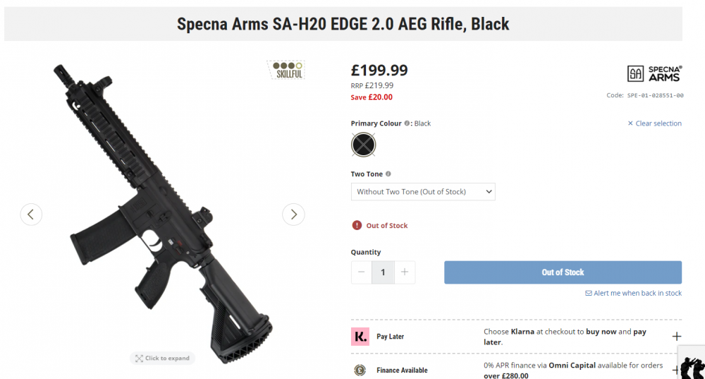

Hi everyone,
I've been looking to purchase a hk416 aeg for a while now.
I have only just discovered the Specna Arms EDGE 2.0 range. The SA-H20 seems to be coming with lots of great upgrades.
I would love to hear your thoughts on it's features.
  • GATE ASTER MOSFET
  • Build quality (supposedly metal receiver and hand guard)
  • ORION Gearbox
  • ESA2 easy spring change
  • 6.03mm high precision tight bore barrel
  • *high torque* motor
  • Steel teethed gears
  • 8mm bearings
  • comes with 2 mid cap mags
  • Rotary hop up
I am by no means a gun tech wiz, but to me this sounds too good to be true from a £200 gun??
I've seen other peoples reviews about the build quality of the gun being less that admirable, but could this be fixed with some more attention?
I really do love hk416s but i would love to avoid forking out £400 on a vfc or TM (those guns where i'd need to do a lot of upgrades). Any other suggestions on HK's?
I've included some photos below,
Thanks everyone!
