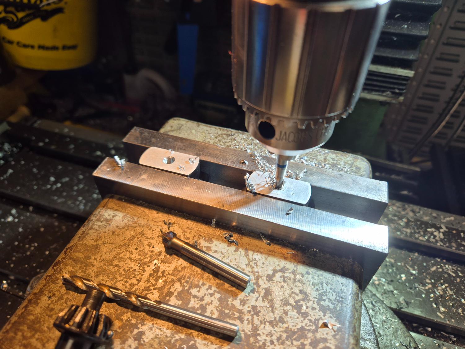

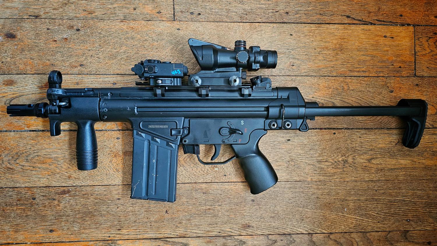

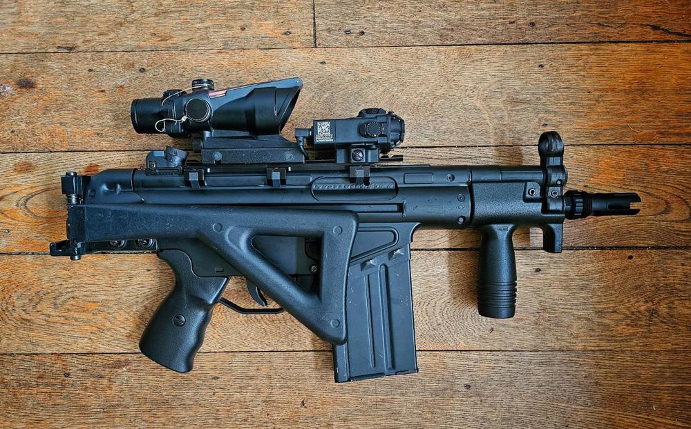

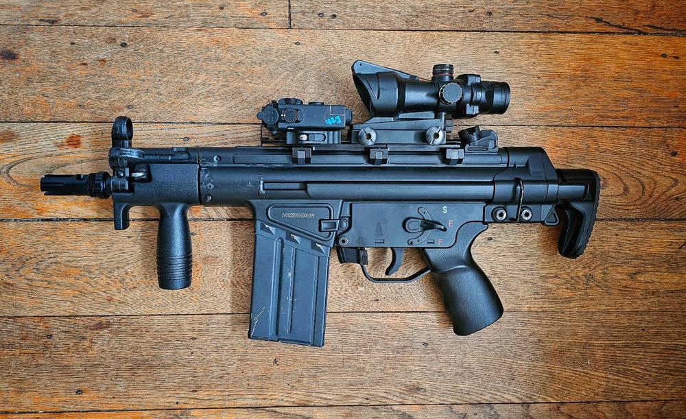

Popular Post Anonymoose Posted December 8, 2024 Popular Post Posted December 8, 2024 Little bits and pieces yesterday Modifying my G3 scope mount to delete the rail and lower the scope as much as possible. Bit of milling, drilling and tapping and got it 95% how i want. Little more needed but i'm happy with it. Then a quick job with some spare brass and delrin; a Mini Tamiya terminal remover. ButcherBill, Enid_Puceflange, ruskitseller and 3 others 6

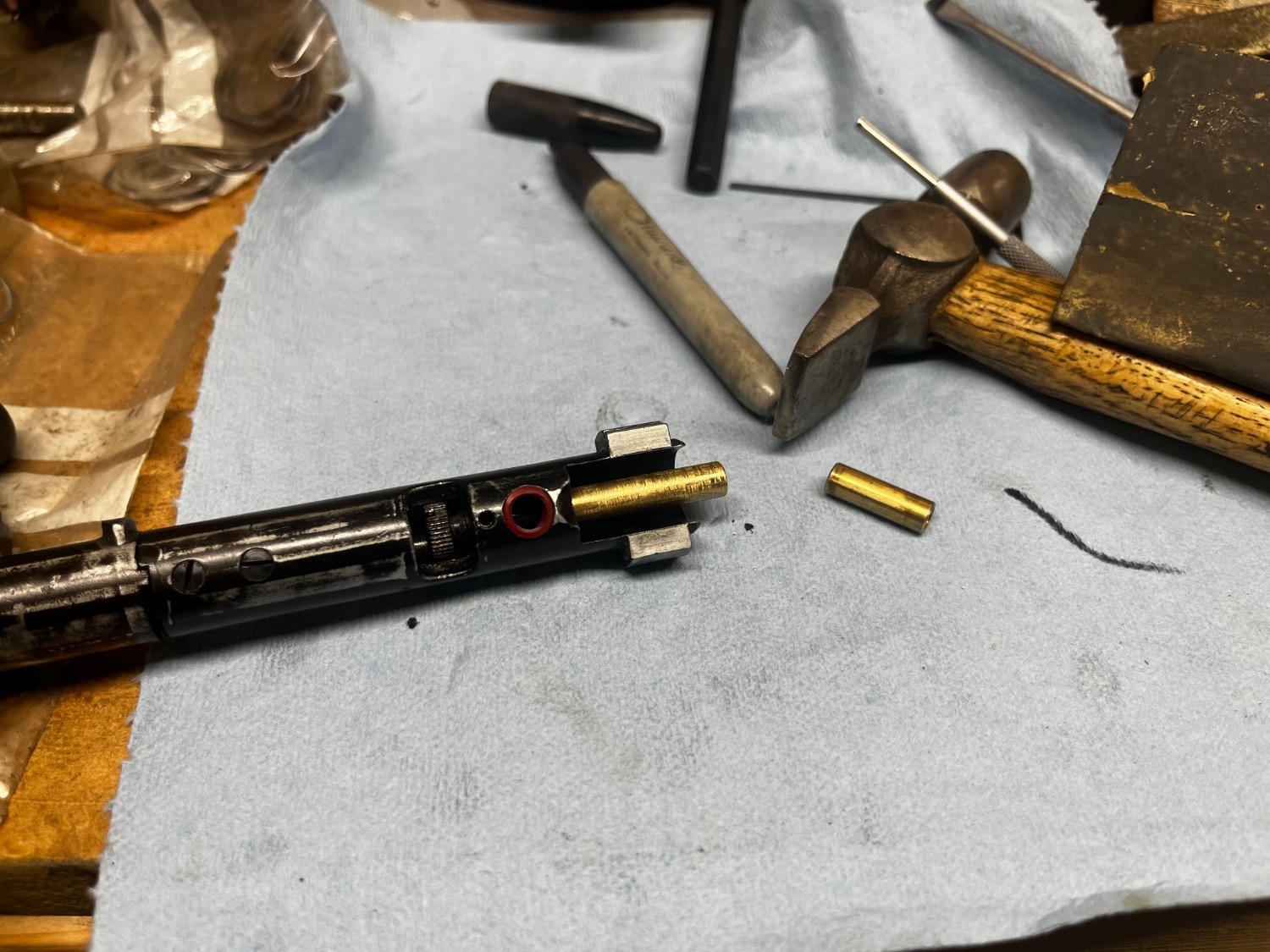

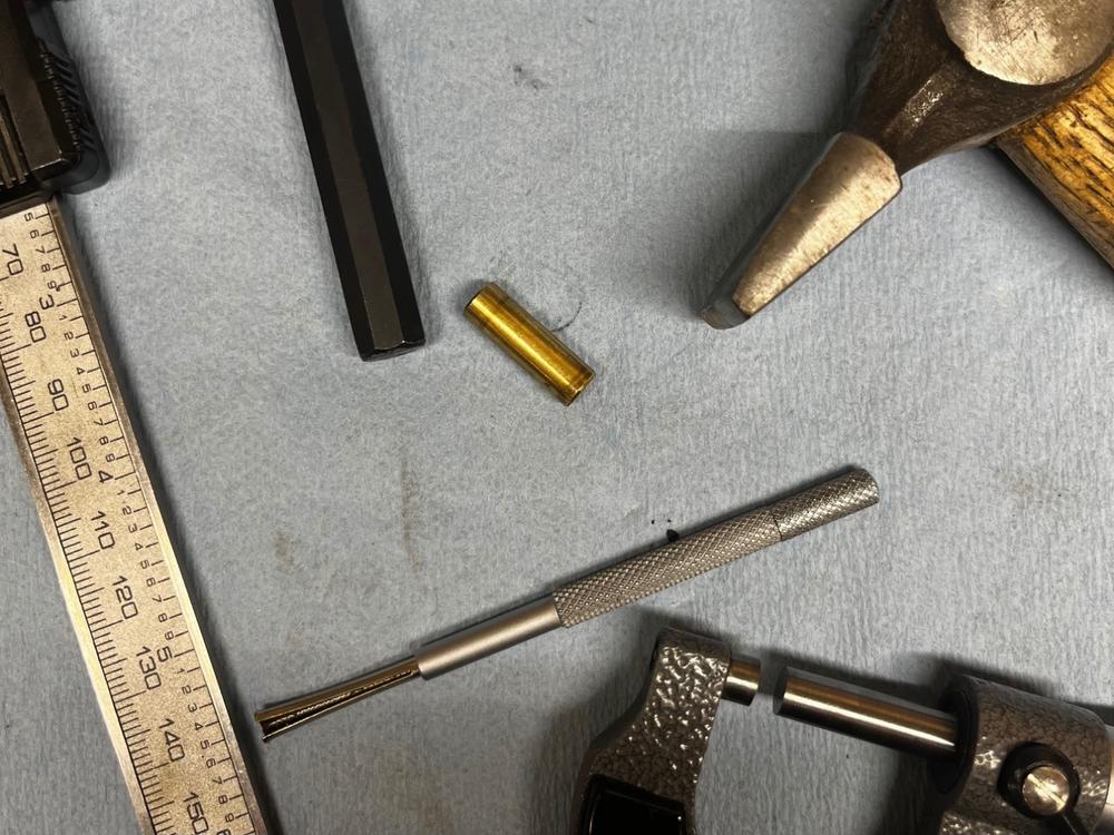

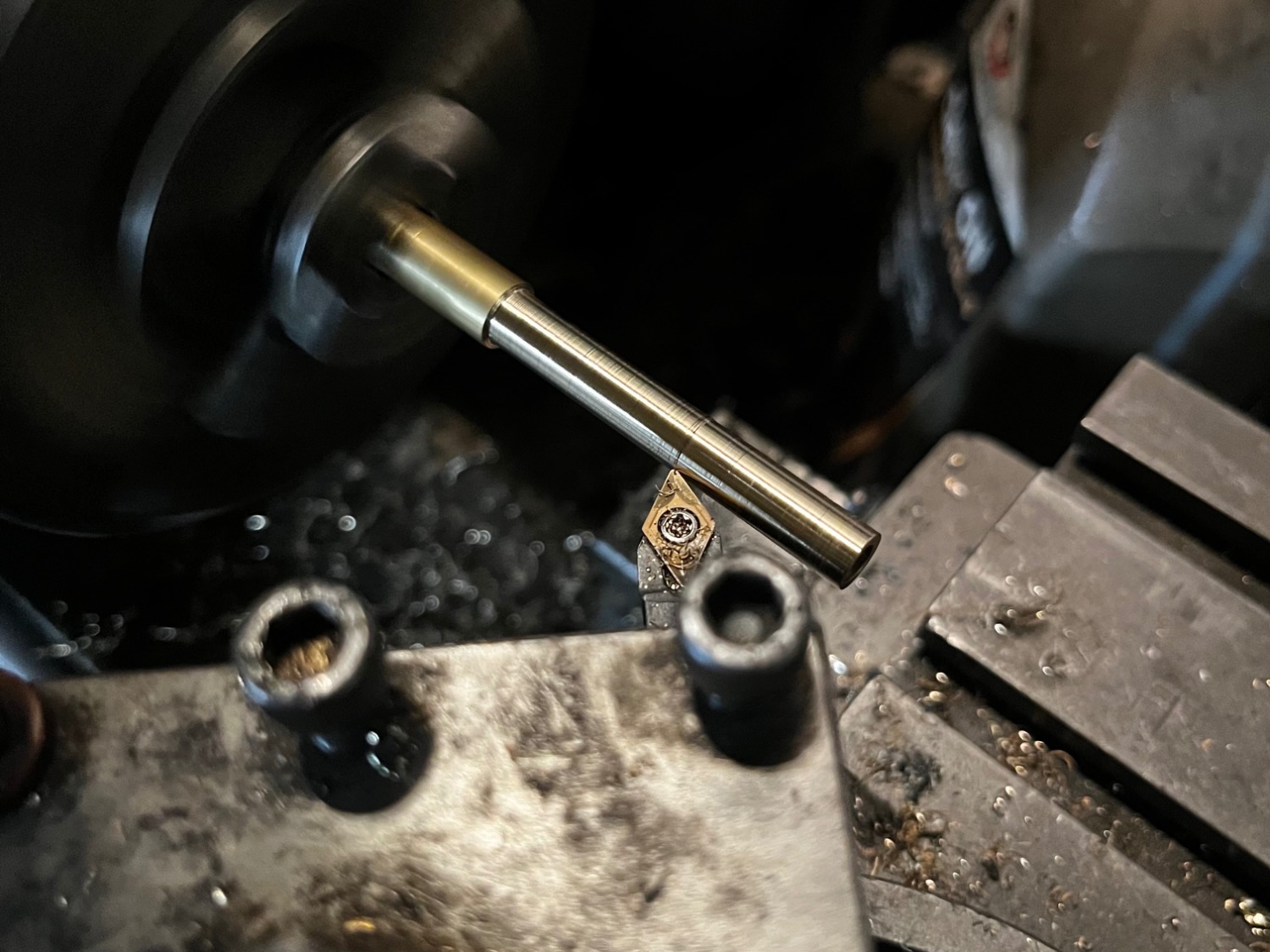

Popular Post LMKipper Posted December 14, 2024 Popular Post Posted December 14, 2024 Well one of the reasons I got my recent Tanaka was that is had a Spartan hop but for some reason, the standard nozzle. This meant it didn’t seal well with the Spartan hop, with inconsistent fps. Long out of production, someone sent me the correct length of the Spartan unit. Measured the Tanaka stocker, then whizzed this up on my lathe in 20 mins. Let’s see how it tests! Enid_Puceflange, Tackle, Anonymoose and 3 others 6

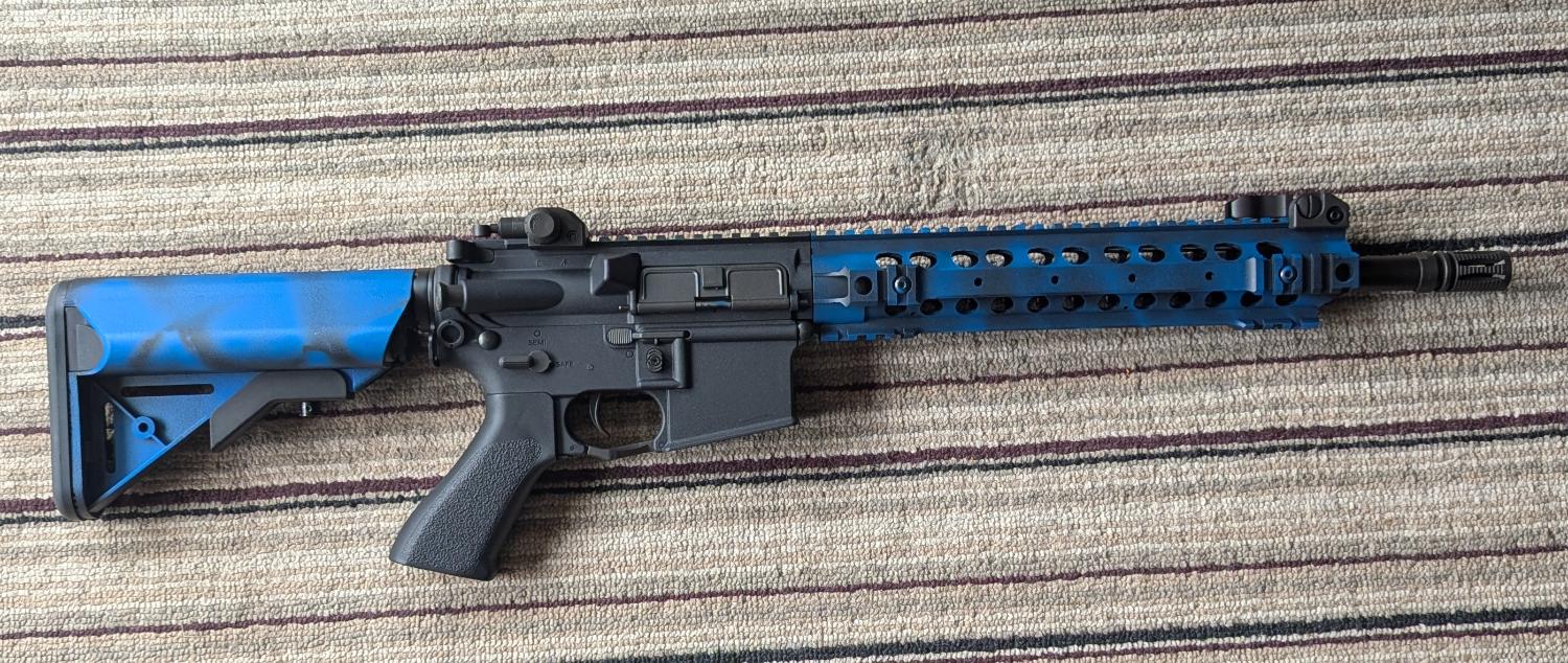

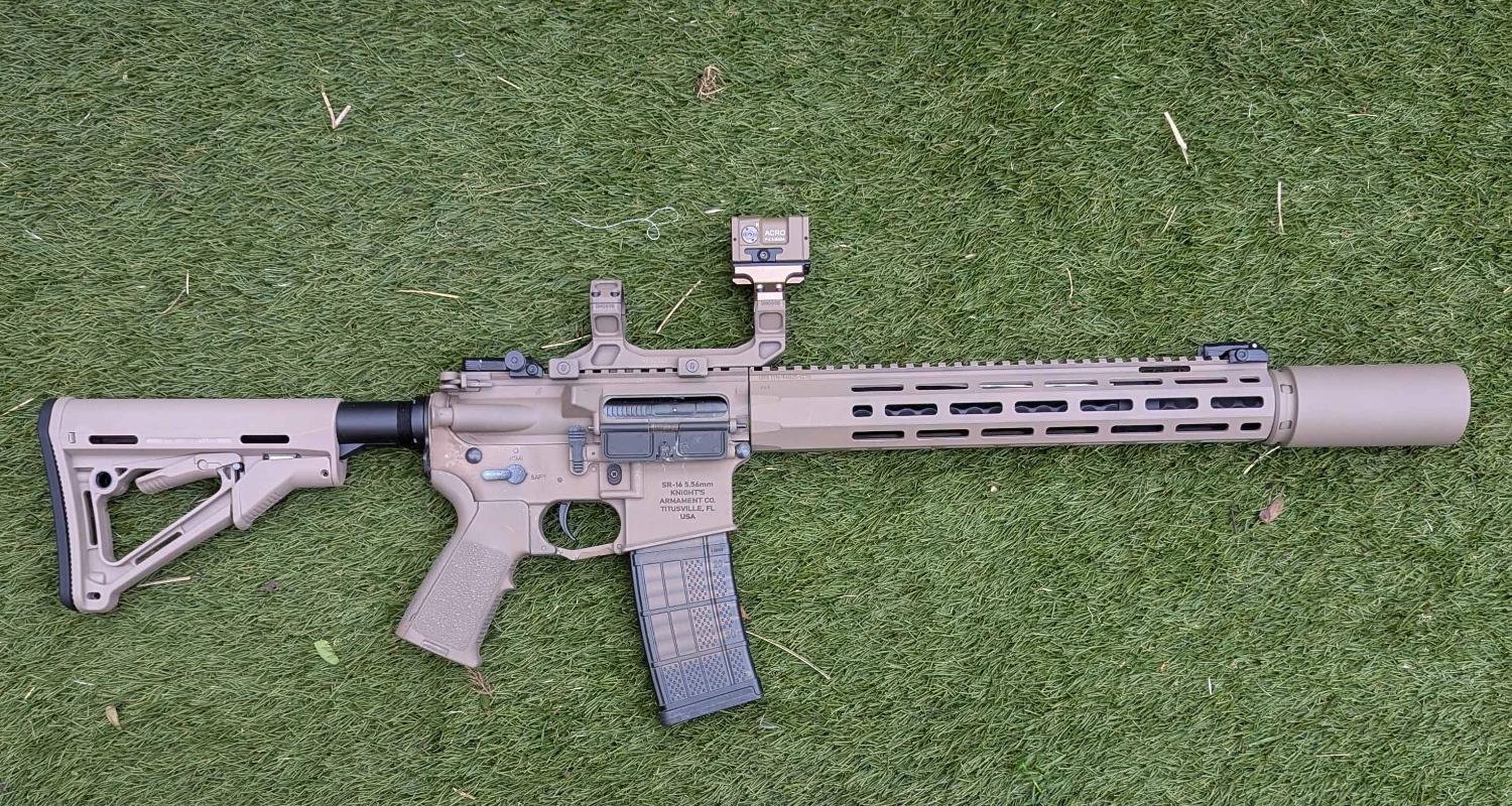

Popular Post mightyjebus Posted December 24, 2024 Popular Post Posted December 24, 2024 Not 100% finished yet as I'm waiting for a couple of parts but thought I'd share the progress so far of my KS-1. how it started. ButcherBill, Anonymoose, Diemaco and 5 others 4 4
Diemaco Posted December 24, 2024 Posted December 24, 2024 5 hours ago, mightyjebus said: Not 100% finished yet as I'm waiting for a couple of parts but thought I'd share the progress so far of my KS-1. how it started. Nice! What's the base gun?
mightyjebus Posted December 25, 2024 Posted December 25, 2024 13 hours ago, Diemaco said: Nice! What's the base gun? a CYMA SR-15

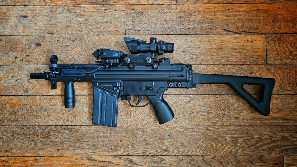

Moderators Jez_Armstrong Posted December 30, 2024 Moderators Posted December 30, 2024 Solved the long G3 top rail issue as I was finding it not only difficult to find a B&T one, they are also expensive Grabbed two long G3 rails from amazon they are about £12.99 each Cut one in half and used the acog to help clamp two together, as well as using each one to clamp to the upper ? ButcherBill and Jacob Wright 1 1
