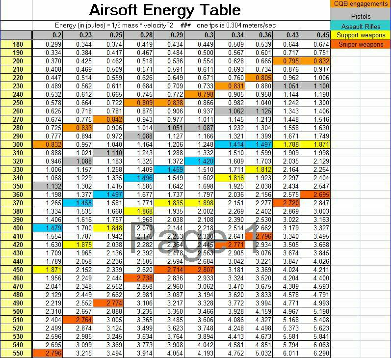

Nick G Posted February 5, 2020 Posted February 5, 2020 16 hours ago, W35TI3 said: , and yes those jules are correct exactly what the crono was saying and when testing at first I had the gun firing close to high DMR low sniper range, But those joules are not correct, so either your mate is misreading the chrono or not testing with .32s 358 fps with .32 is way past the legal limit for an AEG and is definitely not 1.28j
Supporters Rogerborg Posted February 5, 2020 Supporters Posted February 5, 2020 17 hours ago, Rogerborg said: 358 FPS at 1.28 jules with 0.32g BBS 286 FPS at 0.78 jules on 0.32g BBS To expand on the above, those Joules figures look like (but aren't quite[*]) what you'd get at 358 and 286 fps using 0.2g BBs. 0.2g is what most sites use for chronoing, and what they assume when they talk about fps limits. What they should talk about is energy limits, not fps limits. A heavier BB has more energy than a lighter BB with the same speed, right? So when they say "350fps limit", they generally mean "350fps with 0.2g which is about 1.13J". And they should say that, but often don't. But what matters is the energy, not the raw BB speed. So to be absolutely clear, if your AEG was flinging a 0.32g BB at 358fps then it wasn't just a little over the typical site limit of ~1.13J, it was way, way over at 1.9J. If it's full auto capable then it's technically not even an airsoft gun at that energy (1.3J limit for auto, 2.5J for semi/bolt), which means that (by default) it's a firearm, and a Section 5 prohibited firearm at that, which is a big no-no. It's very unlikely to be an issue, but I do want you to be aware of it. tl;dr version: if you're shooting 0.32g BBs, and your site's energy limit is the typical ~1.13J, then your muzzle velocity should be under 276fps. If your site doesn't explain this, or worse, doesn't even know it, then that's very disappointing, but sadly not unknown. [*] 358fps with 0.2g BBs, that would be ~1.18J. 286fps with 0.2g would be ~0.76J. See: http://www.asiaairsoft.com/index_topic.php?did=23&didpath=/23

Nick G Posted February 5, 2020 Posted February 5, 2020 well something is wrong 'cos a .32 BB traveling at 358 FPS isn't 1.28j No matter how convinced you are that that is what your gun was tested at those figures are impossible so either the FPS is wrong or the BB weight is wrong . Get it re tested by someone who knows what they are doing, if you are not confident to work on your own gun get it to someone who is. By the sound of it your mate hasn't got a clue, especially if he is quoting you those figures.

Nick G Posted February 5, 2020 Posted February 5, 2020 looks like he has misread his table. Assuming the FPS is correct it looks like he has still read the .20 figure. His fault if he has passed a hot gun as ok to play, but assuming your gun will still fire full auto it is way beyond the legal maximum for the UK , not good if they cant get their act together chronoing the guns , and even worse if they are allowing illegal guns to be used on site. This may be useful , still get yourself a chrono though.

Steveocee Posted February 6, 2020 Posted February 6, 2020 @W35TI3 the figures you are quoting have been notably pointed out as being wrong. You only need to google "airsoft fps bb chart" and you can prove that yourself. See my previous comment about needing to get clued up on this as if you are as warm as you say, you're using a firearm. If, not that it would likely happen, you were ever stopped, whining that "the site aid it was ok" won't keep you from getting banged up with "big jeff" and getting asked to pick that soap up. Your pistol running 350 and being a DMR? Really as the figures YOU quoted state that AEG limits are up to 360??? I'm not saying you're lying but I am saying you've got the figures wrapped round your head and maybe to take some more time at chrono station next time you're out rather than getting through as fast as you can. Understand what you fire at, both at skirmish weight and on 0.2's to help understand better.
