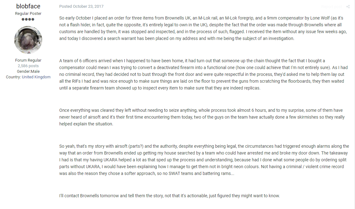

It’s a bit of an odd one this, ive ordered such things many times and been fine. However I got some magazines from the Far East on one occasion and had to make a bloody firearms declaration!
I had to do the same when I purchased a Tokyo Marui MWS part from Evike in the UK.
Took many emails back and forth to get the form filled in correctly with the people at UPS. Had to explain in detail why I wanted the part and what it would be used for. But of course the Customs people knew feck all about the workings of airsoft rifles... and so me trying to explain that it was a "lightweight bolt carrier designed to improve the cycle rate and gas efficiency" proved rather confusing for everyone involved. It did eventually get the all clear - partly because I think they gave up trying to understand what I was banging on about.

From my well documented experiences trying to get my T97 through customs. They do random searches of shipments from random countries. They'll take a huge pile of parcels coming in from one country and check them over. It is possible RIFS will go through with an expired or non existent UKARA number as they cant and don't check every parcel.
However, when they do find something in a random search, even if there is a UKARA number, they will seize it and send a notice of seizure as most 1st line officers at Dover dont know what a UKARA is and even if they did, they dont have the authorisation to release it.
It was then sent to a specialist who had firearms training (Which includes a large section on airsoft) in Birmingham. I had to ring up and re-iterate my UKARA number and the reasons why I can have the RIF and eventually it was released.
However if I did not have a UKARA. It would have been destroyed and I would have been prosecuted for attempting to bring an illegal item into the UK with no defense. Which results in a fine and/or prison sentence.
So sure, RIFS can get through without a UKARA number, but not every time. Even with a UKARA number is was pretty worrying for me! It's not worth the risk IMO.
