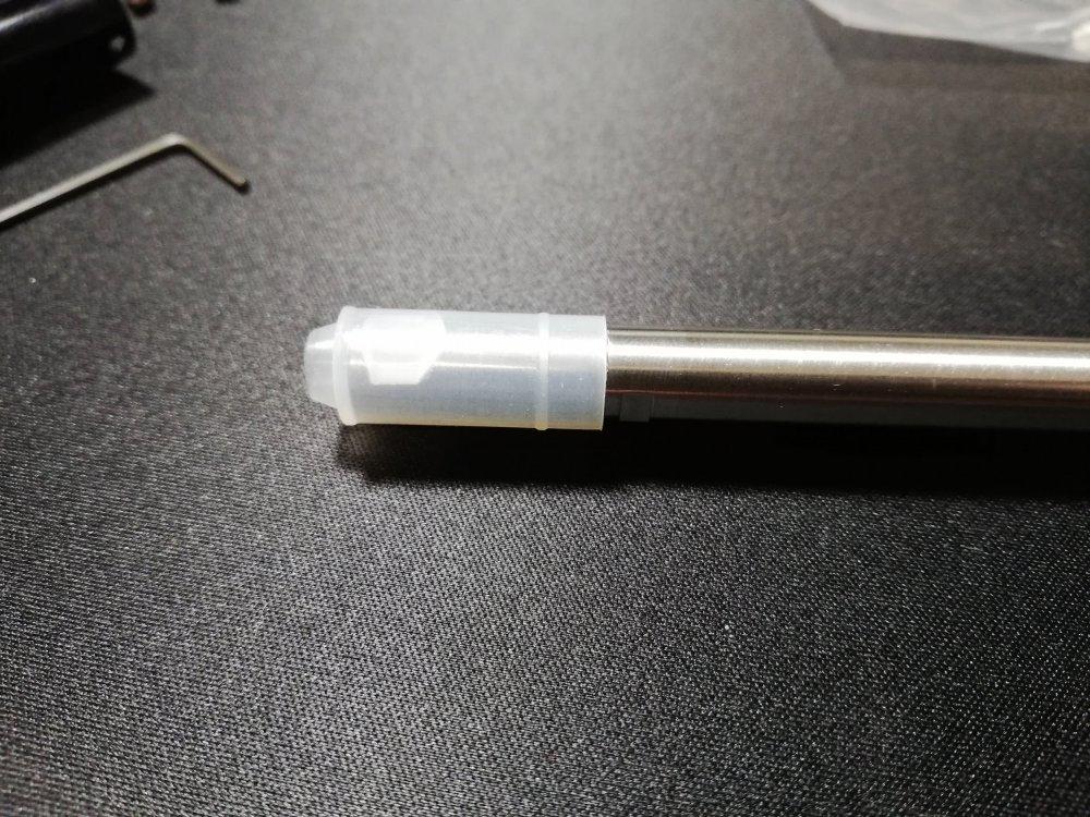

Not impressed with the R-Hop patch 😡 It seems to have torn after 2 mags through it! Has been removed and a SBA rubber put in with the Faceless barrel to see if that fairs up any better. Can't say I felt any sharp edges on the window.
I had the same, mine had a chunk missing after a couple of shots.
Out of interest what hardness patch did you get?
It was a 60 that tore, the 85 I replaced it with is holding up much better.

What nub did you use? The FOW wasn't in stock when I ordered so I went with a Stalker Tigra. I'm wondering if the pressure point was to long down the barrel as the FOW is more of a "thin" line across rather then a "pad" of pressure. I'm wondering if the Tigra applied pressure to close to the edges causing the rip.
**May have just ordered a 60, 70 and FOW as well**
Well...
I was using a stalker nub when it ripped. Definitely added to much pressure on the patch. So the nub may be common problem we had.
I then bought a fow nub and new patch.  Fow fits perfectly.

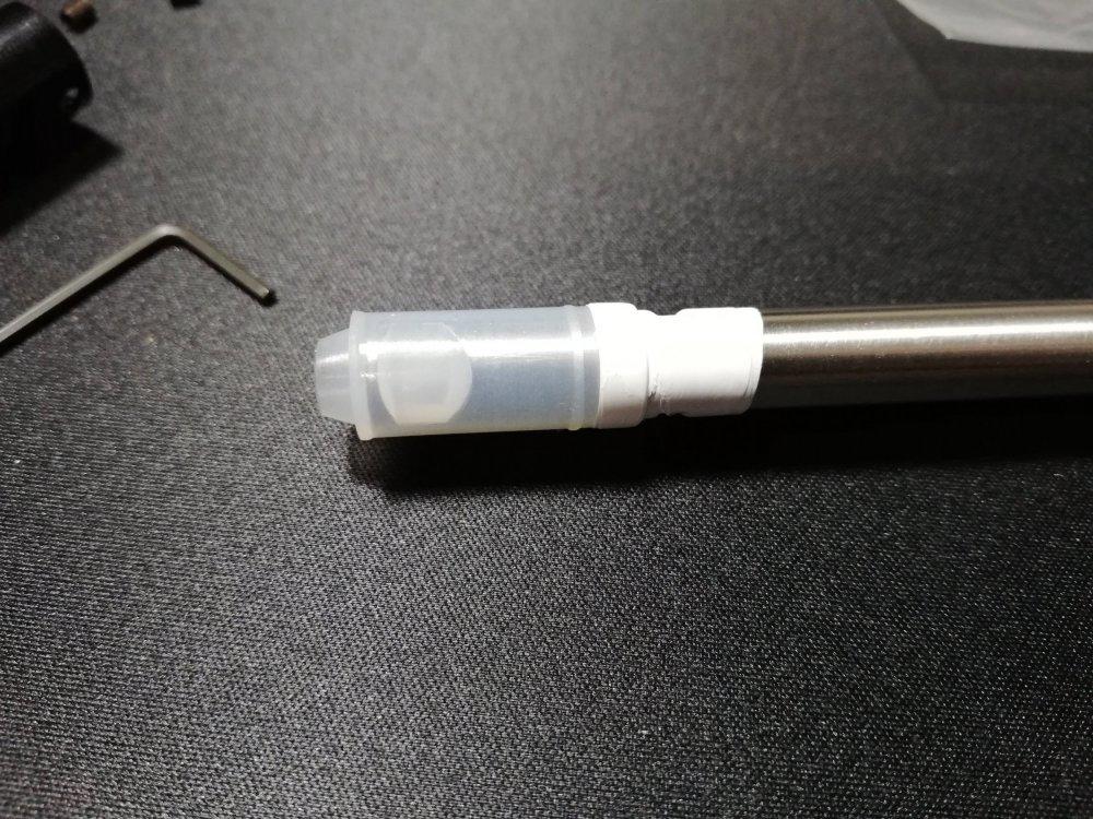

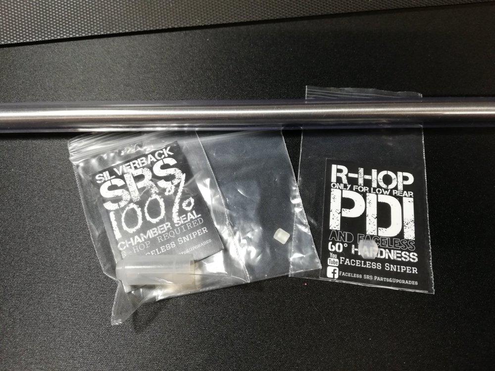

SBA fast hop chamber, FOW nub, 60 RHop and 100% Chamber seal.

Build has changed a bit from the above also. Now running PDI 6.05/380mm with faceless Rhop, FOW and 100% seal and have a Rapax 3J on order to use with long airbrake.
