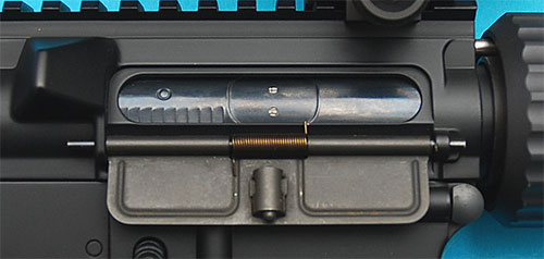

ScouseReaper Posted September 6, 2018 Posted September 6, 2018 Hi people, Hope you're all ok, I have just had my cm16 intermeadiate delivered and I'm trying to take the keymod off I followed a vid online of a similar weapon but I haven't had the result I'm after (see pics) The guns now in two parts and I thin black peice of metal fell out from somewhere while I was trying to put it back together. Can someone please let me know what the piece and where I need to put it? Also how the hell do I get this keymod off so I can put a suppressor on? Regards A stressed newbie ?
Supporters Gepard Posted September 6, 2018 Supporters Posted September 6, 2018 It's the dust cover that sits inside the receiever. When you pull back the charging handle it moves the cover, exposing the gearbox. In my experience it can be a bit of a pain to put it back in.
Iceni Posted September 6, 2018 Posted September 6, 2018 It's a cover for the gearbox. Totally non essential. It should be sat on a slide above the gearbox so it can be viewed through the ejection port. Personally I remove them and flip the spring on the cover. This means the cover is always closed and you have to get a finger nail on it to open it. But it also means water and dirt has a harder time getting into the hop area.
