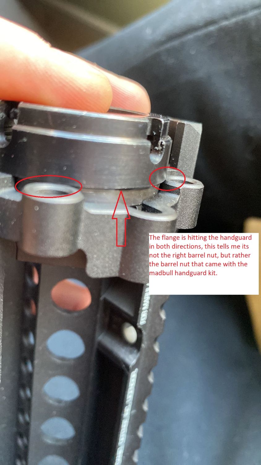

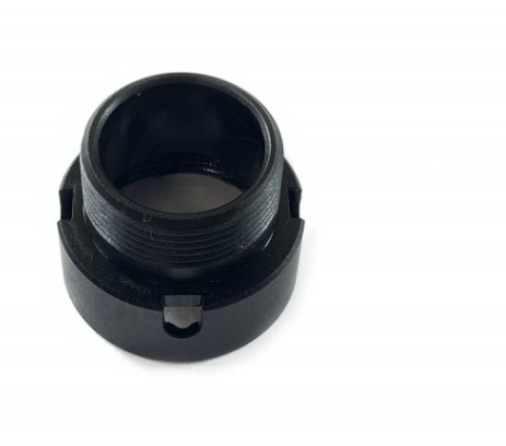

AlgebraMWS Posted April 26, 2023 Posted April 26, 2023 (edited) Hey guys anyone had luck with installing a Tokyo Marui MK18 hanguard (M4/HK416 NEXT GENERATION) from an AEG to an unmodded original barrel on a TM MWS? I am curious to see if it is possible with modifications. I was stupid enough to think it would fit directly, I've bought the part second hand from online. I suspect the seller sent me a MADBULL barrel nut with an OEM Tokyo Marui MK18 AEG handguard as the parts don't physically fit.. Upon checking the website of MADBULL, its evident that the rail is OEM TM and the barrel nut is a MADBULL. I've looked up the OEM TM MK18 AEG barrel nut and it has two threaded parts, so I suspect this would solve my issues, by using the new barrel nut with the Madbull barrel nut. EDIT:// I guess I will have to source TM MK18 GBB parts, since the handguard seems to be the same on AEG and GBB MK18s, with similar connection methods. Anyone has good suggestions for the TM MK18 GBBR barrel nuts? I need two. Any help or website suggestions for aftermarket or OEM TM parts will be helpful! So now I am wondering if I could attach a TM MK18 AEG Barrel nut (AN: NGM4-502) on the TM MWS UPPER reciever so that I could attach the TM MK18 AEG handguard. Edited April 26, 2023 by AlgebraMWS
Wavey_Gravey Posted April 26, 2023 Posted April 26, 2023 Not sure about marui handguards but most AEG rails need a spacer. You will need a spacer with Madbull handguards too, unless you use an aftermarket outer barrel. Also, im no expert having only looked at a Mk18 rail once previously, but you have that barrel nut the wrong way round in your photo? Smaller end should sit inside the rail.
AlgebraMWS Posted April 26, 2023 Posted April 26, 2023 The barrel nut came from a madbull handguard, the seller kept the OEM TM barrel nuts, hence why it doesnt fit, lol fml... I think I figured it out, I will need to buy the TM MK18 GBB barrel nuts and install it on the MWS. jackd787 1
Cipher-032 Posted April 30, 2023 Posted April 30, 2023 On 26/04/2023 at 14:21, AlgebraMWS said: The barrel nut came from a madbull handguard, the seller kept the OEM TM barrel nuts, hence why it doesnt fit, lol fml... I think I figured it out, I will need to buy the TM MK18 GBB barrel nuts and install it on the MWS. If its a struggle, I do have a complete Madbull Mk18 handguard set up which I ran on my MWS for a little while All you need is either a barrel adapter or a different outer barrel, like the laylax modular one.
