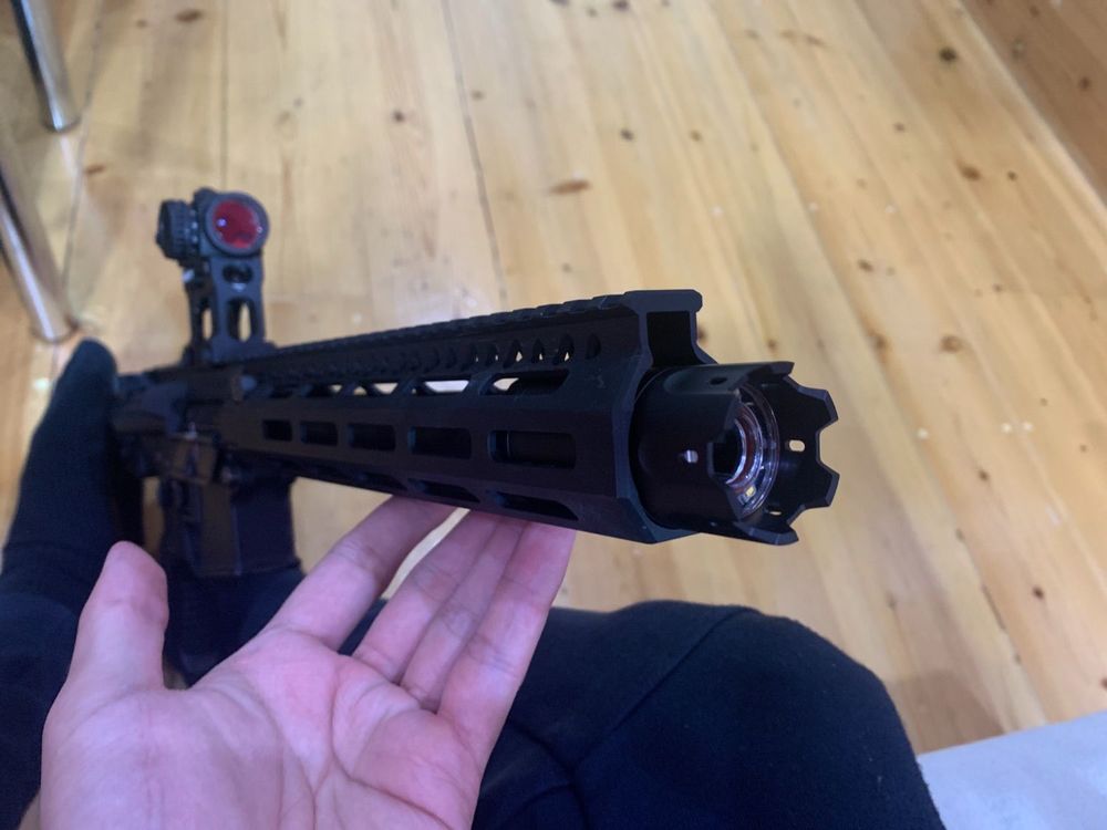

reddotscope7 Posted August 21, 2021 Share Posted August 21, 2021 (edited) Hello everybody, I'm looking to make an integrally suppressed build, something like this https://www.silencershop.com/sig-sur300-suppressed-upper.html,(I don't have that kind of budget of course), with a 9 inch outer barrel, suppressor and handguard with the ideal sizes but I do not know where to start, any ideas? Also Thank you! Edited August 21, 2021 by reddotscope7 Link to comment Share on other sites More sharing options...
SSPKali Posted August 22, 2021 Share Posted August 22, 2021 (edited) On 21/08/2021 at 22:07, reddotscope7 said: Hello everybody, I'm looking to make an integrally suppressed build, something like this https://www.silencershop.com/sig-sur300-suppressed-upper.html,(I don't have that kind of budget of course), with a 9 inch outer barrel, suppressor and handguard with the ideal sizes but I do not know where to start, any ideas? Also Thank you! Expand I would start with selecting a hand guard and measuring the internal diameter and then working from there as that will dictate the suppressor diameter. You will also need to check the length of the hand guard vs barrel and see what overlap you need. Edited August 22, 2021 by SSPKali Link to comment Share on other sites More sharing options...
ajumma Posted August 22, 2021 Share Posted August 22, 2021 On 21/08/2021 at 22:07, reddotscope7 said: Hello everybody, I'm looking to make an integrally suppressed build, something like this https://www.silencershop.com/sig-sur300-suppressed-upper.html,(I don't have that kind of budget of course), with a 9 inch outer barrel, suppressor and handguard with the ideal sizes but I do not know where to start, any ideas? Also Thank you! Expand SSPKali pretty much answered this already. I can say that if you want to use a tracer unit, this kind of build can be really effective as you can tuck the tracer into the handguard and avoid that extra 3-4 inches of length. I’ve done that with my Angrygun mcmr and acetech blaster. SSPKali 1 Link to comment Share on other sites More sharing options...
reddotscope7 Posted August 22, 2021 Share Posted August 22, 2021 @SSPKali @ajumma Alright thank you both! I'll try and build onto the standart barrel of the cqbr and research some handguards. Link to comment Share on other sites More sharing options...

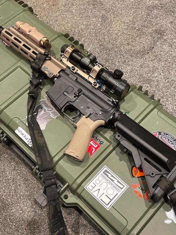

MalcyFett Posted September 2, 2021 Share Posted September 2, 2021 Ordered a mk16 rail from Hao directly, took a week to arrive from Taiwan. Finally got the guts to open up the mws, installed a sixg brass nub and fitted the new rail (not too bad to fit, even for a complete novice with gbbrs). Really happy with how it’s looking now. lokkers and C-Diddy 2 Link to comment Share on other sites More sharing options...
Whereismyhammer Posted September 3, 2021 Share Posted September 3, 2021 On 02/09/2021 at 20:56, Davegolf said: Or the mag case itself gets bent in stopping it from working. @Whereismyhammer is your gun internally standard otherwise? Expand It is and thanks for the mag advice folks I will look into it Link to comment Share on other sites More sharing options...
C-Diddy Posted September 3, 2021 Share Posted September 3, 2021 (edited) On 02/09/2021 at 21:26, MalcyFett said: Ordered a mk16 rail from Hao directly, took a week to arrive from Taiwan. Finally got the guts to open up the mws, installed a sixg brass nub and fitted the new rail (not too bad to fit, even for a complete novice with gbbrs). Really happy with how it’s looking now. Expand Looking good 👍🏼 My Hao rail has just been delivered after ordering it in May, so looking forward to getting it fitted. Did you need any barrel shims or is it a good fit? Edited September 3, 2021 by C-Diddy Added image AlphaBear 1 Link to comment Share on other sites More sharing options...
MalcyFett Posted September 3, 2021 Share Posted September 3, 2021 On 03/09/2021 at 09:21, C-Diddy said: Looking good 👍🏼 My Hao rail has just been delivered after ordering it in May, so looking forward to getting it fitted. Did you need any barrel shims or is it a good fit? Expand Went straight on. Probably about as easy as changing a ris rail would ever be. There was a shim that came with the barrel nut (which I’d not noticed when I opened the box, and had lost, for a bit). Once you’ve got the gold coloured shim on, the nut screws straight on and then you slip the rail over it. Tighten the grub screws and push the two bolts in. It was pretty easy. Worst thing for me was disassembling the mws itself, everything was threadlocked so needed a bit of welly to get it all apart. Link to comment Share on other sites More sharing options...
C-Diddy Posted September 3, 2021 Share Posted September 3, 2021 On 03/09/2021 at 09:35, MalcyFett said: Went straight on. Probably about as easy as changing a ris rail would ever be. There was a shim that came with the barrel nut (which I’d not noticed when I opened the box, and had lost, for a bit). Once you’ve got the gold coloured shim on, the nut screws straight on and then you slip the rail over it. Tighten the grub screws and push the two bolts in. It was pretty easy. Worst thing for me was disassembling the mws itself, everything was threadlocked so needed a bit of welly to get it all apart. Expand That's good to hear. Already had my MWS apart to fit the brass nub, so I'm good to go I think. Mine wasn't threadlocked or if it was my heavy handedness has been an advantage for a change. Just need some M-lok bits and bobs now. Link to comment Share on other sites More sharing options...

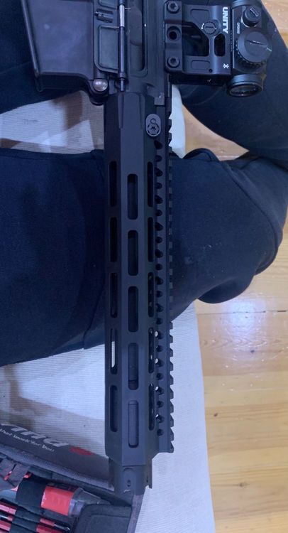

C-Diddy Posted September 3, 2021 Share Posted September 3, 2021 Hao MK16 rail all fitted and a piece of piss it was too. However, this gap is frickin annoying Link to comment Share on other sites More sharing options...
