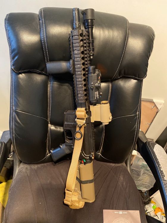

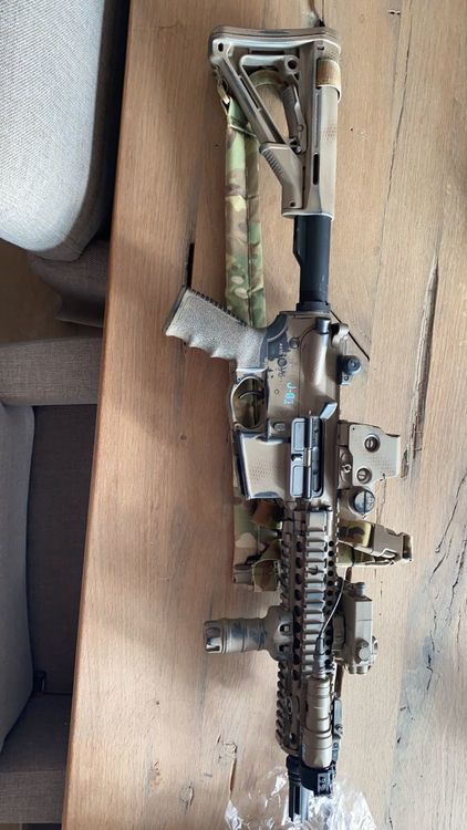

rj1986 Posted August 14, 2021 Posted August 14, 2021 Part of the gang. Now to get nubs and print a speed loader, and cut the gas tubes
Davegolf Posted August 14, 2021 Posted August 14, 2021 You going to print one that covers the whole of the top of the mag?

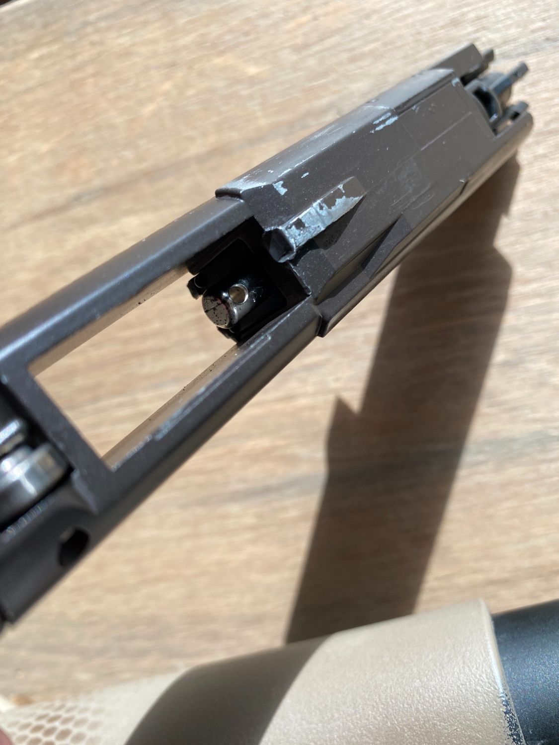

Joe142 Posted August 15, 2021 Posted August 15, 2021 Hi all, anyone run the G&P bolt carrier group? I’ve used it and love it but it’s only really good for my dmr setup I’m building as when installed I get 1.55J output, when the stock bolt is in it drops significantly to around 1/1.1J, not sure if anyone else has had that with theirs? Also anyone got any experience with the RA tech NPAS?

SSPKali Posted August 16, 2021 Posted August 16, 2021 10 hours ago, Joe142 said: Hi all, anyone run the G&P bolt carrier group? I’ve used it and love it but it’s only really good for my dmr setup I’m building as when installed I get 1.55J output, when the stock bolt is in it drops significantly to around 1/1.1J, not sure if anyone else has had that with theirs? Also anyone got any experience with the RA tech NPAS? Others have found that it gives higher power. I have used a RA Tech NPAS in a TM nozzle / bolt and found it pretty good at dropping the FPS. You need the black one, as the silver (WE) one is too fat to fit. I would check what is in the G&P nozzle to start with as they might have used the 3 position valve stopper (or get one for £9 from Firesupport) as this can be used to alter the FPS too. 9 hours ago, Jan Mulder said: hey i'm new here. does anyone have a spare bolt? for sale? Does anyone have any tips on how I can best use a mws for milsim? And do I need to bring any spare parts? I now use aeg but was still looking for more realism. I did the green gas mod. have 6 mags. A spare nozzle and nozzle spring would be the minimum, I usually take a spare complete nozzle (easier to swap out) or complete bolt (even faster to change) Other than that taking the AEG as insurance might be a good move. I have found the MWS to be very reliable but if you have travelled to the other end of the country and still have 23hrs of game play left if would suck to not have a rifle! Joe142 1
Jan Mulder Posted August 16, 2021 Posted August 16, 2021 1 hour ago, SSPKali said: Others have found that it gives higher power. I have used a RA Tech NPAS in a TM nozzle / bolt and found it pretty good at dropping the FPS. You need the black one, as the silver (WE) one is too fat to fit. I would check what is in the G&P nozzle to start with as they might have used the 3 position valve stopper (or get one for £9 from Firesupport) as this can be used to alter the FPS too. A spare nozzle and nozzle spring would be the minimum, I usually take a spare complete nozzle (easier to swap out) or complete bolt (even faster to change) Other than that taking the AEG as insurance might be a good move. I have found the MWS to be very reliable but if you have travelled to the other end of the country and still have 23hrs of game play left if would suck to not have a rifle! Is the angry gun bolt carrier group any good? I’ve searched everywere forma stock tm bolt.
Joe142 Posted August 16, 2021 Posted August 16, 2021 5 hours ago, Jan Mulder said: Is the angry gun bolt carrier group any good? I’ve searched everywere forma stock tm bolt. I’ve not heard very brilliant things about angry gun but haven’t tried any of their parts personally, I’ve just been told by a few to stay clear, personally I love the g&p bolt carrier, not had any problems with it yet but as I say it does increase FPS quite considerably in my case so may need an npas to make it site legal 7 hours ago, SSPKali said: 18 hours ago, Joe142 said: Others have found that it gives higher power. I have used a RA Tech NPAS in a TM nozzle / bolt and found it pretty good at dropping the FPS. You need the black one, as the silver (WE) one is too fat to fit. I would check what is in the G&P nozzle to start with as they might have used the 3 position valve stopper (or get one for £9 from Firesupport) as this can be used to alter the FPS too. Awesome thank you buddy I’ll take apart the g&p and take a closer look at the parts inside, I don’t believe it has a valve stopper but I’ll take a look, can the valve stopper be adjusted to do the same job as an Npas?

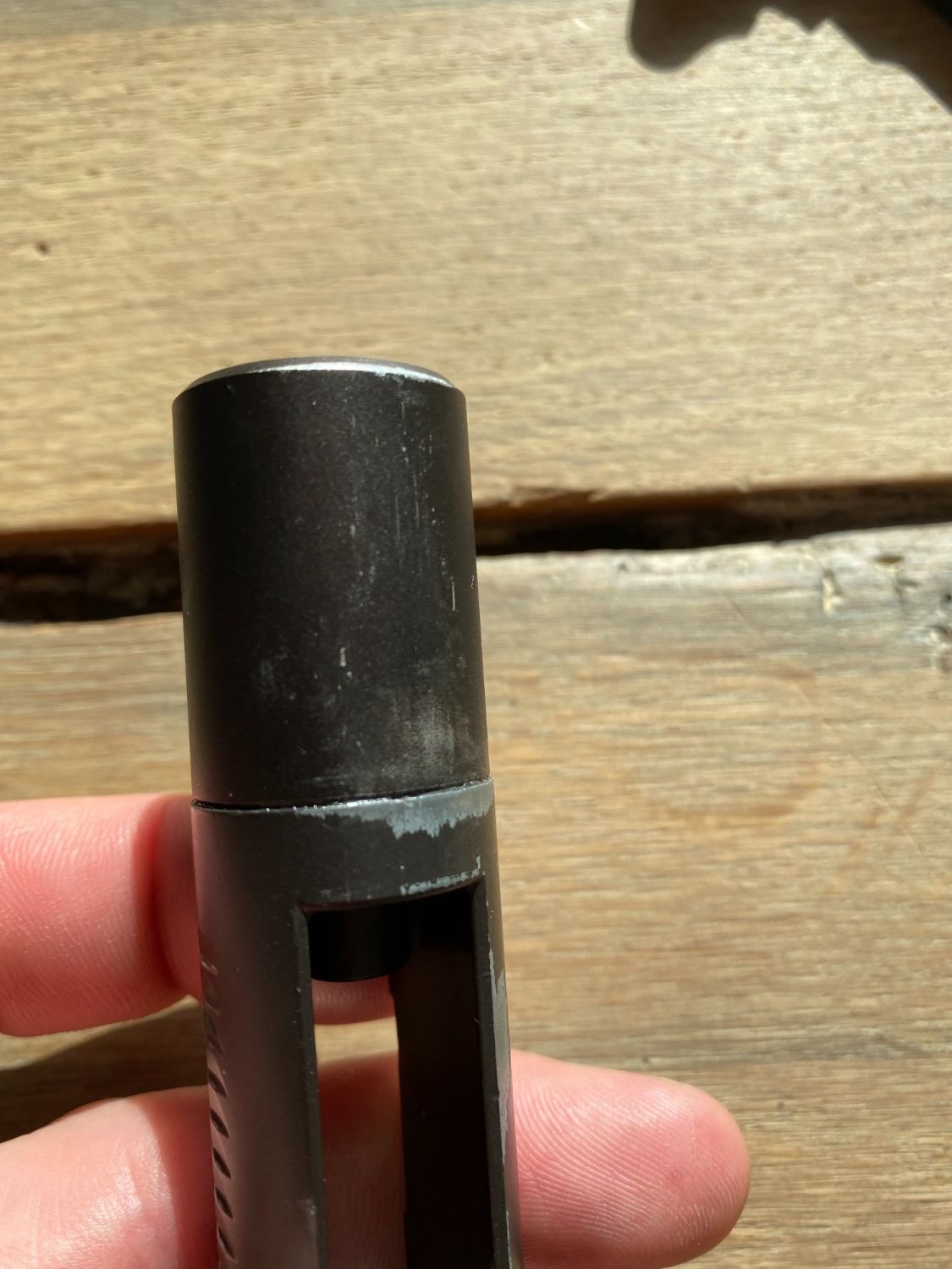

TadsJ2 Posted August 16, 2021 Posted August 16, 2021 (edited) Probably not on the current topic, but how long does the gas route seal hold? mine is starting to wear down and i can see some damage on it... is it normal? is there anything to be done apart from changing it? is my G&P nozzle causing this? Also should i order RIW T8 mag gaskets (cant find TM's anywhere in stock) for replacement ? Edited August 16, 2021 by TadsJ2

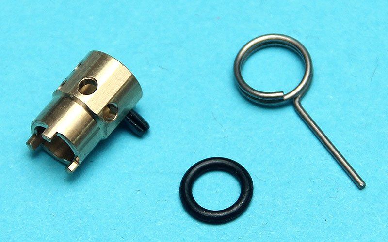

SSPKali Posted August 16, 2021 Posted August 16, 2021 1 hour ago, Joe142 said: I’ve not heard very brilliant things about angry gun but haven’t tried any of their parts personally, I’ve just been told by a few to stay clear, personally I love the g&p bolt carrier, not had any problems with it yet but as I say it does increase FPS quite considerably in my case so may need an npas to make it site legal Awesome thank you buddy I’ll take apart the g&p and take a closer look at the parts inside, I don’t believe it has a valve stopper but I’ll take a look, can the valve stopper be adjusted to do the same job as an Npas? The G&P adjustable stop has 3 different holes for the thin cross screw so it adjusts how far forward the valve sits and thus the power. I was getting 180fps / 260fps / 290fps on green gas and 0.30g BBs at 18degC on the low/mid/high settings IIRC. Stock TM bolt/nozzle/etc Joe142 1

Joe142 Posted August 16, 2021 Posted August 16, 2021 23 minutes ago, SSPKali said: The G&P adjustable stop has 3 different holes for the thin cross screw so it adjusts how far forward the valve sits and thus the power. I was getting 180fps / 260fps / 290fps on green gas and 0.30g BBs at 18degC on the low/mid/high settings IIRC. Stock TM bolt/nozzle/etc Amazing thank you, I’ll take the bolt apart hopefully tonight and investigate further, do you have any pics of the adjustable stop at all? If not it’s no dramas just would be good to have something for reference ? don’t worry if not though, wouldn’t want you to go out your way to take any ?
Davegolf Posted August 16, 2021 Posted August 16, 2021 1 hour ago, TadsJ2 said: Probably not on the current topic, but how long does the gas route seal hold? mine is starting to wear down and i can see some damage on it... is it normal? is there anything to be done apart from changing it? is my G&P nozzle causing this? Also should i order RIW T8 mag gaskets (cant find TM's anywhere in stock) for replacement ? How many rounds are we looking at on those gas routes? It does look like the G&P nozzle rides lower, but in a wierd way, do you have a pic of the G&P nozzle / gas route mating face? I would stick to TM gas routes, put a request in with Impulse101 and they will order in.
SSPKali Posted August 16, 2021 Posted August 16, 2021 11 minutes ago, Joe142 said: Amazing thank you, I’ll take the bolt apart hopefully tonight and investigate further, do you have any pics of the adjustable stop at all? If not it’s no dramas just would be good to have something for reference ? don’t worry if not though, wouldn’t want you to go out your way to take any ? The three prongs and 3 different screw holes (can see 2 in pic, at different levels) are a dead give away. https://www.fire-support.co.uk/product/gp-marui-mws-gbb-adjustable-piston-valve
TadsJ2 Posted August 16, 2021 Posted August 16, 2021 (edited) 27 minutes ago, Davegolf said: How many rounds are we looking at on those gas routes? It does look like the G&P nozzle rides lower, but in a wierd way, do you have a pic of the G&P nozzle / gas route mating face? I would stick to TM gas routes, put a request in with Impulse101 and they will order in. >How many rounds - hard to say... lets say a 1000each Wrote a request to Impulse101... Well i measured the TM og nozzle and G&P nozzle's this part Seems that G&P nozzle is a little bit more protruding -> so i've sanded it a little I will try to make a photo, but its sanded already Sorry if this is not the angles you wanted to see, should i try to photo it from a different angle ? Edited August 16, 2021 by TadsJ2
Davegolf Posted August 16, 2021 Posted August 16, 2021 Thats what i thought, its the BB loader thats damaging the gas routes on the G&P nozzle, sand it back so it matches the height of the TM nozzle TadsJ2 1
TadsJ2 Posted August 16, 2021 Posted August 16, 2021 50 minutes ago, Davegolf said: Thats what i thought, its the BB loader thats damaging the gas routes on the G&P nozzle, sand it back so it matches the height of the TM nozzle thank you Dave

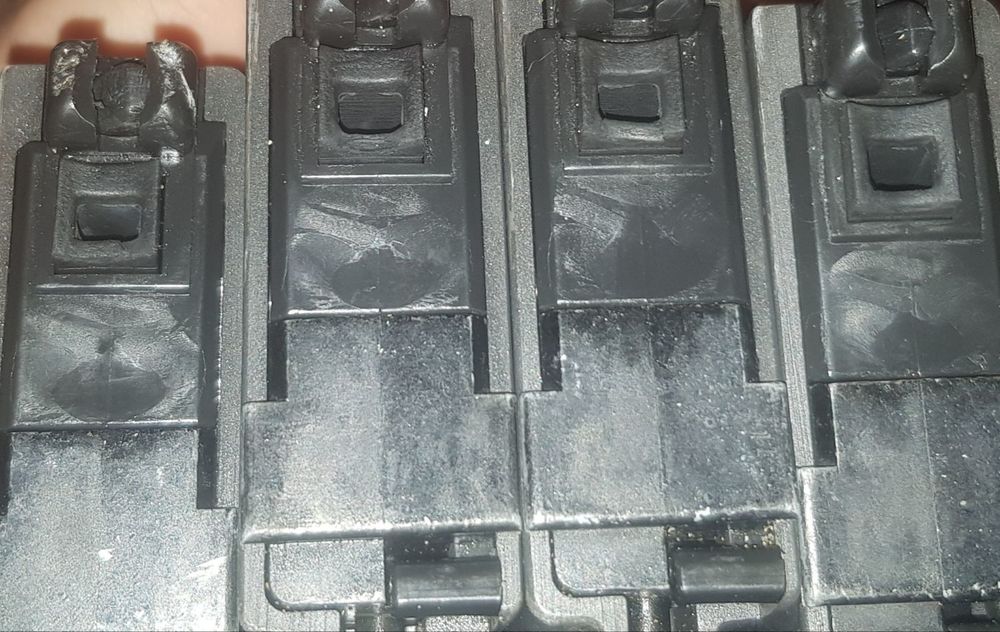

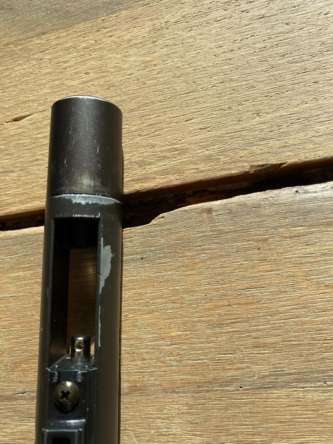

Jan Mulder Posted August 17, 2021 Posted August 17, 2021 (edited) Is this wear normal? Ive used Some redgas. But now i only use propane. Edited August 17, 2021 by Jan Mulder
Cyberlawyer Posted August 17, 2021 Posted August 17, 2021 Yes this is absolutely normal after enough rounds. red gas will just speed up the process.
