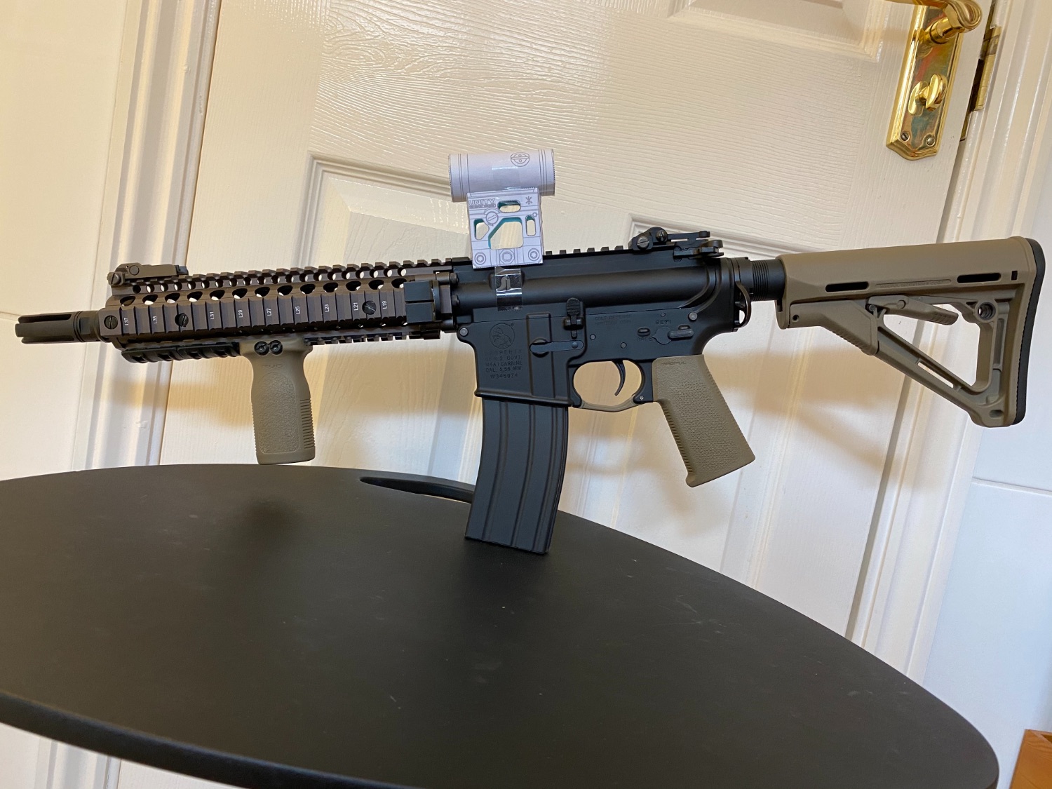

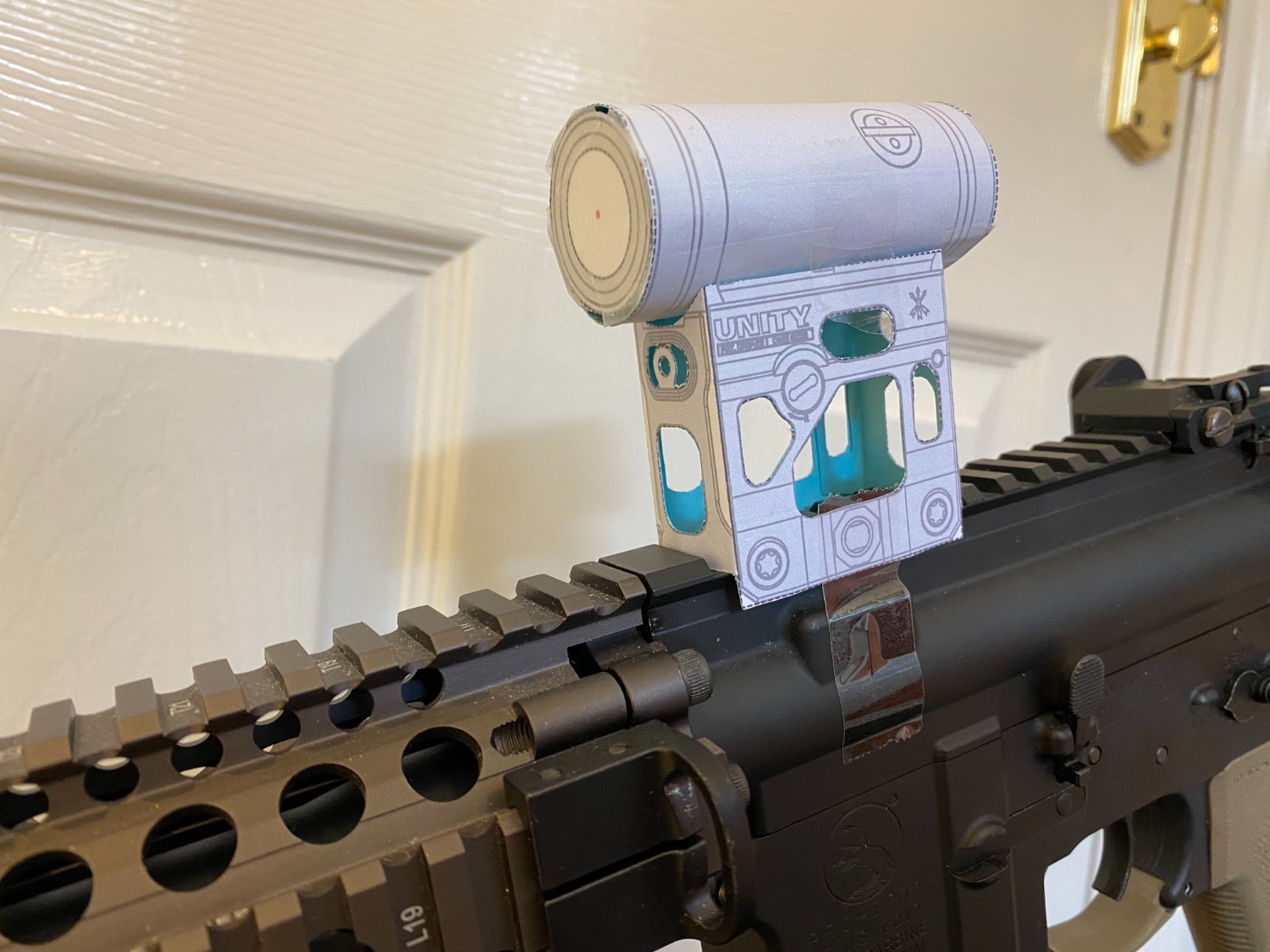

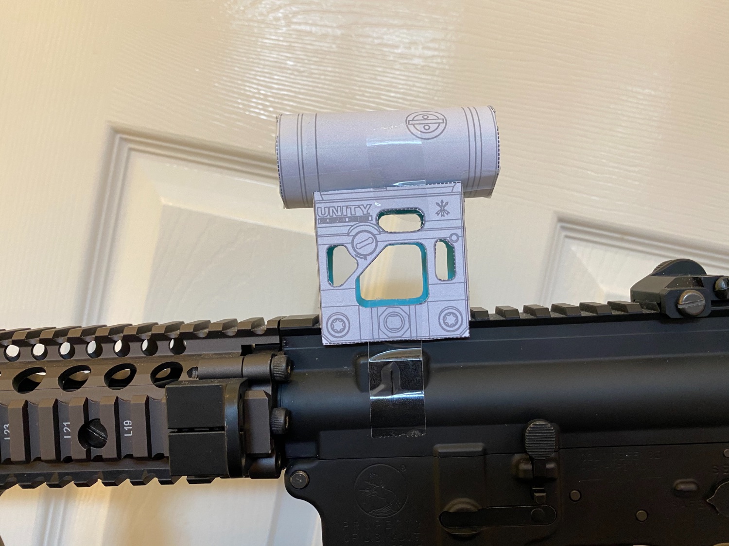

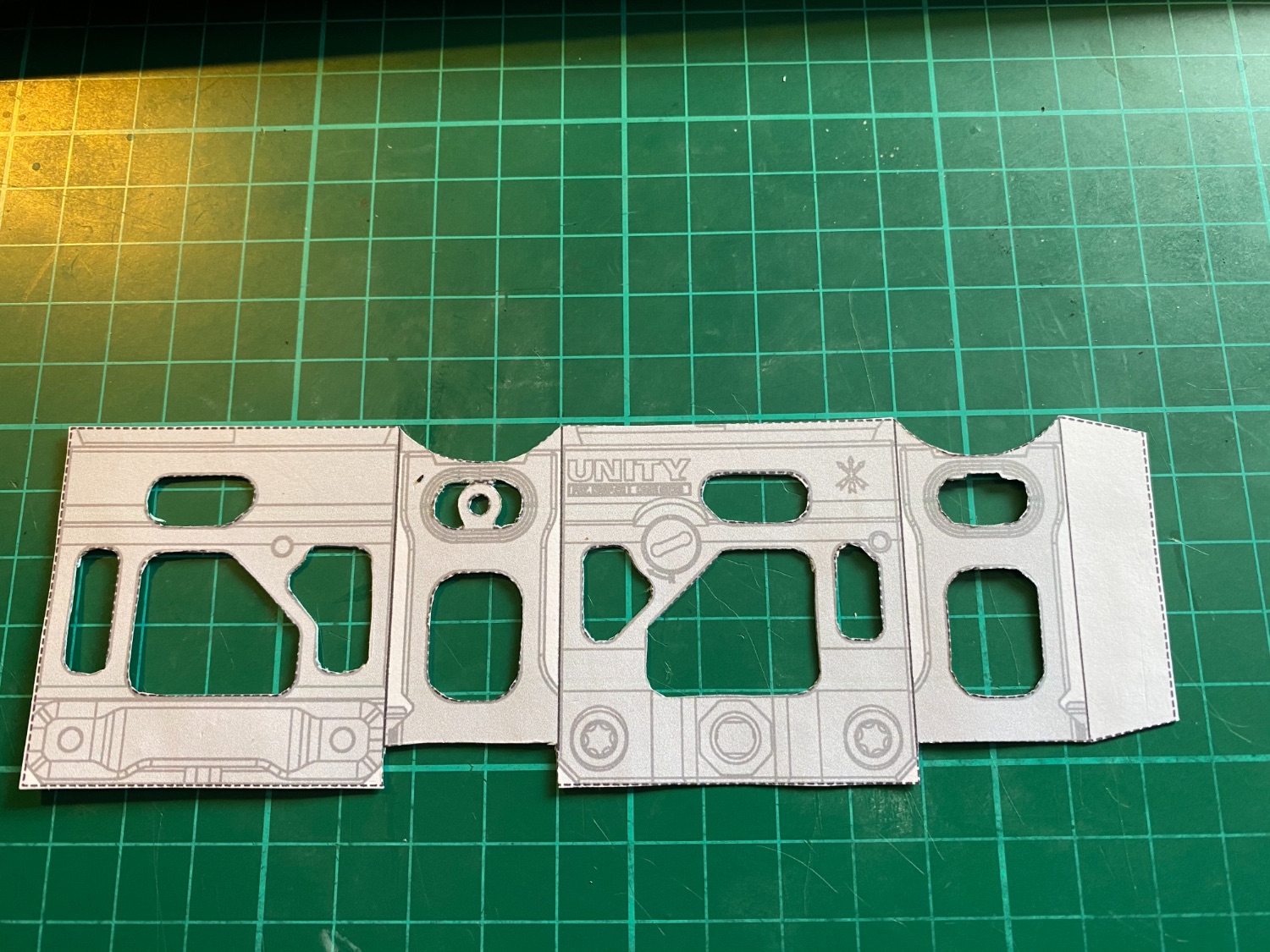

AlphaBear Posted May 13, 2021 Posted May 13, 2021 (edited) I’ve been having way too much fun here. Let me explain...... So, I wanted to try out a Unity mount on the MWS and wasn’t sure if I’d want to spend £200 on the real deal. I mean what if I didn’t like it? It’s a lot of money to spend on a real steel mount especially if you don’t like it afterwards. So fortunately Unity provide a template which you can download and create a mock up model of the mount. So guess what I did. Yup. Craft time ? Whatcha think fellas? Cerakote it? ?. On a serious note the mount is pretty tall. It’s a 2.26inch variant which gives you a better shooting position when looking down the barrel. So based on this would you buy one? Edited May 13, 2021 by AlphaBear GothicGhost, Wild Weasel and camden 2 1
C-Diddy Posted May 13, 2021 Posted May 13, 2021 29 minutes ago, AlphaBear said: I’ve been having way too much fun here. Let me explain...... So, I wanted to try out a Unity mount on the MWS and wasn’t sure if I’d want to spend £200 on the real deal. I mean what if I didn’t like it? It’s a lot of money to spend on a real steel mount especially if you don’t like it afterwards. So fortunately Unity provide a template which you can download and create a mock up model of the mount. So guess what I did. Yup. Craft time ? Whatcha think fellas? Cerakote it? ?. On a serious note the mount is pretty tall. It’s a 2.26inch variant which gives you a better shooting position when looking down the barrel. So based on this would you buy one? Awesome! What brand tape do you recommend to secure it to the upper? SSPKali and camden 2
AlphaBear Posted May 13, 2021 Posted May 13, 2021 4 minutes ago, C-Diddy said: Awesome! What brand tape do you recommend to secure it to the upper? Real steel brand of sellotape. No knock off clone tape C-Diddy 1

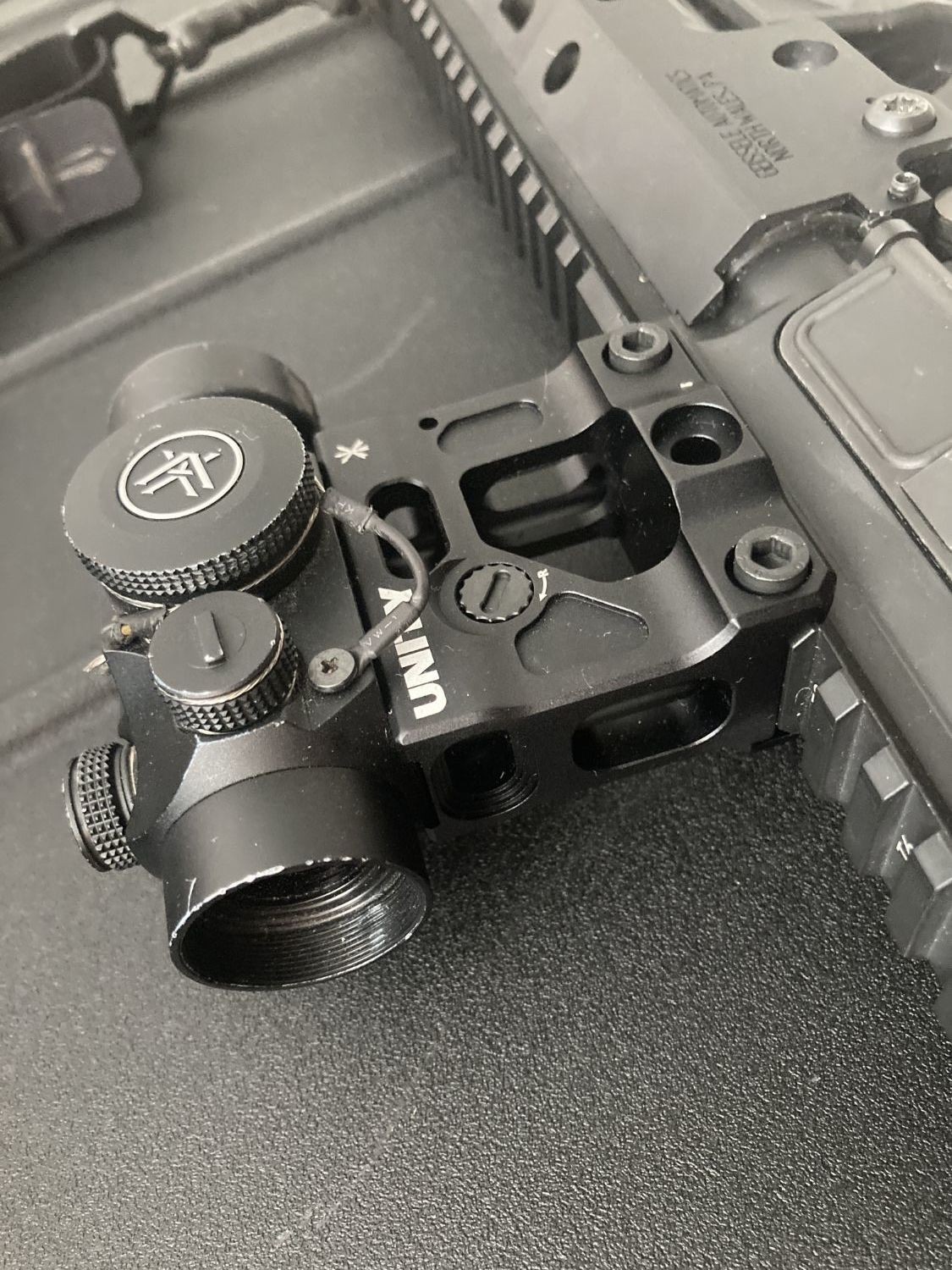

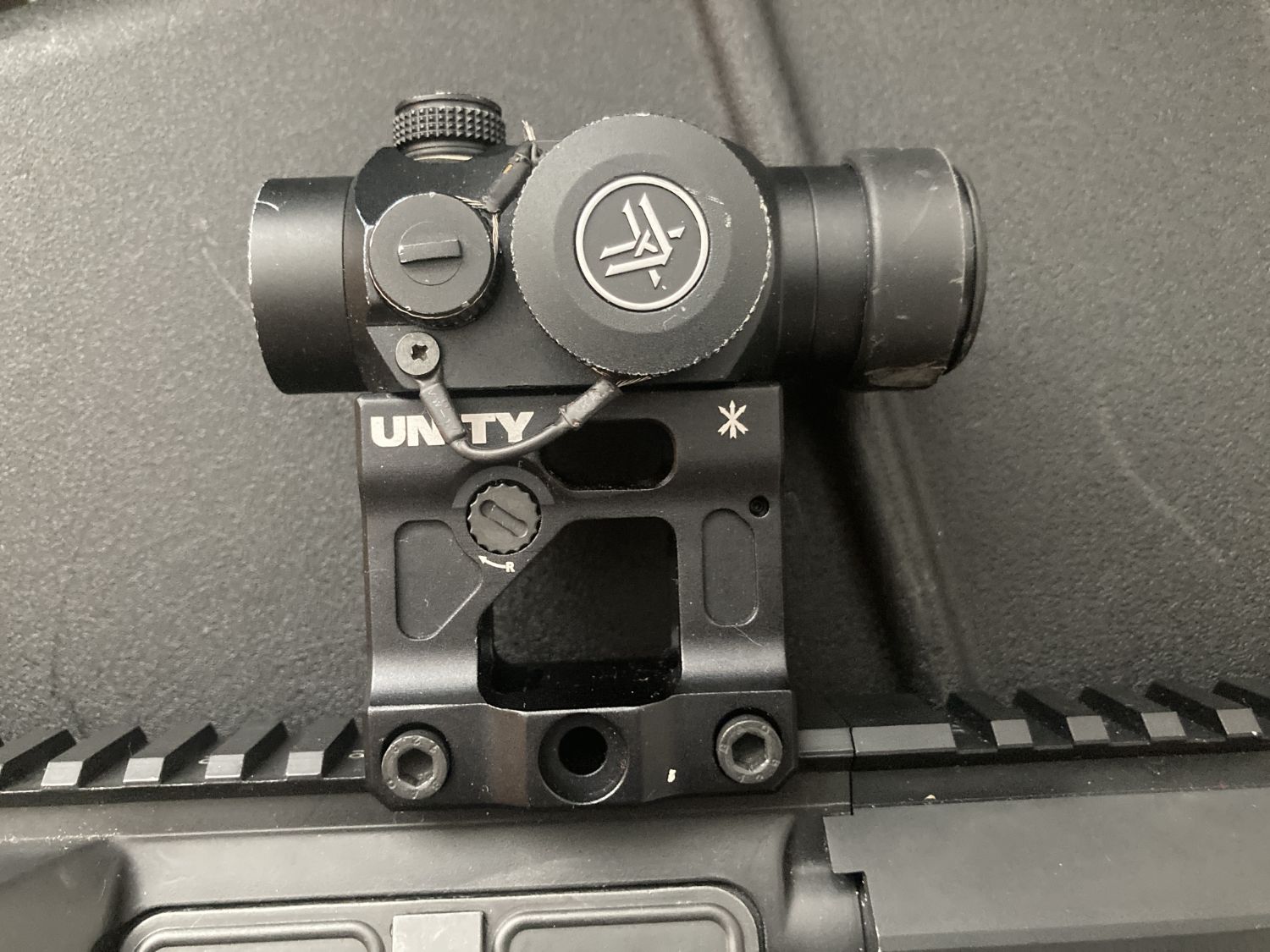

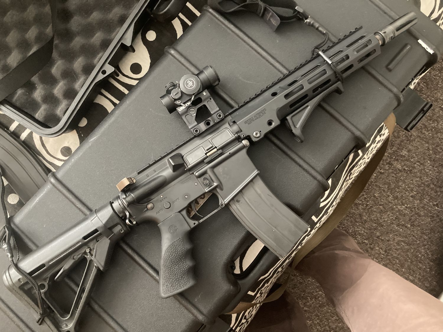

camden Posted May 13, 2021 Posted May 13, 2021 2 hours ago, AlphaBear said: I’ve been having way too much fun here. Let me explain...... So, I wanted to try out a Unity mount on the MWS and wasn’t sure if I’d want to spend £200 on the real deal. I mean what if I didn’t like it? It’s a lot of money to spend on a real steel mount especially if you don’t like it afterwards. So fortunately Unity provide a template which you can download and create a mock up model of the mount. So guess what I did. Yup. Craft time ? Whatcha think fellas? Cerakote it? ?. On a serious note the mount is pretty tall. It’s a 2.26inch variant which gives you a better shooting position when looking down the barrel. So based on this would you buy one? I bought it and love it. It just takes a little to get use to as it does change your sahooting position for the better! 2 hours ago, AlphaBear said:
AlphaBear Posted May 13, 2021 Posted May 13, 2021 38 minutes ago, camden said: If you have a spare moment can you lob up a pic of it on one of your RIF's. And are you using any magnification with your optic? Thx
camden Posted May 13, 2021 Posted May 13, 2021 3 minutes ago, AlphaBear said: If you have a spare moment can you lob up a pic of it on one of your RIF's. And are you using any magnification with your optic? Thx Hi Alphabear. I "misspoke" earlier: I own the PTS version/clone and am happy with it (so not the actual expensive RS Unity). ...and yes, there is a bolt missing in my HAO rail :( GothicGhost and AlphaBear 1 1
AlphaBear Posted May 13, 2021 Posted May 13, 2021 19 minutes ago, camden said: Hi Alphabear. I "misspoke" earlier: I own the PTS version/clone and am happy with it (so not the actual expensive RS Unity). ...and yes, there is a bolt missing in my HAO rail :( I’m trying not to look at that hole where the screw should be in the rail. Damn Ocd. ? The mount does look good! I’m warming to it truth be told. The PTS version is supposed to be a very good licensed replica as you already know from having one. Thanks for the pics. Appreciated.
camden Posted May 13, 2021 Posted May 13, 2021 19 minutes ago, AlphaBear said: I’m trying not to look at that hole where the screw should be in the rail. Damn Ocd. ? The mount does look good! I’m warming to it truth be told. The PTS version is supposed to be a very good licensed replica as you already know from having one. Thanks for the pics. Appreciated. Just so that you can sleep better tonight: replacement screw is in the post from HAO ? There is an even cheaper version available on ebay I have just been made aware, just search for: Unity Style Fast Micro Aimpoint T1 / T2 High Rise Mount Only Black / FDE Airsoft
