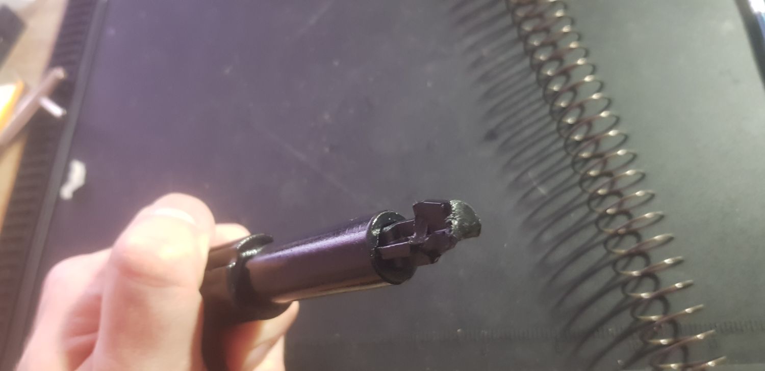

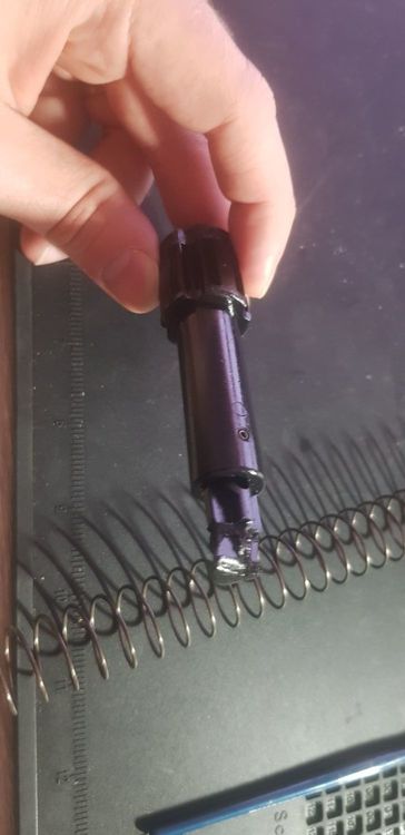

TadsJ2 Posted April 19, 2021 Share Posted April 19, 2021 (edited) Hey guys, So after yesterday i noticed some plastic bits are coming out of my buffer tube, so I disassembled the buffer tube and noticed that the buffer spring guide has chewed some plastic off of it... I have a few questions: What could be the cause of it? Can it be 170% nozzle return spring? Maybe 345 fps that my gun is constantly shooting? Or is it because when i tried the gun on max npas set it shot 413fps? So what do u suggest I do now, can i continue to use mtr16 or should I change the plastic buffer spring guide to something made from metal? Like G&P Aluminum buffer spring guide v2? EDIT: I had no choice but to shoot out the remaining magazines before I store them until the next game day, i dissassembled the buffer spring guide again and saw no new cracks, so i guess it is from 413fps. Which aluminum buffer spring guide do you suggest me to get? Maybe G&P V2 ? (definitely NOT AG right? ) Edited April 19, 2021 by TadsJ2 Link to comment Share on other sites More sharing options...
Davegolf Posted April 19, 2021 Share Posted April 19, 2021 @Hypokondrikern just fire the gun off so it is not stored ‘cocked’ then all the springs will be released. @TadsJ2 that broken part is called ‘buffer part B’, get a new one, keep the TM buffer but run a HSB spacer with it and this will not happen again. The TM Buffer is the most gas efficient and fastest cycling, as well as not damaging the buffer tube. TadsJ2 and Hypokondrikern 1 1 Link to comment Share on other sites More sharing options...
TadsJ2 Posted April 19, 2021 Share Posted April 19, 2021 (edited) 32 minutes ago, Davegolf said: @TadsJ2 that broken part is called ‘buffer part B’, get a new one, keep the TM buffer but run a HSB spacer with it and this will not happen again. The TM Buffer is the most gas efficient and fastest cycling, as well as not damaging the buffer tube. Everywhere I looked part B is out of stock what about HSB spacer? can i only get it from SixG? also he doesnt ship overseas? Also what about guns modify ? i suppose part B is not interswitchable between guns modify and TM original one? Edited April 19, 2021 by TadsJ2 Link to comment Share on other sites More sharing options...
TadsJ2 Posted April 19, 2021 Share Posted April 19, 2021 (edited) I wrote to SixG to ask whether he ships overseas... As to regarding to buffer spring guide Part B maybe someone has ant .stl file of it for 3d printing? since i cant find it in stock anywhere i might as well print it... Edited April 19, 2021 by TadsJ2 Link to comment Share on other sites More sharing options...
Davegolf Posted April 19, 2021 Share Posted April 19, 2021 Hi, the Modify Polymer buffer will be fine, its jsut all the heavy metal roller wierd ones you wnat to avoid. TadsJ2 1 Link to comment Share on other sites More sharing options...
TadsJ2 Posted April 19, 2021 Share Posted April 19, 2021 11 minutes ago, Davegolf said: Hi, the Modify Polymer buffer will be fine, its jsut all the heavy metal roller wierd ones you wnat to avoid. thanks! thats a relief I found some modify polymer buffers and SixG replied that he is shipping to my address so thats good news! also for now the gun is working and shooting well even with broken end, i've put some isolating tape on the broken end and melted it a little bit so it doesnt come off that easily, will have to do until replacements come or would u just suggest to leave it to rest until i swap out buffer spring guide ? Link to comment Share on other sites More sharing options...
Davegolf Posted April 19, 2021 Share Posted April 19, 2021 You could cut it off square so it has a flat end, cut some rubber discs same diameter as the buffer tube ID or something that add upto the length that is missing from the the Buffer part B, so the buffer spring holds them in place. That way if you do want to keep using it the buffer wont be over travelling. TadsJ2 1 Link to comment Share on other sites More sharing options...
TadsJ2 Posted April 19, 2021 Share Posted April 19, 2021 (edited) 2 hours ago, Davegolf said: You could cut it off square so it has a flat end, cut some rubber discs same diameter as the buffer tube ID or something that add upto the length that is missing from the the Buffer part B, so the buffer spring holds them in place. That way if you do want to keep using it the buffer wont be over travelling. Nice idea, but wouldnt additional rubber discs shorten and strengthen the spring therefore the buffer guide rod wouldnt travel as much and buffer spring guide "part a" would hit buffer tube spring holding latch harder? Therefore would be at higher risk of braking the aforementioned latch? Edited April 19, 2021 by TadsJ2 Link to comment Share on other sites More sharing options...
Davegolf Posted April 19, 2021 Share Posted April 19, 2021 No that is all good, its partly the reason your part broke, the buffer is at too high a speed when it stops. TadsJ2 1 Link to comment Share on other sites More sharing options...

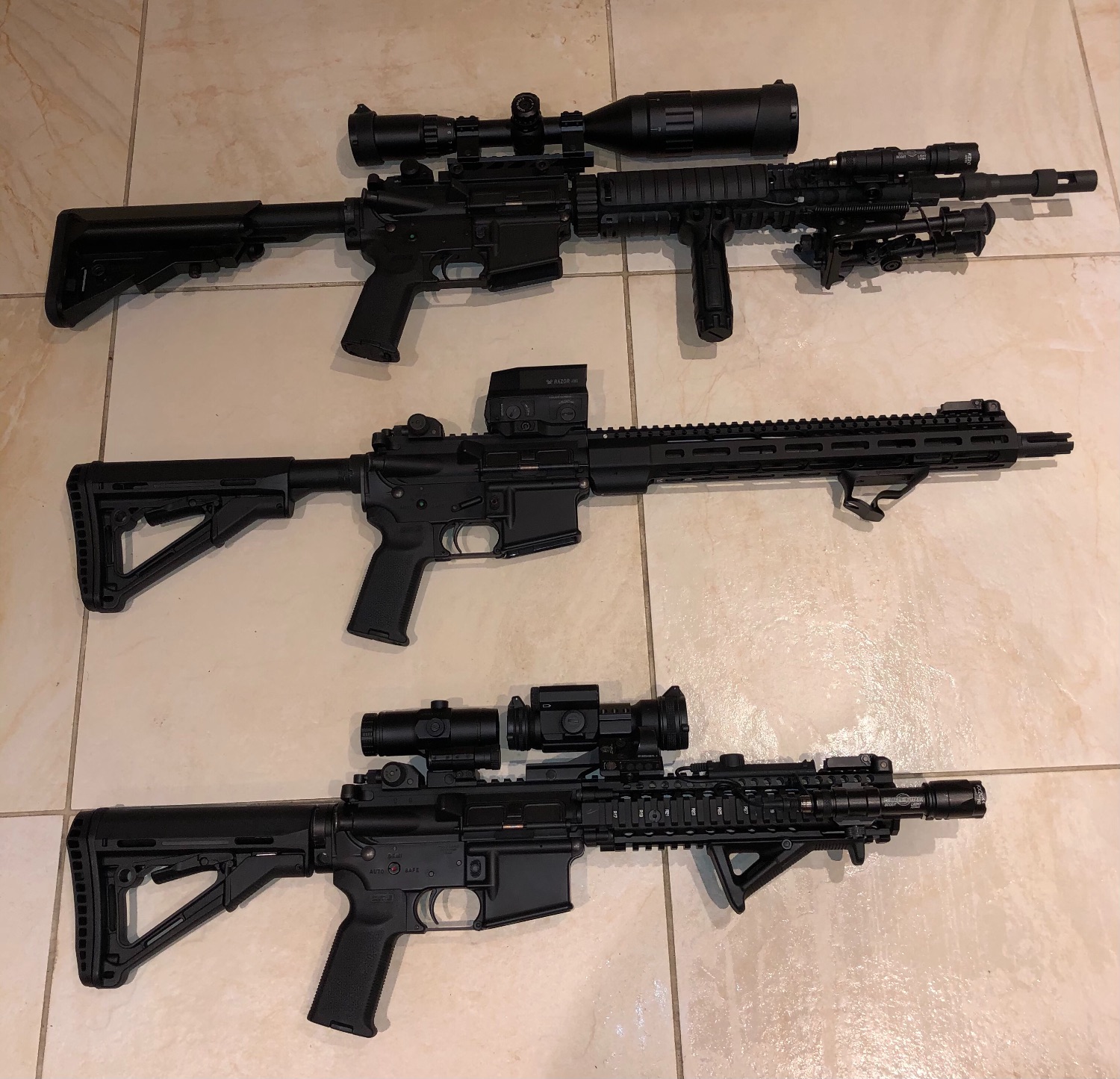

Cyberlawyer Posted April 19, 2021 Share Posted April 19, 2021 Ok so general question to the MWS hive mind, I currently own 3 MWS and I have them set up as follows: 1. Mk18 build 10.5 inch barrel - Full auto - regular skirmish gun shooting 350 fps. 2. Mk12 build 20 inch steel outer barrel (yes its bloody heavy) - Semi locked - shooting 500fps, (but usually have to down tune it with NPAS to 450/400 for site DMR limits). 3. 14.5 inch - competition gun - Semi locked - shooting 380 fps on 0.3g bbs used for 2/3 gun competition shooting where as long as it is legal highest FPS possible is an inherent advantage as we are only shooting targets, 14.5 inch barrel makes it very quick to transition between targets so perfect for 3 gun style shooting. I may have just acquired another MWS (it is actually an MTR and I plan to transplant the ambi receiver into my competition gun). So my question is what build should I do with this gun, given I will be using the regular mws receiver currently on my competition gun. Currently I am thinking either: (a) a 16" recce rifle build, or (b) a short barrelled PDW build (probably 8 inches), What do people think would be the best way to go that I would get the most use out of? Link to comment Share on other sites More sharing options...
Davegolf Posted April 19, 2021 Share Posted April 19, 2021 @Cyberlawyer thats a dedicated airsoft collection! Can you post a pic of all three? Link to comment Share on other sites More sharing options...

Cyberlawyer Posted April 19, 2021 Share Posted April 19, 2021 @Davegolf I think there is a picture earlier on the thread but always happy to repost a pic of the ladies... @gunbod007 How many were you carrying? I sometimes carry 13 (10 on plate carrier, 2 in belt and 1 in gun) and while heavy it’s not uncomfortable. Although I do normally carry less so I can lay flatter. Link to comment Share on other sites More sharing options...
