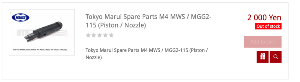

RMDavis Posted February 16, 2021 Posted February 16, 2021 Impulse 101 has nozzles back in stock chaps if you need any spares for those 'oh ffs moments' ? http://impulse101.jp/en/m4-mws-parts/tokyo-marui-spare-parts-m4-mws-mgg2-115-piston-nozzle-3619
AlphaBear Posted February 16, 2021 Posted February 16, 2021 1 hour ago, RMDavis said: Impulse 101 has nozzles back in stock chaps if you need any spares for those 'oh ffs moments' ? http://impulse101.jp/en/m4-mws-parts/tokyo-marui-spare-parts-m4-mws-mgg2-115-piston-nozzle-3619 Oh I know that 'FFS' moment all too well
AlphaBear Posted February 16, 2021 Posted February 16, 2021 Their postal services are still showing this though.....
RMDavis Posted February 16, 2021 Posted February 16, 2021 4 hours ago, AlphaBear said: Their postal services are still showing this though..... Pretty sure I don't reside in French Polynesia! ? I placed my order this morning, and already have been sent a tracking number so it seems all good to me! ?
AlphaBear Posted February 16, 2021 Posted February 16, 2021 Would be nice if we did reside there lol. What did you order out of curiosity?
RMDavis Posted February 16, 2021 Posted February 16, 2021 42 minutes ago, AlphaBear said: Would be nice if we did reside there lol. What did you order out of curiosity? Two nozzles for the spares box! AlphaBear 1
AlphaBear Posted February 16, 2021 Posted February 16, 2021 1 hour ago, RMDavis said: Two nozzles for the spares box! Aye good shout. I have a spare Marui nozzle and a couple of G&P and one very angry gun one too lol RMDavis 1
AlphaBear Posted February 16, 2021 Posted February 16, 2021 They didn't last long.... I bet they only had a few in too....
