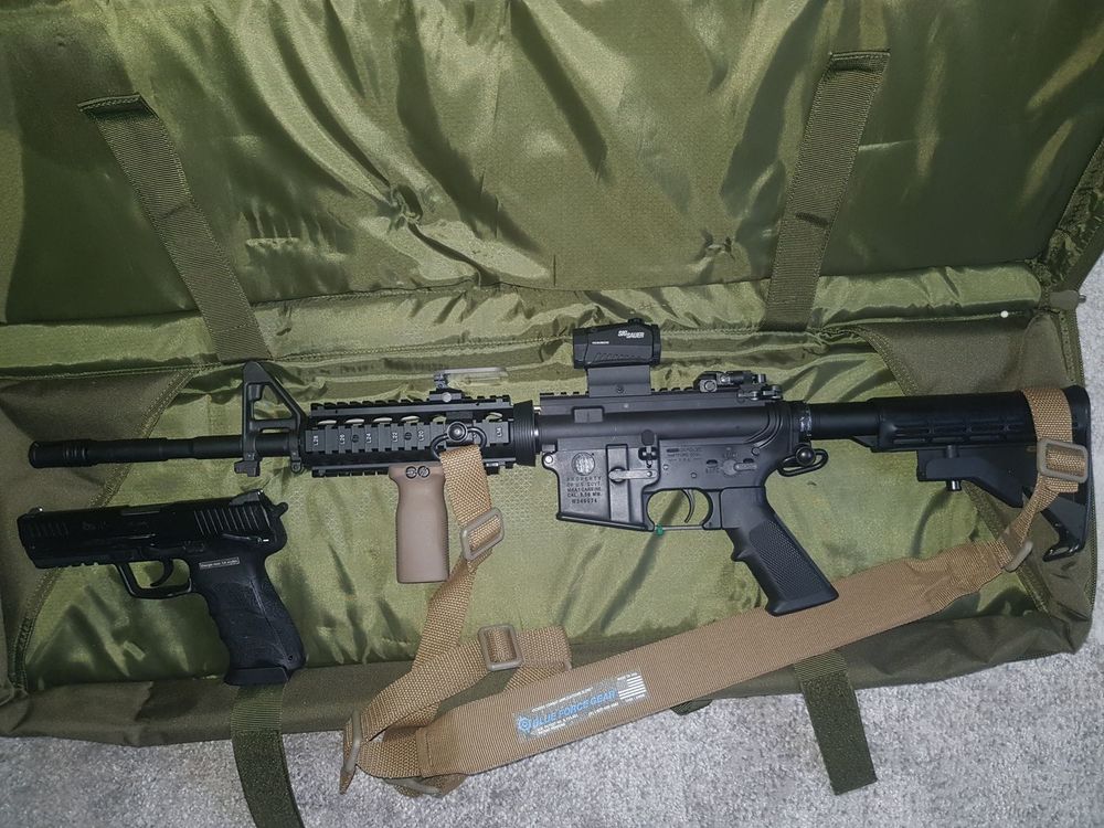

GregArm Posted July 15, 2020 Share Posted July 15, 2020 Hi guys, My first post is here. I'm from Germany, sorry if I write something wrong. I found this topic searching for MWS on the net, and I am very happy to see a lot of information about it. Half a year ago I bought my Tokyo Marui MWS and I read everything that I can’t, because this is my first M4 GBB. So far I have done all the mods that you guys recommended here, for example, a mod with green gas and the 4 most important upgrades: - Prometheus 370mm 6.03 - SixG Super Nub - Npas Ra-tech - Modify Tan bucking It seems to me that this works well together. I noticed that many guys are building weapons of DMR, but for now I would like to play in the classic version. Since automatic shooting mode is prohibited in Germany, we only shoot semi-automatic. I want to order spare parts for my MWS such as Bolt Carrier, Nozzle and Buffer. There are many options and combinations, but I am confused and do not know what works best together. Advise details to increase rate of fire. To make the cycle run faster and softer. Thanks in advance. HSB Spaser , Angry Gun Super Recoil Buffer , Dynamic Precision Aluminum Lightweight Bolt Carrier , ENHANCED DROP IN COMPLETE MPA NOZZLE It looks like my weapon now Link to comment Share on other sites More sharing options...
