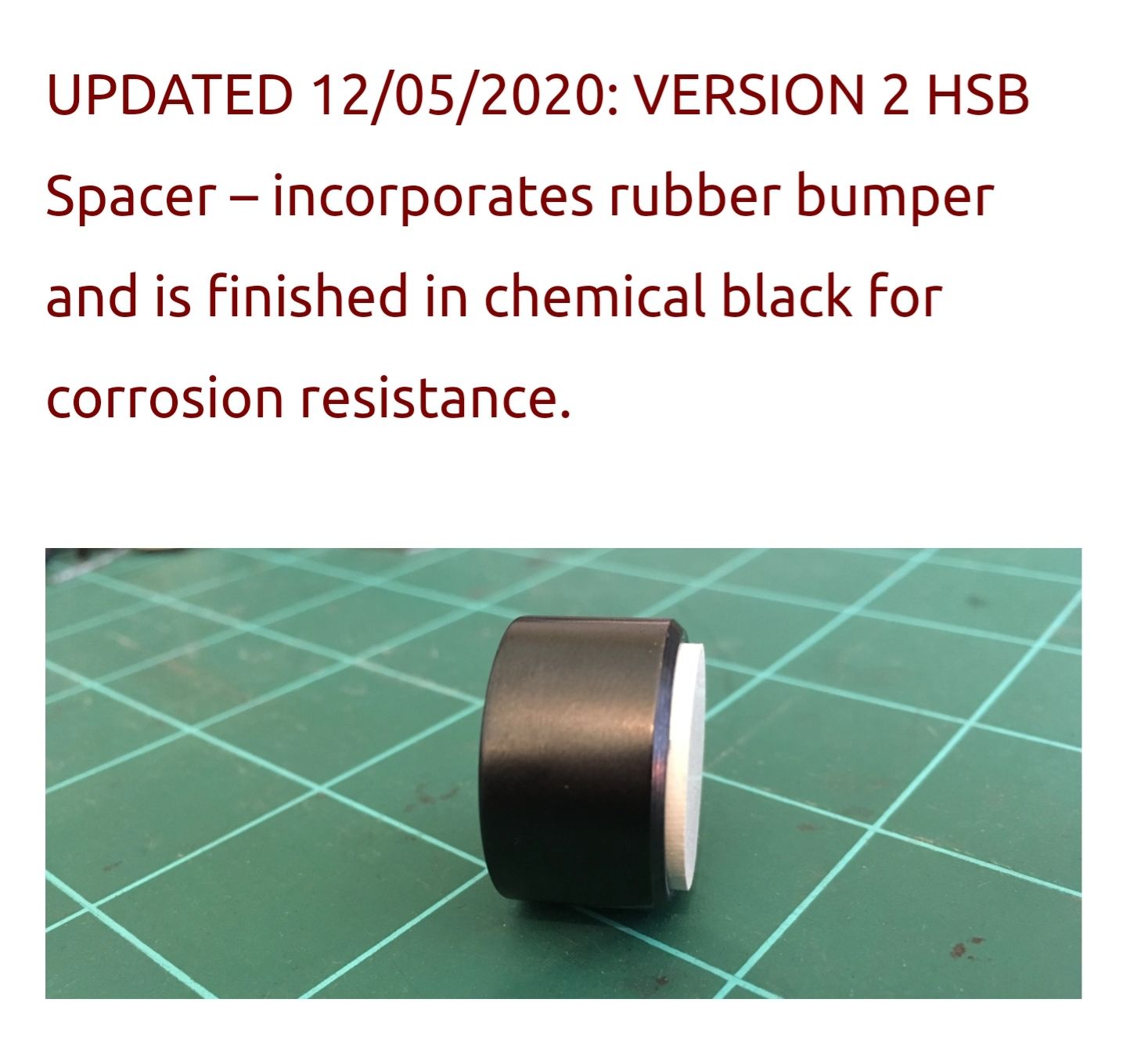

SSPKali Posted May 13, 2020 Share Posted May 13, 2020 Excited to get this in my MWS, shame it will be totally invisible! Great to see constant improvements being made 👍 Link to comment Share on other sites More sharing options...

Hypokondrikern Posted May 14, 2020 Share Posted May 14, 2020 19 hours ago, SSPKali said: Excited to get this in my MWS, shame it will be totally invisible! Great to see constant improvements being made 👍 Lovely! Will the bolt lock keep up with the faster action? Link to comment Share on other sites More sharing options...

marine Posted May 14, 2020 Share Posted May 14, 2020 20 hours ago, SSPKali said: Excited to get this in my MWS, shame it will be totally invisible! Great to see constant improvements being made 👍 what is it ? Link to comment Share on other sites More sharing options...
Bada Bing Posted May 14, 2020 Share Posted May 14, 2020 1 hour ago, marine said: what is it ? It goes behind the buffer spring at the back of the buffer tube and creates extra spring tension for quicker semi auto shots, all while not eliminating any travel of the working parts themselves. The buffer can still pass through it. This newer design is said to further improve the plastic buffers longevity. I have been very fortunate and one is being sent to me courtesy of Dave from SixG. I received the previous version makes it a little more snappier, it was no slouch to begin with lol! Link to comment Share on other sites More sharing options...
marine Posted May 14, 2020 Share Posted May 14, 2020 2 hours ago, Bada Bing said: It goes behind the buffer spring at the back of the buffer tube and creates extra spring tension for quicker semi auto shots, all while not eliminating any travel of the working parts themselves. The buffer can still pass through it. This newer design is said to further improve the plastic buffers longevity. I have been very fortunate and one is being sent to me courtesy of Dave from SixG. I received the previous version makes it a little more snappier, it was no slouch to begin with lol! ok thanks ! Link to comment Share on other sites More sharing options...

Hypokondrikern Posted May 15, 2020 Share Posted May 15, 2020 20 hours ago, Bada Bing said: It goes behind the buffer spring at the back of the buffer tube and creates extra spring tension for quicker semi auto shots, all while not eliminating any travel of the working parts themselves. The buffer can still pass through it. This newer design is said to further improve the plastic buffers longevity. I have been very fortunate and one is being sent to me courtesy of Dave from SixG. I received the previous version makes it a little more snappier, it was no slouch to begin with lol! Lovely! And the bolt lock gets its time to click into place? Or do we need to unscrew the buffer tube 2 cm? 😉 8 hours ago, RobHedley said: Hey guys, The piston, more specifically the nozzle on the piston, seems to have taken a hit (possible double feed) and dented the front edge of the nozzle just enough to cause it to occasionally not seat properly. Looking to replace it. Is it best to stick with an oem TM part or is there an equivalent alternative? Looking to fit an NPAS at the same time as this is on my DMR. Thanks for the help in advance I have had no problems with GunsModify and their nozzle. Their parts are fairly easy to come by and modest in price compared to others. Good luck! Link to comment Share on other sites More sharing options...
