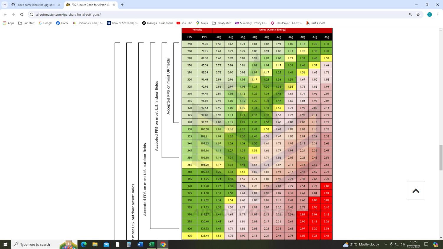

ButcherBill Posted August 20, 2024 Posted August 20, 2024 (edited) I save this for checking, I guess technically he's correct. *has a quick check there's no naughty info in my screeenshot.* Edited August 20, 2024 by ButcherBill

Cannonfodder Posted August 21, 2024 Posted August 21, 2024 9 hours ago, blobface said: I never thought it's from ignorance, I was proven wrong by this site owner A combination of that and laziness. Even if you don't want to mess about with changing settings on the chrono it only takes a few seconds to look at a chart like the one posted by ButcherBill Chev Chelios, Galvatron and Rogerborg 3

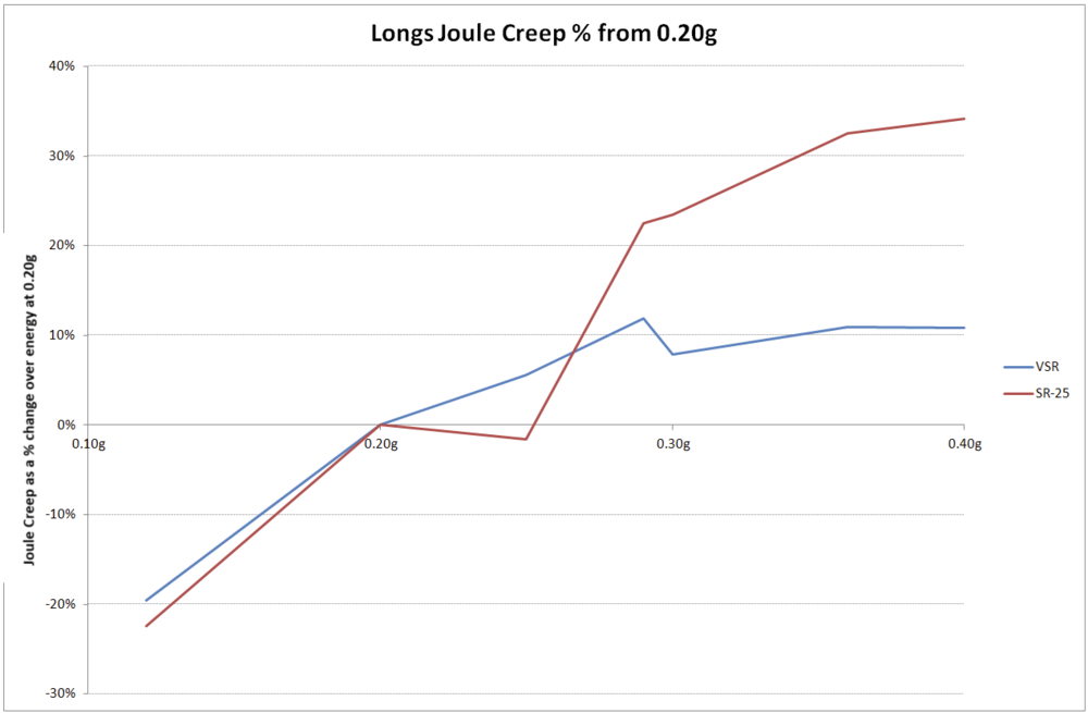

Mint Posted August 22, 2024 Posted August 22, 2024 https://www.legislation.gov.uk/ukpga/1968/27/section/57A Law is pretty clear. It is not 374fps at 0.2g, it is explicitly 1.3Joules. However, it seems they may be correct that an AEG shooting 350FPS at 0.2g (1.14J) is unlikely to experience Joule creep that would increase up to above 1.3J. Though a DMR or Sniper may be likely. The only data I've found on joule creep in airsoft is this reddit post from 10 years ago https://www.reddit.com/r/airsoft/comments/29wi1s/joule_creep_testing_results_various_guns_and_bbs/ The data they found is as follows: The mid-range AEGs and pistols tended to have very little joule creep from 0.20g+ (or even negative sometimes), however the DMR (SR-25) and sniper (VSR) did show significant joule creep. The DMR increases in energy ~34% from 0.20g to 0.40g. If we were to assume that this DMR were at your site and were shooting at the site limit of 450fps at 0.20g, (1.87J), when loaded with 0.40g bbs, it would be shooting at or just above the legal limit of 2.5J. When you consider that it is also firing in semi-auto, that is not safe or fun. The sniper's increase is also a concern but your site already appears to have addressed that. Generally, it seems that the rules that this site has for AEGs should be fine, as is the rule on snipers. However, the DMRs should certainly be chrono'd in Joules on the BB that will be used, the same as snipers are at thissite. It would be nice to have some more up to date data on this with more varied guns and more information such as piston volume. Rogerborg and Chev Chelios 1 1
