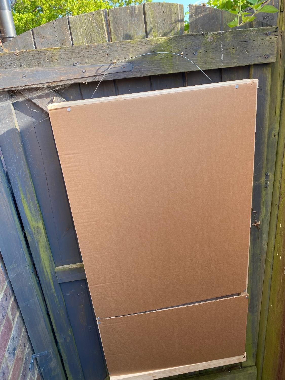

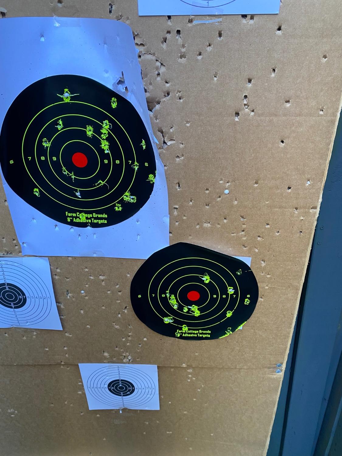

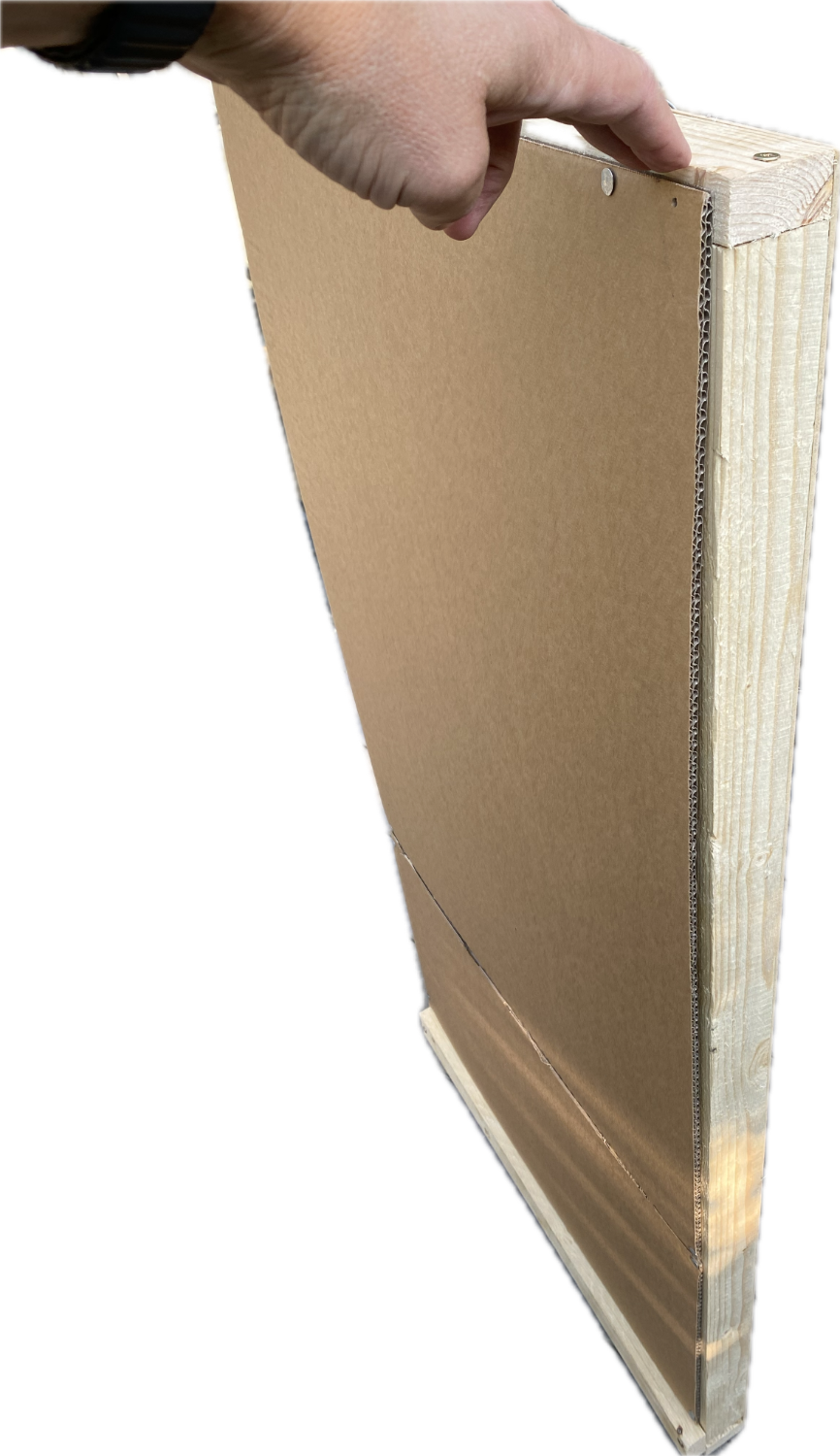

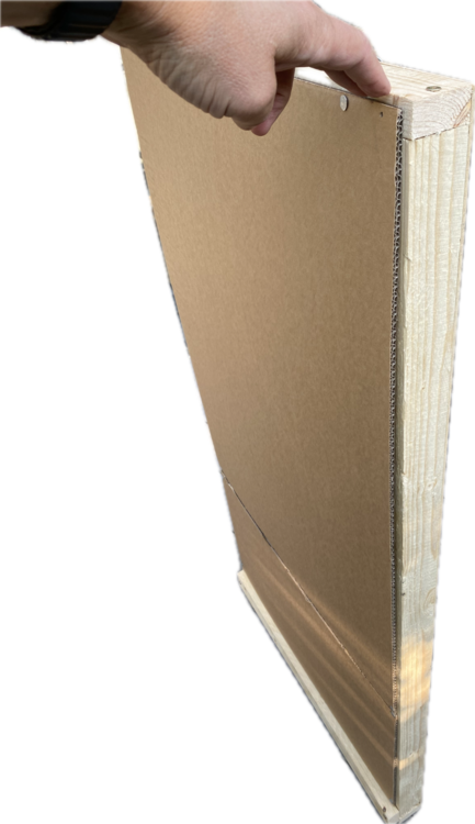

ParHunter Posted November 6, 2023 Posted November 6, 2023 After seeing people using Gousto boxes as bb catchers on another thread I thought I share what I’ve done for my Airsoft shooting range in the garden. I didn’t use Gousto but Hello Fresh packing material. I’ve used a 60x120cm MDF board and screwed on 1x2 in boards. I then filled it with the packing material from Hello Fresh that they use to keep the meat cold (see first picture). In the bottom of the frame I left a small gap so when I tilt the I don’t shoot from very close (4-10m) but the bbs just stay in the bb catcher and at the end I just tilt the board and the bbs roll out on the side into a bin. Please share your ideas for target practice at home or in the garden DJsnipe, Dan Robinson, Hotweeweejef and 1 other 3 1

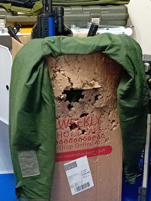

gavinkempsell Posted November 6, 2023 Posted November 6, 2023 Mine is a cardboard box with an NBC suit inside, yet to have any penetrate through it.
