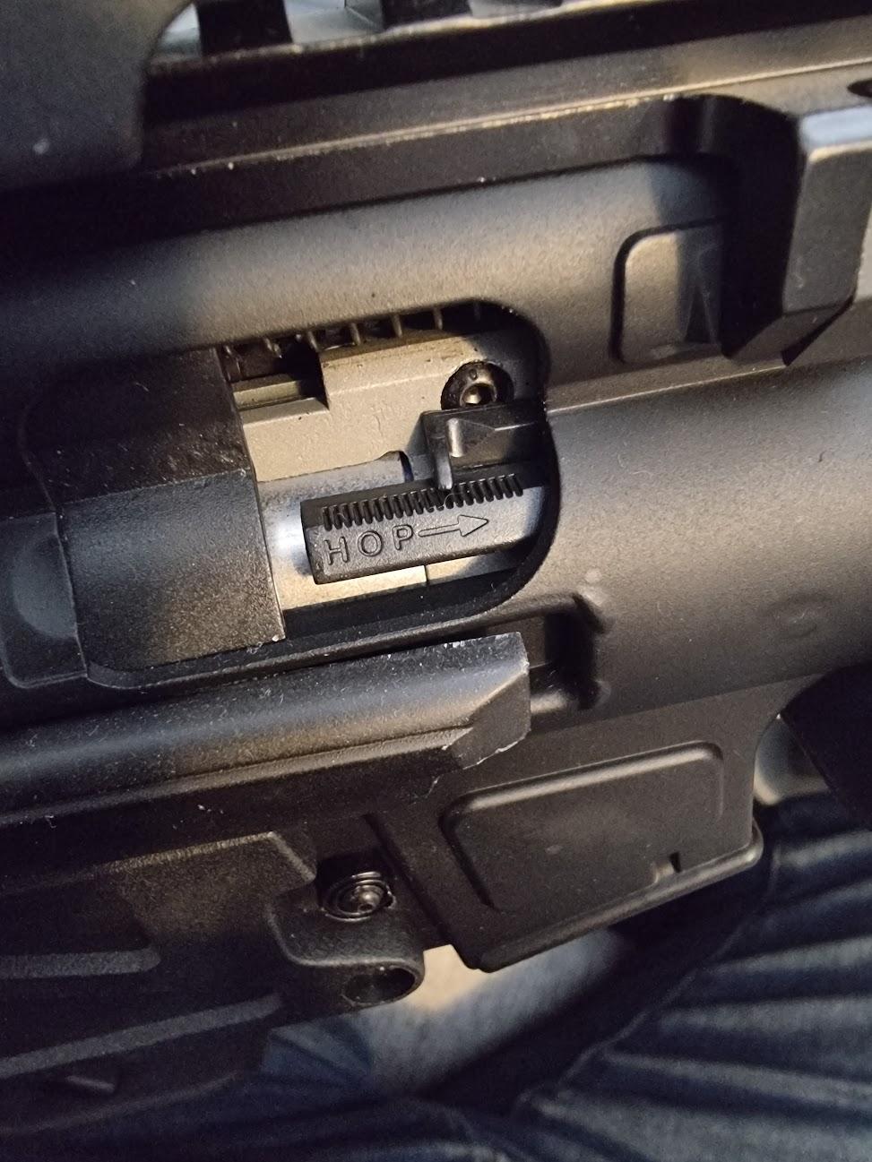

9 minutes ago, BigStew said:
Is it still the TM MP5 style? I am sure I saw a classic army MP5 that had a G3 style rotary hop fitted.
No, it's still a slider type but they've made the top of the slider serrated so it clicks into place:
This is in my A3.
Note that the mosfet is pretty basic ie not programmable.
