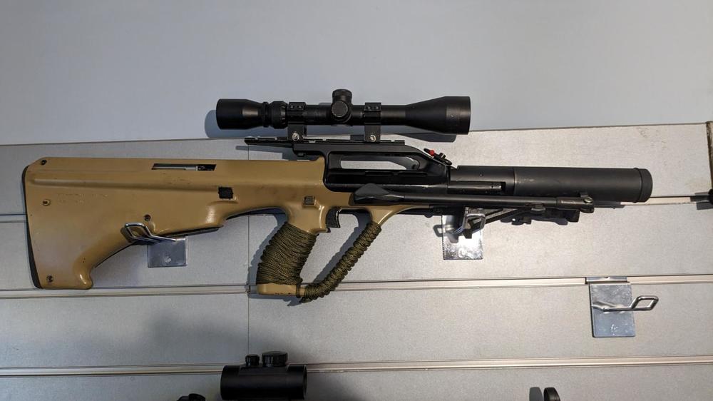

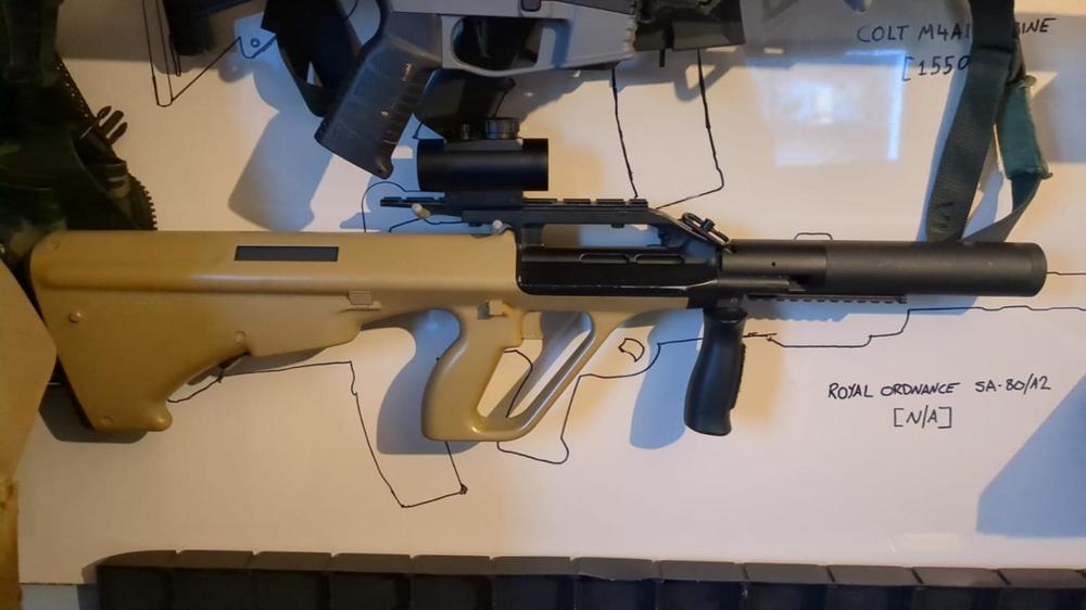

I bought a boneyard TM one. For the paltry sum of £90.
It wasn't well. @Iceni pointed me in the correct direction and after managing to lunch a spur gear (yup, tm cheesium gears) with the addition of a high torque motor, I rebuilt the box, painted it the correct RAL colour (aka "mud"- seriously, that's the Oem name for it!!) And I LOVE IT. I apparently have an oddball one, as mines all silencered up but may be a tm/snow wolf swinging session outcome. 490mm tb barrel, m105, hi torque, metal gears 😁, new Oem hop with a maple and I can chuck 0.28's at people all day.

24 minutes ago, Egon_247 said:
Ooooh. Aug goodness. 😁
that looks great :) , I’m still tempted by an AEG … just need to recoup some funds ( and storage space 😛 )

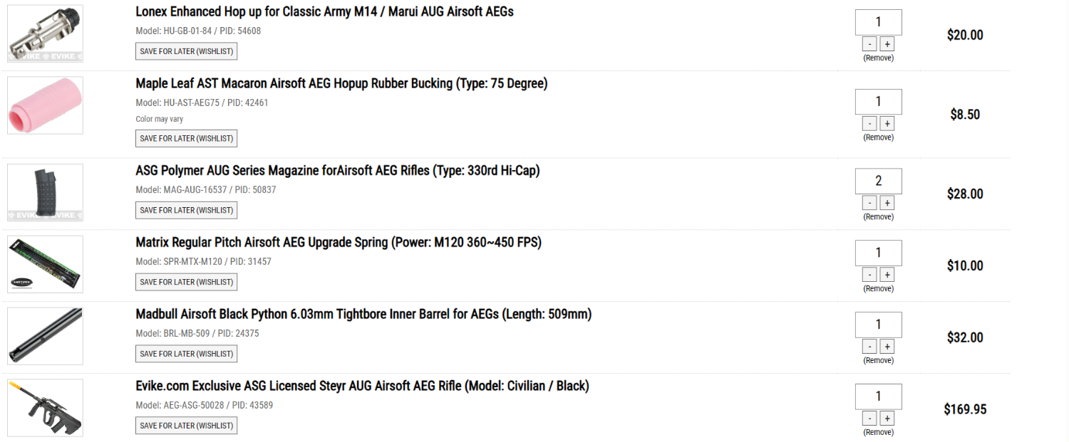

I recently got into wanting to make a AUG build
this is what I got so far is this good?image.thumb.png.1d5736b856be2ecfadcba200a93299b3.pngWhat motor brand/type would you recommend as well as bearings size
Lonex hop unit, No idea about them. The stock plastic units are fine.
Maple leaf hop rubber - I can't comment on that either. We have 350fps and cold weather here in the UK. So soft 50deg rubbers are generally more our thing. I'd run the stock rubber and hop unit till it breaks.
https://www.evike.com/products/31081/
ASG mags -  No issues there. You can get the MAG 170rnd ones from Evike. There my absolute favourite AUG mag. Good capacity, no winding, no rattle. If you can afford it then I would always recommend those mags. Equally the King Arms and ASG 110rnd mags are good options as well if you hate rattle.
https://www.evike.com/products/31490/
Matrix spring - no idea, It's not a branding we see over here.
Madbull Python 6.03 - Avoid Avoid Avoid. The barrel is too wide for an AUG's inner sleeve and will bind up causing all sorts of issues. The ZCI ones are spot on if you can find them. All of my AUGs use them. The other brands I have no idea about as the ZCI's have always been on point.
https://www.evike.com/products/11878/
ASG AUG - It's an ASG sportline by the looks. Identical to the JG but with the added trades. Metal bushing, Basic motor, QC spring. Absolutely solid as a basic gun or upgrade gun. The JG may or may not have a QC spring depending on how old the stock is. With the ASG one having it in the description I would go that way. I wouldn't upgrade anything for the first few games on it. Get a feel for it first and work out what you need to do. If you go with the big batteries I've linked lower down be aware that the inline fuse may have difficulties as you can see a lot of current draw. So It may be worth adding some bigger fuses to the order. Or have a plan to bypass the fuse if it starts to glow.
I'd run it on a 7.4v big lipo. 2200mAh. I Know I can fit a battery 103.6 x 34 x 15.5mm into mine no trouble. 101.1 x 35.5 x 16.1mm also fit and work. You may have to modify the bottom of the gearbox plate to remove a plastic part that sticks out (2 mins with a dremel). I would also convert to deans as mini tamiya connectors are crap. I'll link a battery that will work, but 20/40c is pretty low for these. Giant power over here do a 35/70c 5c charge model that is my preferred battery. If you are wanting 11.1v then you need to speak to someone else as I don't own any - It may also be worth talking to your local gamers as you may need 11.1v for your power levels.
https://www.evike.com/products/47743/
Motor is not something I can't advise on. Nor gears, As you run different power levels, So what I know won't translate to what you need.
For UK power levels 350 fps, I tend to find AUG's will run hot on standard spring configurations if you get the seals right. I think mine are running cut M110's but it's been a while since I had them open.
