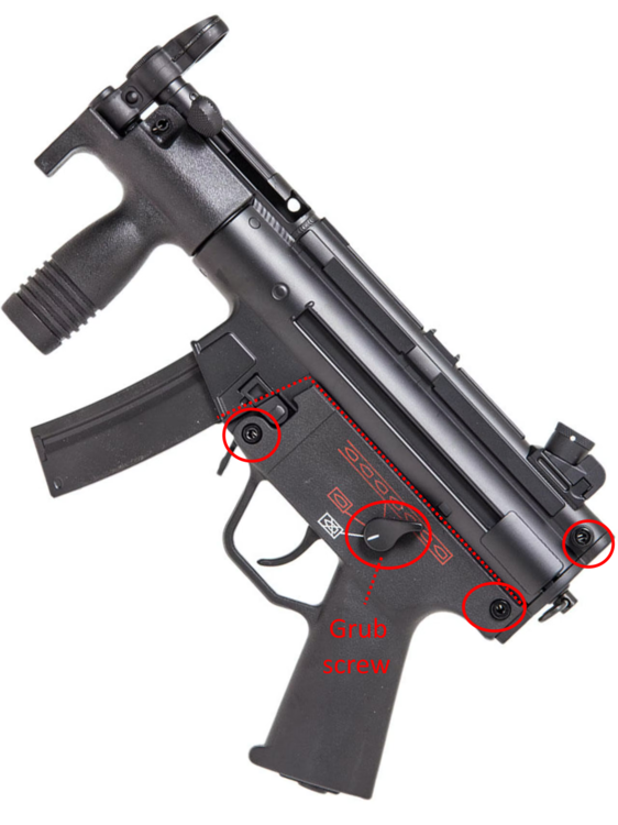

If you do want to be sure about the piston position by seeing the cylinder, splitting these things isn't a huge chore.
Take out the rear pins, undo the screw behind the magwell and push the pin through, take the small grub screw out of the fire selector, remove one side and pull the selector out from the other side.
The receiver will then split along the dotted line.
Reassembly is the opposite of removal, plus a lot of swearing as you try to get the fire selector, nozzle and hop unit lined up.
