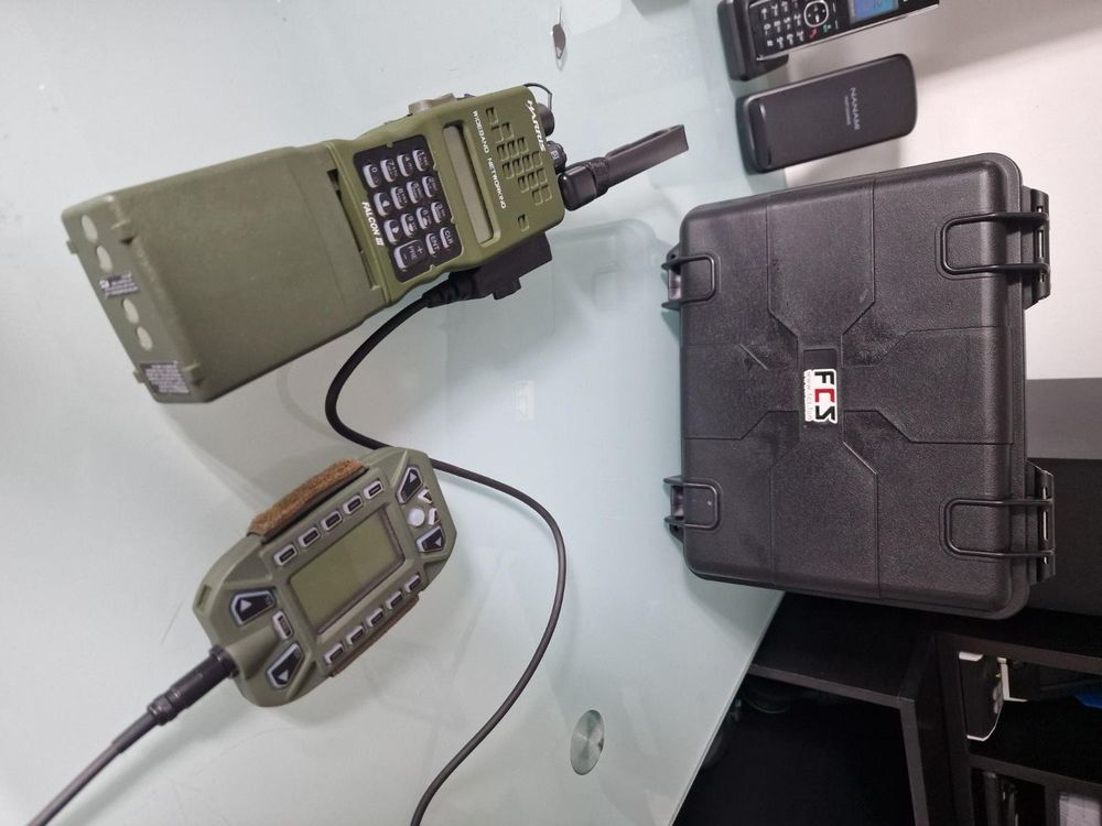

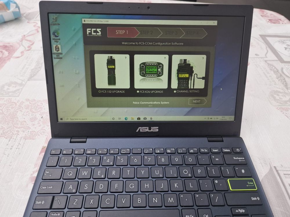

It's a no brainer (A no sh*t sherlock moment!), but the more we've been utilising our coms semi-effectively, the more efficient as a unit we've become, so being the inevitable peacock that I am have recently purchased an FCS 152 Radio & KDU. Nowhere near as user friendly to get up & running, but have purchased this as it'll mean I need to study / tinker & learn as opposed to being shown for a change!
Anyways, just awaiting connector mods to my existing PTT to have everything up & running but looking forward to figuring this out & getting the best out of the kit
