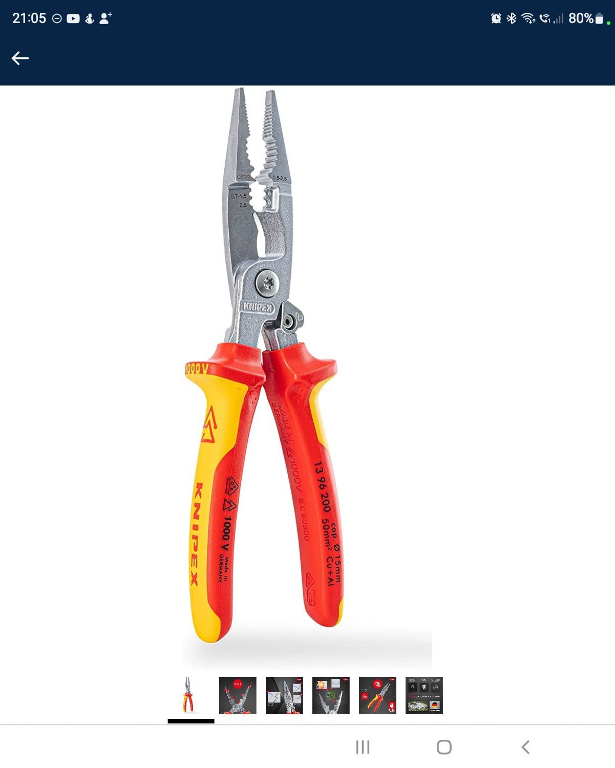

Dan Robinson Posted July 7, 2022 Share Posted July 7, 2022 My favourite toy when I'm wiring my control panels is this: KNIPEX Pliers for Electrical Installation 1000V-insulated (200 mm) 13 96 200 https://amzn.eu/d/gys0gx8 Egon_247 1 Link to comment Share on other sites More sharing options...

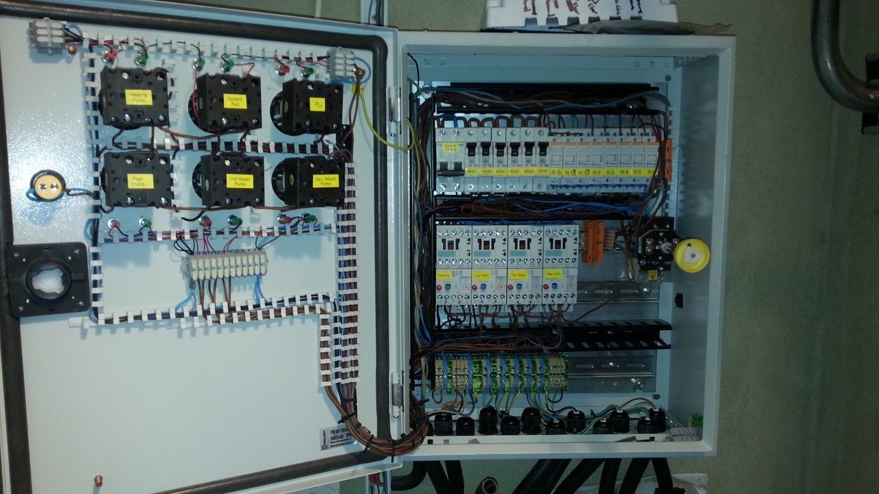

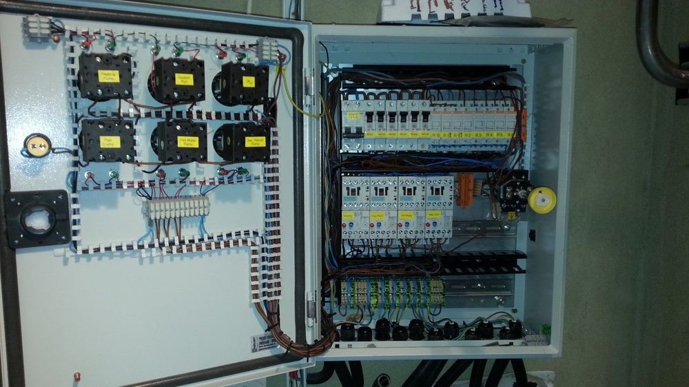

Dan Robinson Posted July 7, 2022 Share Posted July 7, 2022 (edited) Boiler / heating ones: This one is not finished yet.... Needs a little tidying. Interfaces the home automation shenanigans to the boiler's cascade manager (the oem stuff costs a crazy amount). Edited July 7, 2022 by Dan Robinson Lozart and Rogerborg 2 Link to comment Share on other sites More sharing options...

Dan Robinson Posted July 7, 2022 Share Posted July 7, 2022 I have those cheap ones from amazon linked above and they're great for the job too. I like those knipex ones as they're one of those few multitools that do all the jobs properly. The only real difficiency is that you don't have a proper mechanism to crimp to the appropriate torque. But I've not burnt any houses to the ground yet. My other crimping related toys are: Bootlace Ferrule Crimping Tool STD AWG23-7/0.25-10mm² Self-Adjustable Ratchet Wire Crimper with 1350PCS Crimp Connectors,Ferrule Crimper Plier Set https://amzn.eu/d/bdm5x4z Hilka 28600209 Ratchet Crimping Tool Pro Craft https://amzn.eu/d/fa0d99P And in total airsoft (spending money for the sake of fancy shit) stylee: https://uk.rs-online.com/web/p/crimp-tools/0452473 The ironic thing is I'm a sodding plumber not a cable strangler. 🤣🤣🤣🤣 Tactical Pith Helmet, Egon_247 and Rogerborg 3 Link to comment Share on other sites More sharing options...
