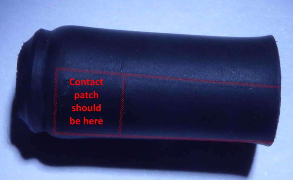

Supporters Rogerborg Posted October 13, 2021 Supporters Posted October 13, 2021 Curious stuff. I threw an M90 spring, a short barrel, a random hop rubber into my DMR'd Specna Arms and took it to a CQB site. All good, except for a complete lack of hop. OK, no worries, I'll just pop in the spare random hop rubber that I thought to bring and... no hop. Well, no biggie, it was the backup-backup-backup AEG. But why no hop? On examination today, it turns out that I'd flat hopped one of the buckings, with the contact bump and most of the keying ridge clearly sanded off, with just enough of its memory remaining to fool me on site in a hurry. I mention this to make it clear that I know what a flat hopped rubber is and what it looks like (inside out, in daylight). The other, well, it has a clear keying ridge, no signs of cutting or sanding anywhere, but no contact bump. There's a rectangular section visible where it should be, bounded by straight, very slight lines running along and across it, but they don't look like anything I did or could have done. It seems like the contact bump is just missing, like it's been pre-flat hopped, but retaining the keying ridge. The rubber, inside out, showing where the contact bump should be (the ridge is on the opposite side). And highlighting the very faint lines. The cratery bit near the shoulder looks like a tiny moulding imperfection, it's not the result of cutting or sanding, I couldn't do work that fine without scuffing up the whole area. What sorcery is this? I've checked my purchase history but can't found that I've bought a "flat hop bucking" or anything similar. What I think this might be, based on the hardness, is a ZCI 70 degree bucking bought from @ak2m4 (and not fitted, it was bought as a backup in case I got DMR Maple Leaf feed issues onsite) although I'll go through my bits box to see if I can find that still packaged elsewhere. [CORRECTION] No, it's not that, the ZCI has been found and is perfectly fine. Either way, a bit of a puzzler. Does anyone make and sell rubbers like this, or have I just ended up with a mutant?
Supporters Adolf Hamster Posted October 13, 2021 Supporters Posted October 13, 2021 hmm removing the keying ridge is a common enough part of the flat-hop process, but as you say it doesn't look like it's been done by hand. if it were a pre-made flat hop then it would presumably retain the ridge as the only reason it's removed normally is to rotate the bucking to get a fresh contact patch. a mystery for sure. also, are the feedlips as torn up as they look in those pics?
Supporters Rogerborg Posted October 13, 2021 Author Supporters Posted October 13, 2021 1 hour ago, Adolf Hamster said: removing the keying ridge is a common enough part of the flat-hop process, but as you say it doesn't look like it's been done by hand. Yup, I removed the ridge on the other rubber. If I'd modified this one, I'd have done it here as well, so I'm pretty sure it came this way. 1 hour ago, Adolf Hamster said: if it were a pre-made flat hop then it would presumably retain the ridge as the only reason it's removed normally is to rotate the bucking to get a fresh contact patch. Yup, again. If someone is selling flat hop rubbers, and I've bought one, this is what it would look like. But I can't find any evidence that I did, or anyone selling them. 1 hour ago, Adolf Hamster said: also, are the feedlips as torn up as they look in those pics? Oh, I probably did that while turning it inside out with a set of ridged surgical forceps because sod it.
Supporters Adolf Hamster Posted October 13, 2021 Supporters Posted October 13, 2021 25 minutes ago, Rogerborg said: Yup, I removed the ridge on the other rubber. If I'd modified this one, I'd have done it here as well, so I'm pretty sure it came this way. yeah it does look factory made, although one does wonder why they removed the keying ridge. 27 minutes ago, Rogerborg said: Yup, again. If someone is selling flat hop rubbers, and I've bought one, this is what it would look like. But I can't find any evidence that I did, or anyone selling them. they're definately a thing, but i'll admit i couldn't specify the brand. any time i've looked i ended up just modding my own or buying something like a maple leaf.
Supporters Rogerborg Posted October 13, 2021 Author Supporters Posted October 13, 2021 2 minutes ago, Adolf Hamster said: yeah it does look factory made, although one does wonder why they removed the keying ridge. They didn't. To be clear, it's got a an unmodified and distinct keying ridge on it. It's exactly how you would make a factory flat hop rubber, I just can't find any evidence that I bought it as such.
Supporters Adolf Hamster Posted October 13, 2021 Supporters Posted October 13, 2021 1 minute ago, Rogerborg said: They didn't. To be clear, it's got a an unmodified and distinct keying ridge on it. thought the first pic was showing the markings where the ridge would be but isn't? now i'm getting even more confused.......

Supporters Rogerborg Posted October 13, 2021 Author Supporters Posted October 13, 2021 10 minutes ago, Adolf Hamster said: thought the first pic was showing the markings where the ridge would be but isn't? No, the ridge is around on the other side, this is where the contact patch should be. Those lines are just barely visible but not tangible. Now that I think about it, they're probably just from pushing the rubber on, then the nub trying to push it through the barrel window. Oh, and I've found what is likely to be the ZCI 70 (apologies to Mr M4), so I suspect this is indeed a factory flat hop rubber. I just have no idea how I got it, or from where.

Supporters Rogerborg Posted October 13, 2021 Author Supporters Posted October 13, 2021 26 minutes ago, Adolf Hamster said: maybe pulled from a secondhand gun? or if you ever work on other people's guns could be from there? Hmm, I can't think of any candidates, and it clearly requires use of a flat hopped arm and a thicc eraser nub, or an S/R-hop patch to work at all - it would be (and is) instantly noticeable when used with a standard arm and nub. I've only got one flat hopped AEG arm, and I did that myself, along with one rubber, and it's not this one. 25 minutes ago, ak2m4 said: @Rogerborg I was going to say that the ZCI 70 is pretty well molded using silicon, the one in the picture looks more like it's made from rubber Good point, the damage on it (the lips and near the shoulder) look like rubber, rather than the smooth splits you tend to get on decent silicone when it gives way. I'm pretty sure that I've found the ZCI 70 now, and it's better quality than this. That just makes it even weirder. Why would you manufacture a flat hop rubber (a premium / upgrade piece) out of sub-standard materials? Small issue, big head scratchings.
Supporters Lozart Posted October 13, 2021 Supporters Posted October 13, 2021 Modify do a black flat hop rubber with no nubby bit https://www.skirmshop.co.uk/modify-flat-bucking-black.html maybe it's one of those?
Supporters Rogerborg Posted October 13, 2021 Author Supporters Posted October 13, 2021 9 minutes ago, Lozart said: Modify do a black flat hop rubber with no nubby bit https://www.skirmshop.co.uk/modify-flat-bucking-black.html maybe it's one of those? Huh, that is what it looks like, even down to being slightly dry and rough looking (e.g. rubber, "Perfect for using with R-Hop") rather than slick texture (silicone, for direct contact). But I've got no record nor recollection of ever getting one, or why I'd have done so. My DIY'd flat hop bucking was done to use with an S-hop (tried and abandoned), and I have no other use for one. @Adolf Hamstercould be right, I might have acquired it some other way than retail, but I'm struggling to think how, as all my AEGs (pauses to check...) were bought new. Maybe I've just acquired enough Bits in the Box that they are now attracting random parts from hyperspace?

Steveocee Posted October 13, 2021 Posted October 13, 2021 Modify do the Baton Ryukosu (sp) rubbers which are in 2 flavours, soft and hard (grey and black) and they are perfectly smooth. I believe Laylax also did one as well. Maybe you just happened upon a perfect flaw on a moulding? Doubtful but maybe. It would work pretty well if you had a beefier nub I'd bet though.
Supporters Rogerborg Posted October 13, 2021 Author Supporters Posted October 13, 2021 4 hours ago, Steveocee said: Modify do the Baton Ryukosu (sp) rubbers which are in 2 flavours, soft and hard (grey and black) and they are perfectly smooth Yup, @Lozartflagged that earlier, it does look like the black one, and is quite hard - which is why I thought it might be a ZCI 70. Oh, hold the phone! I know where I've seen that style of nub before... In this very Specna Arms SA-E02 Edge. Clearish rather than black, but that profile, I'd never seen one like that before, and that does seem to be advertised as a flat hop nub. Well, I reckon this could be the stock Specna bucking then, which I replaced with a Maple Leaf bucking and Omega nub right out of the box. I'd never seen them advertised as having a flat hop bucking, but mine did come with that style of nub, and I'm fresh out of ideas as to where else this bucking could have come from. I wonder if anyone with a stock Specna could shed any light on it. 1 hour ago, Hudson said: Laylax extra soft flat bucking, perhaps? No, it's quite hard and stiff. Fnar.

concretesnail Posted October 14, 2021 Posted October 14, 2021 Flat hop rubbers are fairly normal but usually they would be paired with an appropriate nub. It may be possible that during production one was bagged wrongly or there was a flaw in the molding.
Supporters Rogerborg Posted October 14, 2021 Author Supporters Posted October 14, 2021 1 hour ago, Badgerlicious said: My friend recently got the MK18 SA-E19, so I might try and get a poke about inside. I'd be fascinated to find out if Specna have gone flat hop and not even thought to list it as a feature. To be honest, I don't view it as one. I've never seen the point of shoving the whole bucking through the window rather than using a large mound, e.g. a Maple Leaf, or to press on a r-hop or s-hop patch. In this case, I can see marks and damage that I infer are from pressing the bucking into the window edges (and a standard nub or omega couldn't push it in far enough to even hop a 0.2g). 1 hour ago, Badgerlicious said: Weird that it possibly came with a flat hop nub, or possibly a flat hop. Some shop tech hiding parts in guns perhaps? Bought as new from PatrolBase, I couldn't see any sign of it having been touched by human Western hands externally, let alone internally. It definitely had the flat hop nub, I noticed it because it was so distinctive. I just never made the connection that it might also have a flat hop bucking. They both went into the bits pile, I've now bagged them up together. 54 minutes ago, concretesnail said: Flat hop rubbers are fairly normal but usually they would be paired with an appropriate nub As an aftermarket part, it hadn't occurred to me that one might be fitted as stock. I think it might have been though, as it matches the nub and I can't think where else it could have come from.
