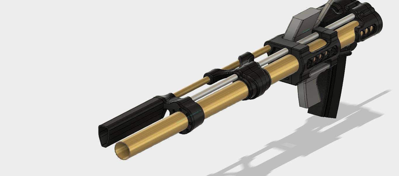

PopRocket123 Posted July 28, 2021 Posted July 28, 2021 My dad built this a couple of years ago. There's also someone else now making and selling their own design.

PopRocket123 Posted July 28, 2021 Posted July 28, 2021 2 minutes ago, Tackle said: I'd have one just for the Craic, but it'd have to be skirmishable, & there I think lies the problem, being able to set a consistent FPS that's not open to abuse? My dad used a compound bow for his so that the draw is the same each time. He's set it up to fire at basr power levels but you could change it to cqb friendly levels by swapping to a lower volume cylinder or adjusting the cams to reduce the draw. He did the maths and even this cheap kid's bow he used is capable of in excess of 9J so he volumed it to be safe for airsoft and used the excess cylinder volume to feed the air back to behind the grip to keep the length down. He also made a buffer system in the front of the cylinder to stop it from tearing itself apart.
LancsSkirmisher85 Posted July 29, 2021 Author Posted July 29, 2021 Thanks for all the replies so far guys, all good input! My design so far uses a standard airsoft coil spring for consistency and has a limited cylinder stroke which sets the max fps (at full draw) to an acceptable level so it could only be fired at safe velocities with the current cylinder fitted so hopefully that should limit abuse Any Thoughts on what might make it unsuitable for skirmish so I can keep that in mind? much appreciated!! 9 hours ago, PopRocket123 said: My dad used a compound bow for his so that the draw is the same each time. He's set it up to fire at basr power levels but you could change it to cqb friendly levels by swapping to a lower volume cylinder or adjusting the cams to reduce the draw. He did the maths and even this cheap kid's bow he used is capable of in excess of 9J so he volumed it to be safe for airsoft and used the excess cylinder volume to feed the air back to behind the grip to keep the length down. He also made a buffer system in the front of the cylinder to stop it from tearing itself apart. That's superb! I was toying with a side by side design but I want to keep it simple and as "normal bow looking" as possible. Huge qudos to your dad for that work tho, he could probably sell that design if he protected it first!!!

PopRocket123 Posted July 29, 2021 Posted July 29, 2021 1 hour ago, Rogerborg said: To the massive nascent market for niche toys in a niche hobby? He looked into it but it wasn't cost effective in the slightest. He'd have to sell the completed unit for at least £500 with all the hardware, printing and man hours that went into it. He was considering selling the files with the correct bits of tube or links to a supplier.

PopRocket123 Posted July 29, 2021 Posted July 29, 2021 2 hours ago, Rogerborg said: Hmm, now I'm fascinated to see how the air seal and feed mechanism would work. My dad used a cut down tappet plate with an AEG air nozzle and hop up. You have to manually rack the air nozzle to load a BB then pull back the string and release to fire. I came up with a tappetless system to use the excess cylinder volume to move the nozzle so you didn't have to do it manually but we haven't implemented that yet.
